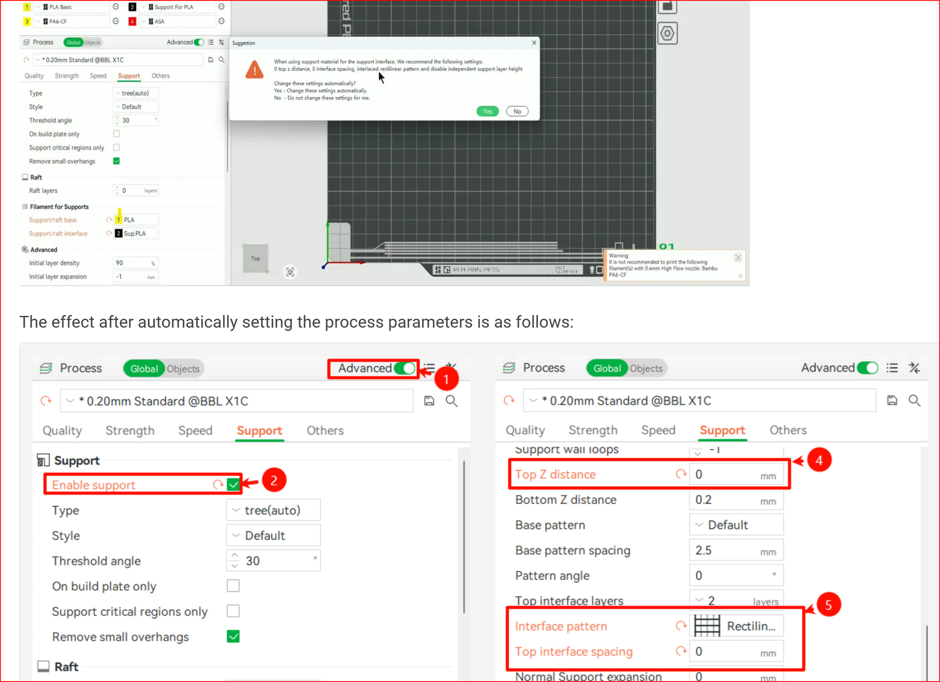

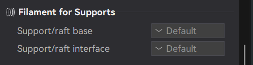

Did you try adding the spool in the support tab in studio ?

Second, you can absolutely define your own filaments in Bambu Studio and when you hit “sync”, it will show up as an available filament for you to select on the printer.

Thanks for following through with me. I quite new to 3d printing and my new machine with 2x AMS2 ,etc, presents a new world of learning. Using your clues I went into Wiki and it seems I can define the support as almost anything and select it.
I’m going to study this further and then bug you on selecting the colors I want. I haven’t yet found an easy way to force a specific color from my synched available options. It should be obvious but …
