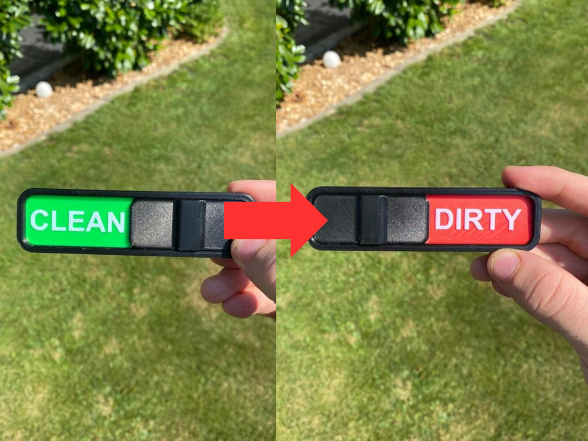

Many models in MW have either text I do not want or in multi color which I do not need. When I select the object(s) and apply filament change the text color persists despite what I set. In Objects tap , there is no text stl (See pic). All objects are seems to be changed to grey color i had set.
But when i slice the plate, the numbers appear to be black.
The model here in example is this one, just for you to check but issue is not specific to this model. Almost all model I come across have this issue.

The text is modeled in, so there isn’t an easy way to adjust what the text is, or remove it for that matter. You’d have to take it into a 3d authoring application, like Blender, to adjust that aspect.
This wont be true of all models, but how each designers handles it may be different. Generally speaking though, I wouldn’t bank on text being easily adjustable, unless the designer built it to be so.
the color changing is being handled through a layer color change, on that particular object. If you’re on the preview tab, you can select it and remove it. It’ll show on the right side of the window with the slider thing to preview the layers.

You can easily remove the text by adding a primate cube (in Bambu Studio) that covers the text.
First i needed to resync AMS. The deleted all but first. BS did not let me delete that. It was orange PETG but I want to print in grey HS PLA in A4. I changed the filament to HS PLA but could not dare to change the color. I do not remember which tone of grey I set it in AMS. When I sliced, it sliced in single color. I send it to print to check. In print dialog it let me choose A4. As it has already past midnight and print is estimated to last 2h.35m, i can try it tomorrow morning.

It worked.
