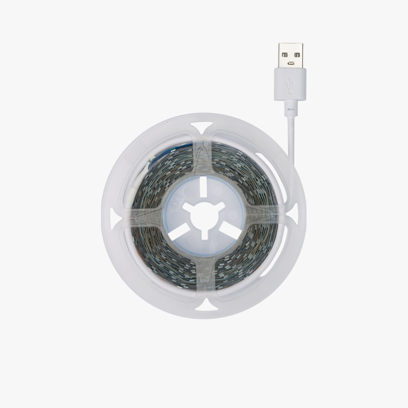

I bought the official “6500K White LED Light Strip” here:
But I don’t really understand how I can install it, there is no instruction.

You just stick it aroung your chamber and connect it to the USB plug on the back of the AP board. You’ll have to cut it to about 1.5 to 1.8m in length to keep current below 1.5A
Or you can use an external USB power supply.
There is nothing « official » about it, it just any led strip you can purchase on amazon. It does not switch on and off with the printer, it’s always on until you disconnect or switch printer off.
