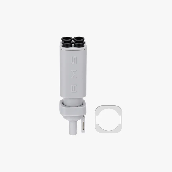

In the options of the printer, I can load a 5th “external” spool of filament and use it in the filament settings of BS, but I can’t figure out how that works physically. The AMS lite hub only has input connectors for 4 filaments.
How does it work to add the external one? I thought maybe there must be a “purchase separately” hub that has 5 inputs, but I don’t see that. I must be misunderstanding how this works, so explain how it’s used if I am.

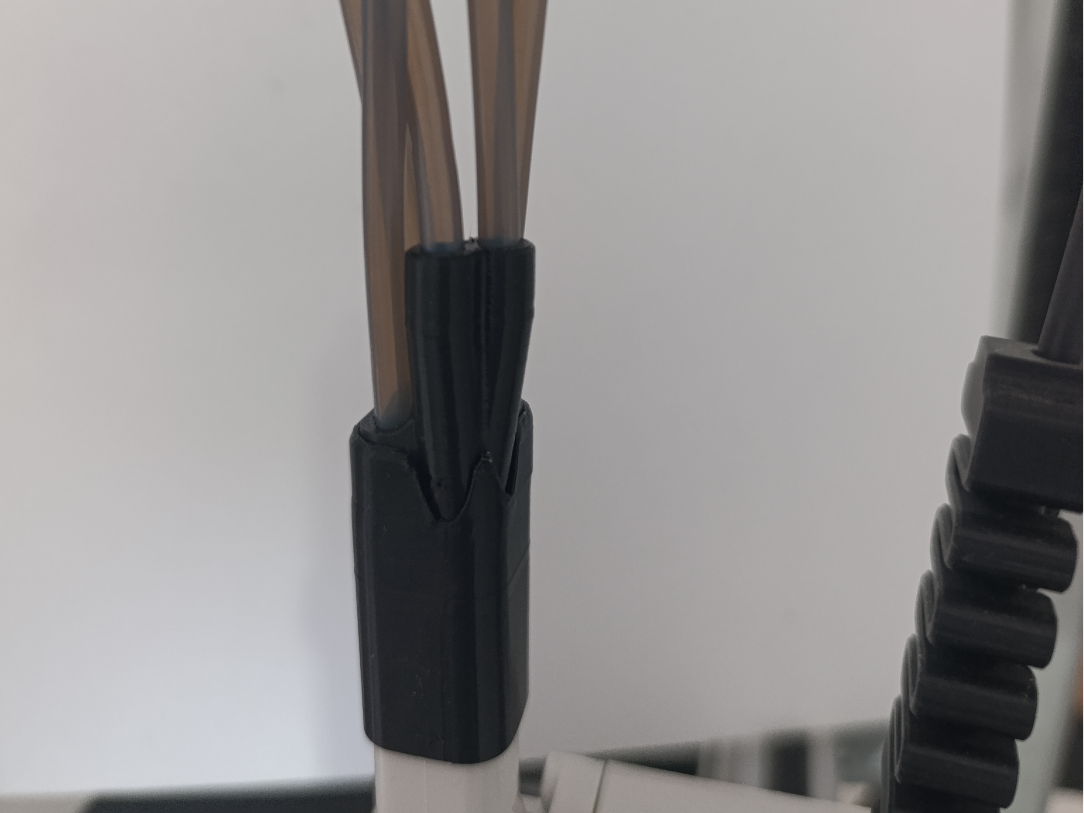

It’s an either/or situation, you can’t do 5 at once. Here’s a step by step for using a single spool:
I am with @PrinterMcgee.
You can print an adapter to give you 5 paths to your print head so you can leave the 4 AMS lite PTFE tubes in place while still having a separate one to allow you to use the external spool without removing one of more of the default ones.
This is one example of that solution.
