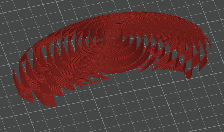

How to make a wire mesh of a curved surface?
I know that if you reduce both top and bottom shell layers to 0 in Bambu Studio, you can print only the sparse infill pattern, however, I’ve tried this technique mostly for flat layers. So, what do you do if it’s a round surface area such as in a sphere?
I want to make a bridge for my turtles, but it needs not to be solid, because it’d take a lot of material to print. I have a solid hollow semi-circular shape, but I don’t know how to make it a wire mesh. Can this operation be performed in Bambu Studio, and if so, how?

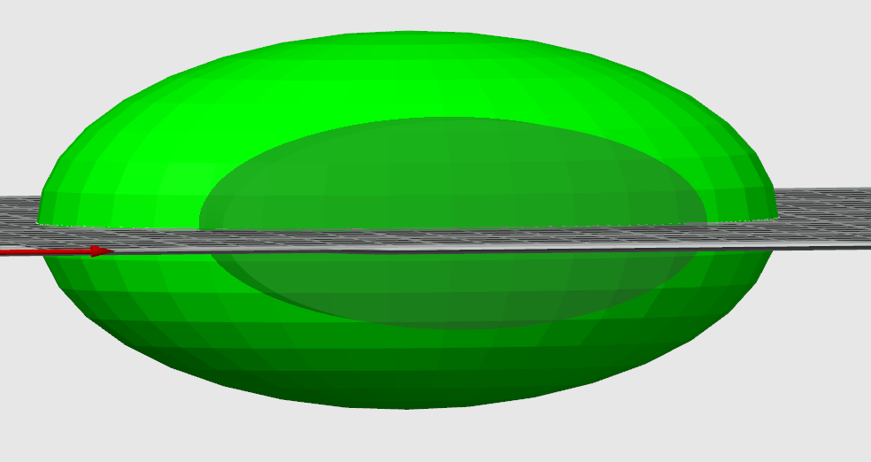

But working only in Studio, you can scale a sphere or cylinder, add a negative part, and lower both below the plate to cut them in half to create an arch.

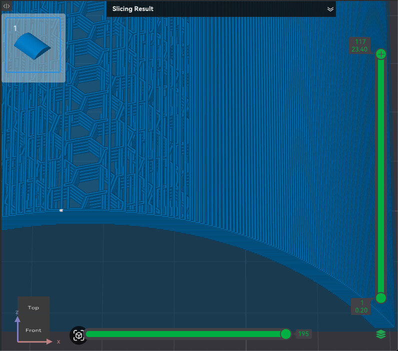

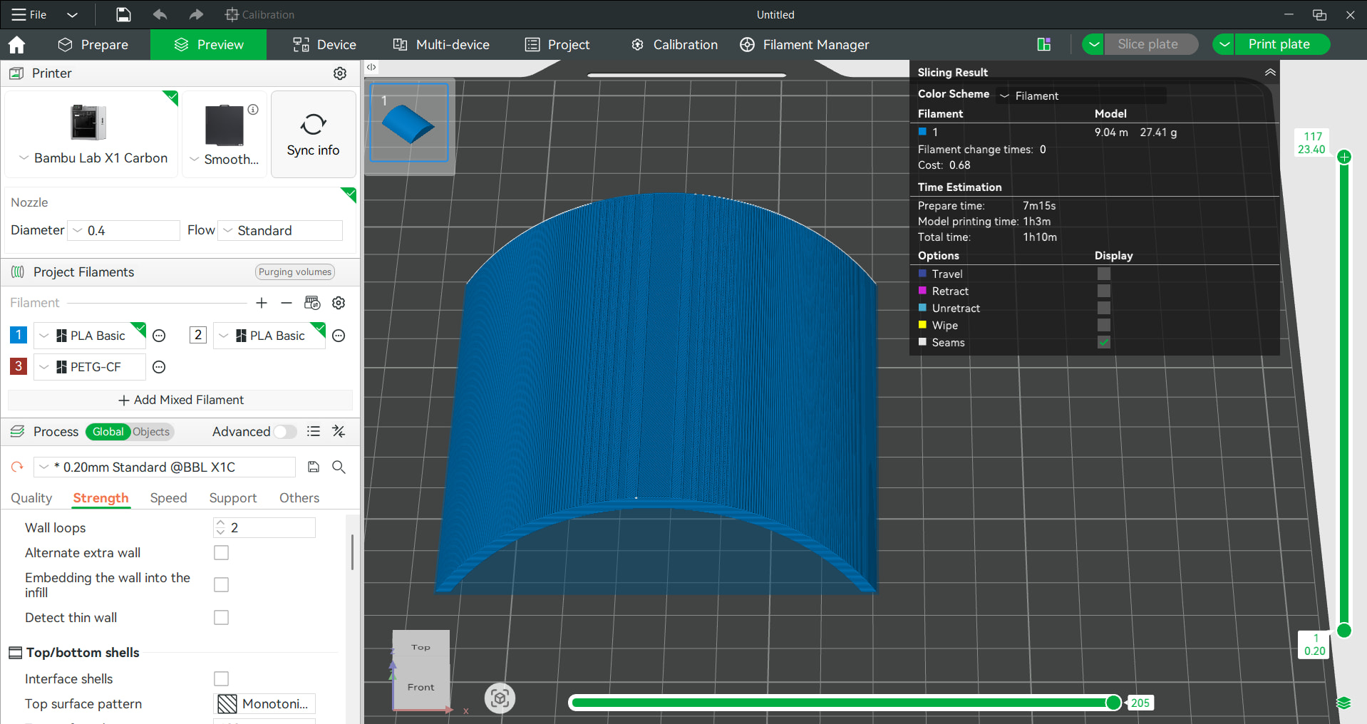

Something like this?
You’d indeed need a lot less material.
But you may want to kit out your turtles with some safety gear :joy:

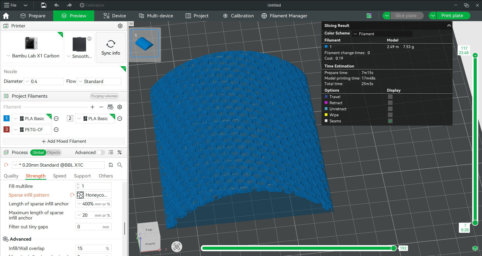

PS: I just set walls, top and bottom to 0 for the first pic.
Turtle Bridge Demo.3mf (49,5 KB)
I suppose it could be either one, though I’d keep the outer walls in the former.

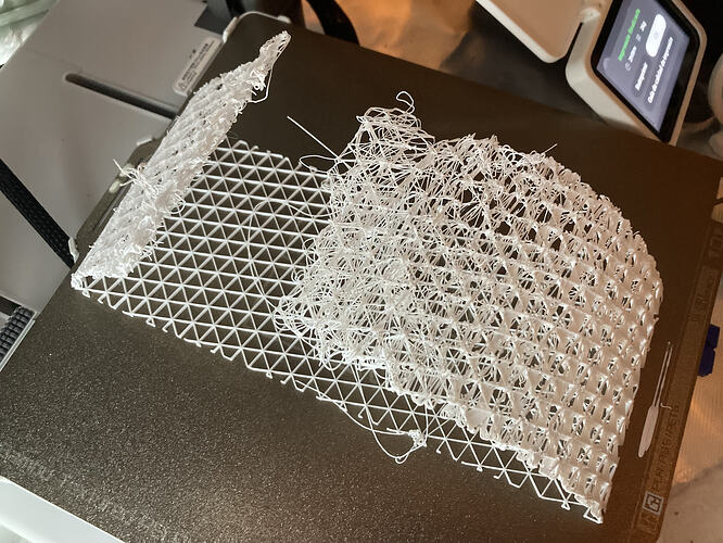

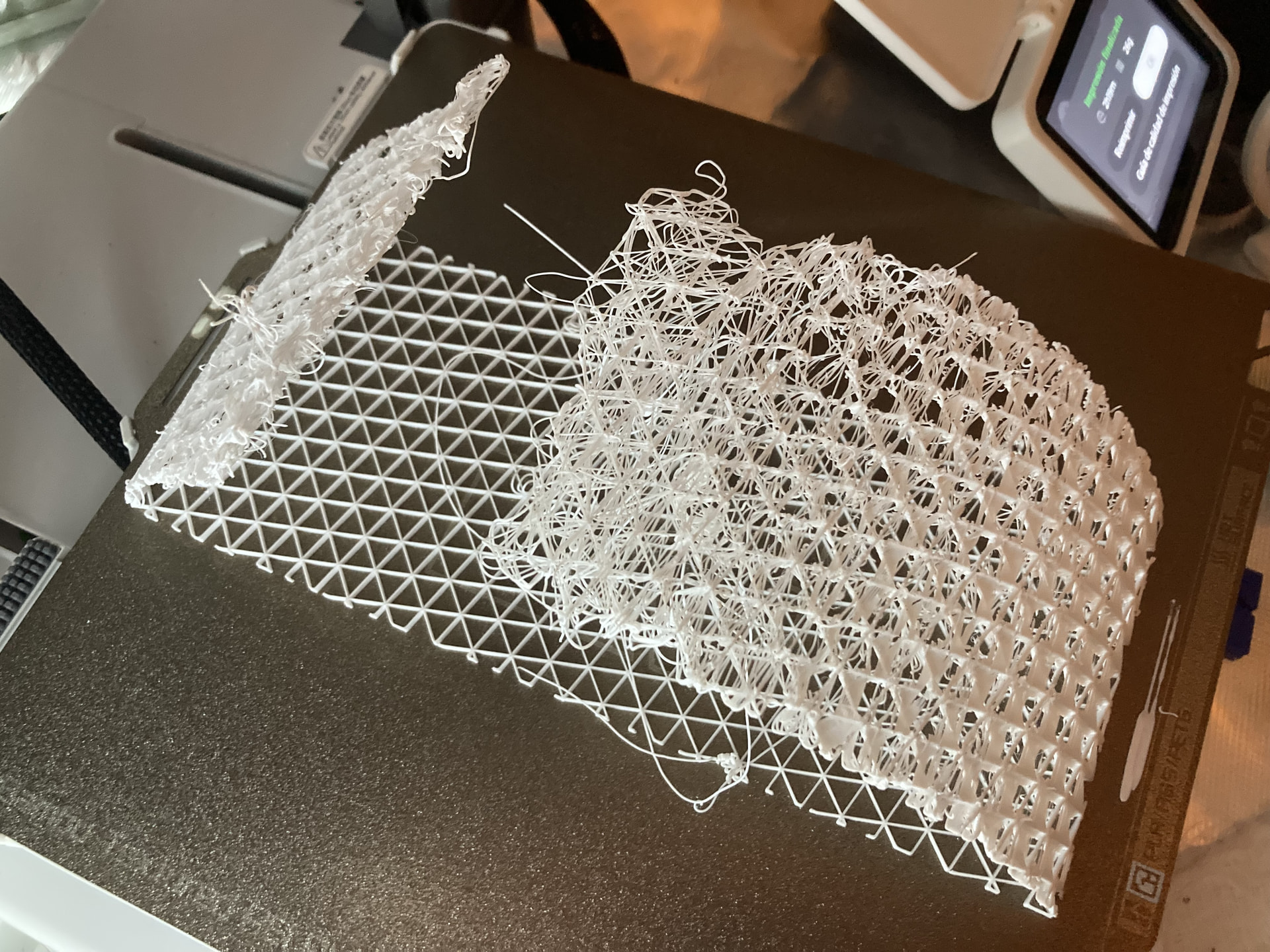

Yeah, you got it! This is what I’m talking about, it’s almost what I need, however, I don’t know how to avoid the lines that go transversally to the pattern. That’s why I only use this technique for flat surfaces.
Those are outer walls. They disappear with a wall count of 0.
You can place new edge walls using modifiers though.
It improves a lot… Some lines remain, is there a way to eliminate those completely? Probably not, so I should just try it out. Awesome tip, thank you!
