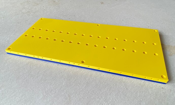

I have an issue with combining two 3D STL prints, overprinting the first with the second.
I have created two STLs which both work fine individually on their own, but I need to remove the first print from the printer to do some manual work on it before relocating it on the print bed and overprinting with the second one.
My first print creates a 4 mm thick layer on the bed which consists of the required print contained within a surrounding frame to achieve registration for subsequent printing. The first print requires some manual work done on it prior to printing the second print on top of it. So I need to start the second print at Z=4 however I don’t seem to be able to find the necessary setting to achieve this. Obviously I don’t want to kick off the second print at Z=0 and crash into the existing first print on the bed.

I have this afternoon thankfully achieved my objective
I used a frame to hold by model in place and provide later edge regitratoin then removed the model leaving the frame still attached to the bed. I was then able to make the manual changes to the partially printed model and subsequently replace it into the frame to continue printing.
I have to agree that it wasn’t 100% successful and rattled a bit during the second printing phase.
Although I got X Y & Z sufficiently I had not anticipated the warp factor which did affect Z and it also made the final ironing of the top layer rather ineffective.
Nevertheless I have a working model with hopefully not too much damage to the printer head.

Multilayer PCB assembly including embedded electronic components and 1 mm dia copper wires for ease of handling although 0.2 mm dia would have been sufficient. Better still 0.1 embedded in PLA filament would be great if available. Post assembly warp was the main issue.
