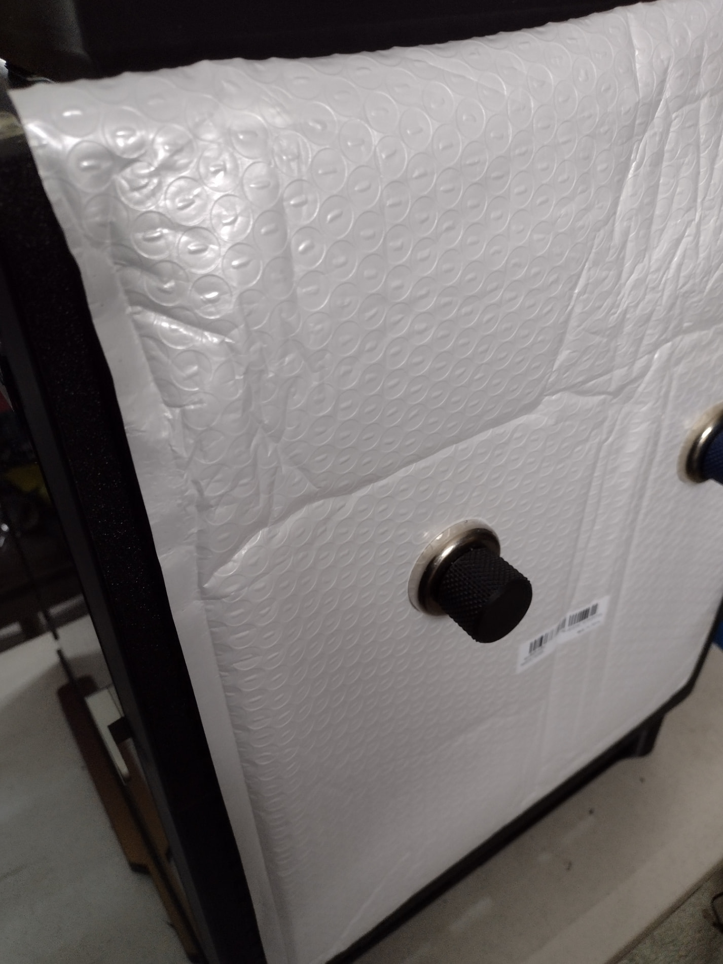

My first setup was simple: I used gaffer’s tape to attach cardboard panels to the printer frame, then added bubble-wrap envelopes from build plates as insulation. It was not pretty, but it worked. The goal is to reduce drafts and prevent rapid temperature swings, which are what usually cause ABS warping, lifting, and layer splitting.
Obviously, keep the cardboard, bubble wrap, and tape clear of the bed, hotend, belts, and moving parts.
Let the printer heat soak for about 30 minutes before starting the print. I used a thermometer with wired probes inside the enclosure so I could confirm the air temperature was actually reaching and holding the right range. Once you start the print, do not open the enclosure till it is finished printing. Let it cool down naturally, do not open until the internal temp has dropped at least 10 °C.
For me, the enclosure and heat soak made the difference between fighting ABS and printing it reliably on the P1P.
After I printed my enclosure panels, I taped rare earth magnets inside the enclosure. Those mated with exterior magnets and made the bubble-wrap panels easy to remove. Not pretty, but effective.
