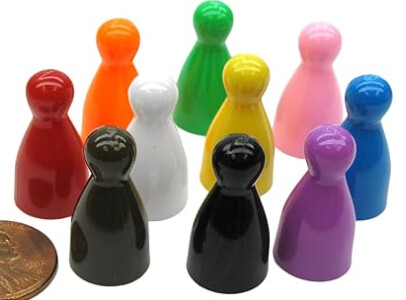

I am wondering how/if I can get a high gloss effect similar to the pawns in this pic. I’m trying to replace some game pieces that have a similar look.

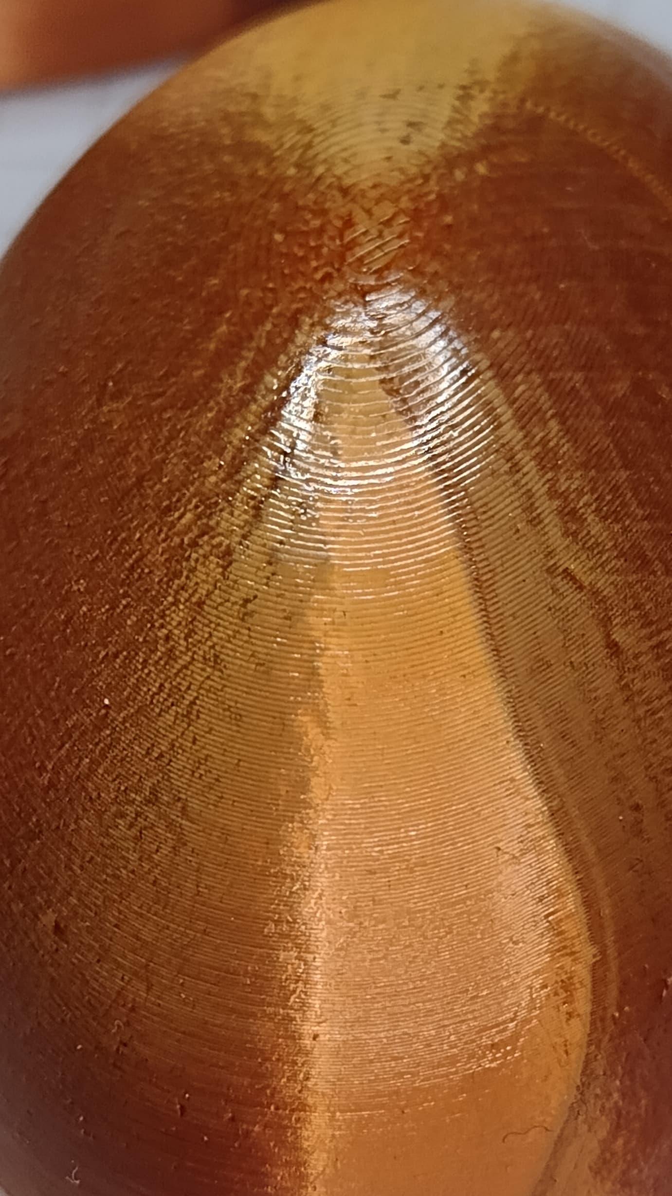

As mentioned above, some post-processing is required to achieve that molded plastic specular surface. However, I can share a shortcut, or “cheat,” if you will.

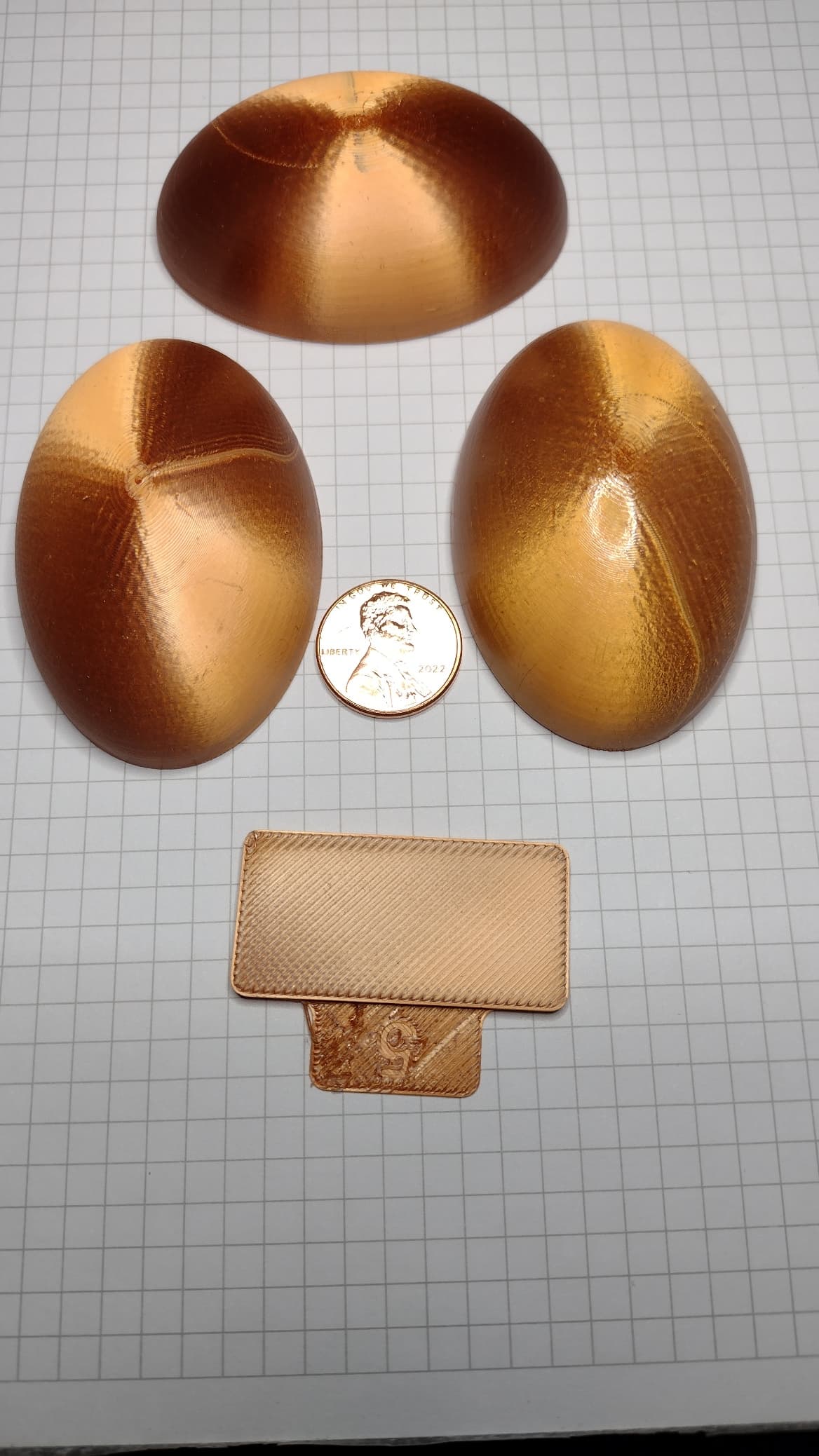

I’m currently working on two Steampunk-style control panel projects and began experimenting last week. The examples below show initial tests using a simple CAD-modeled sphere for higher resolution than the slicer allows. I elongated it to 40x60x26 mm. The filament is copper/bronze silk PLA, printed at 0.08 mm layer height with a 0.4 mm nozzle.

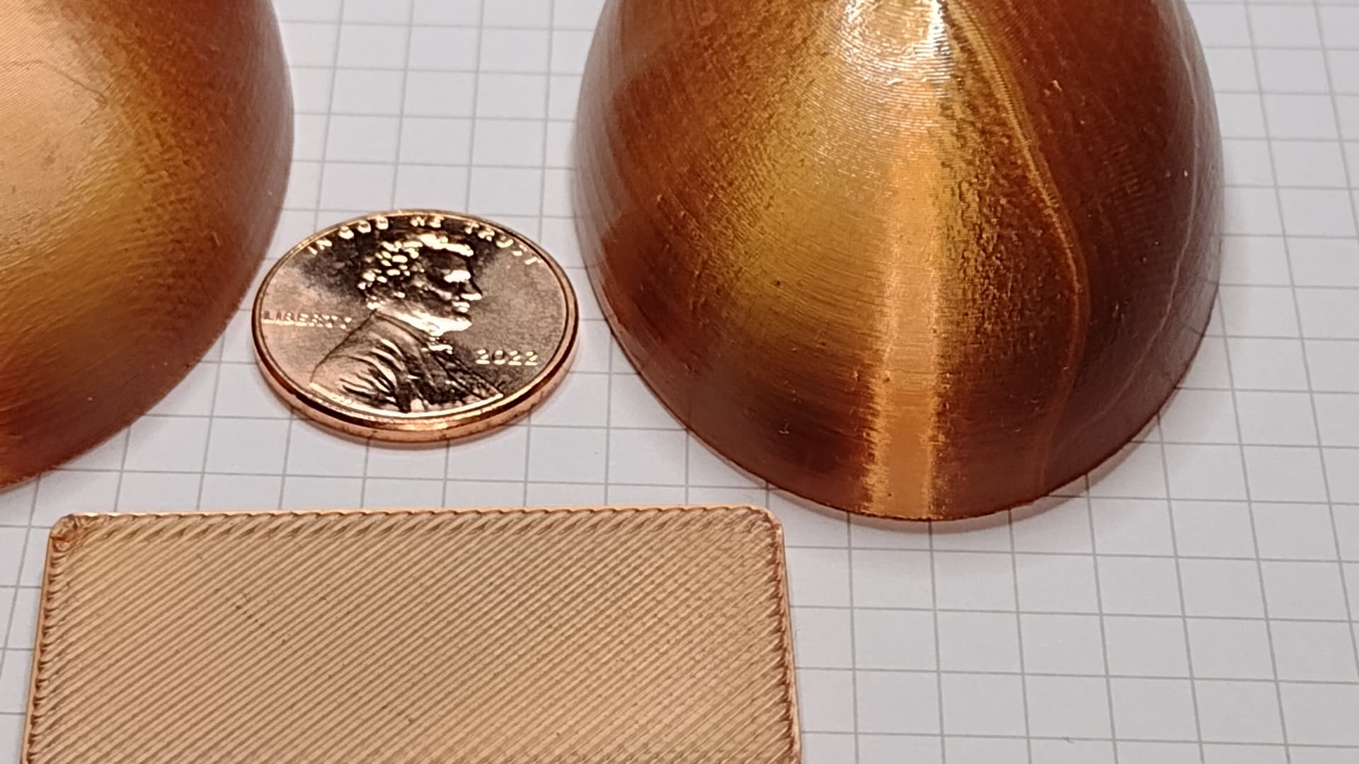

The back row sample is raw and untreated. The left sample was left unsanded and coated with satin polyurethane spray paint. The right sample was dry-sanded with 600 grit, then coated with a single layer of triple-thick polyurethane. The penny provides scale and a specularity/color reference. Click to zoom.
After light sanding, the right sample achieved a near-mirror finish. That wasn’t my intent, but it demonstrated how well the filament can polish. A finished piece could be further wet-sanded above 600 grit for a smoother result.
This example is what I mean but needing more sanding.

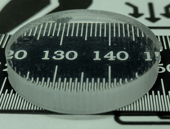

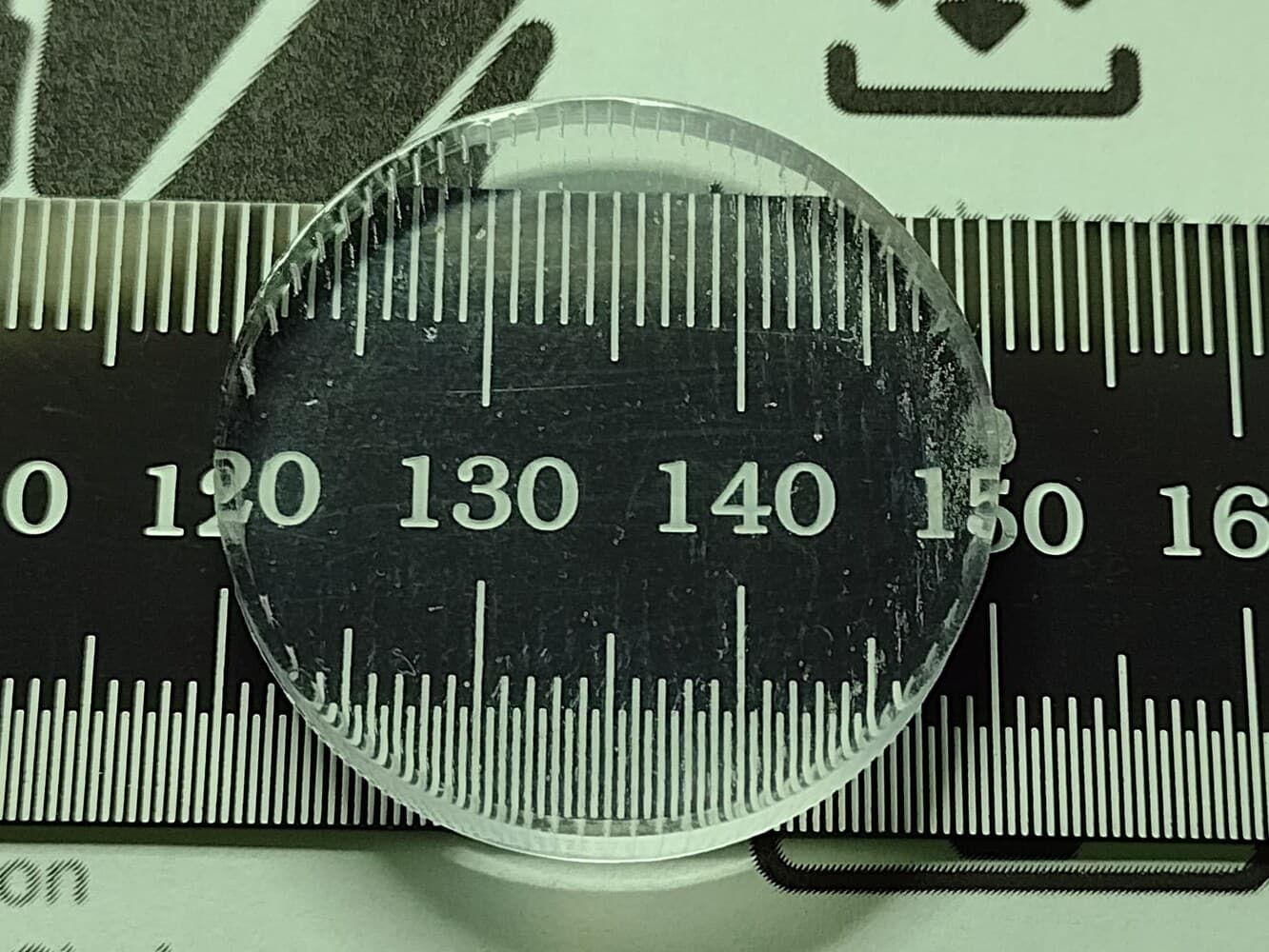

I could easily get the ridges to disappear if I used wet sanding and went to 1000 grit. I’ve employed this technique before with the optical clarity experiments that was part of a thread on printing ice posted here back in 2023. This test only proved that it is possible to get both optical clarity and near glass-like transparency with some modest post processing.

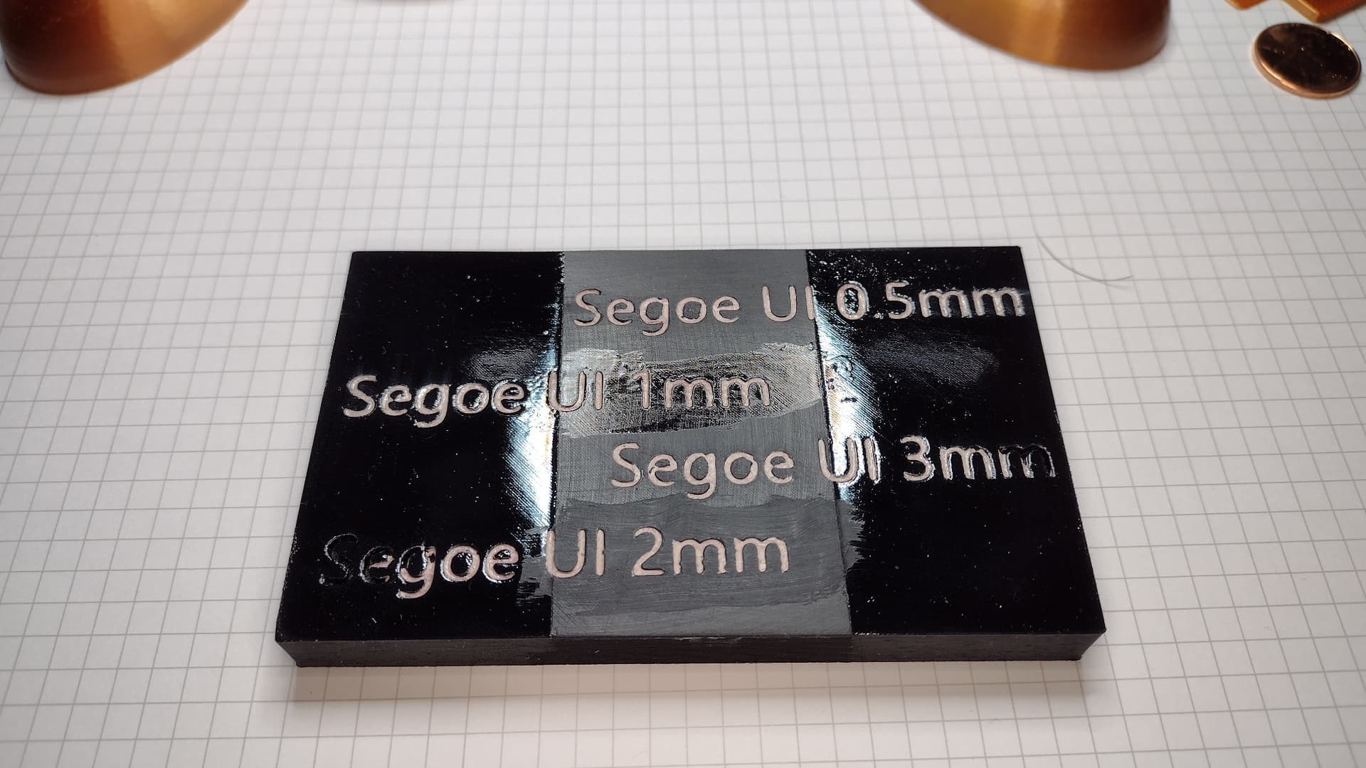

Next, here’s a quick and dirty embedded-text test using only the slicer to vary engraving depth. I also tried different clearcoat and polyurethane finishes.
From this, I found that 0.5 mm depth works best for backfilled lettering using a lacquer paint stick followed by gloss enamel. These are rough tests, the text isn’t fully filled, but I also used a 3M deburring wheel (a green Scotch-Brite pad would work too). The goal was to test whether ironing plus polyurethane backfill could yield a smooth finish. I personally prefer the thicker satin look, since I’m emulating anodized aluminum.
