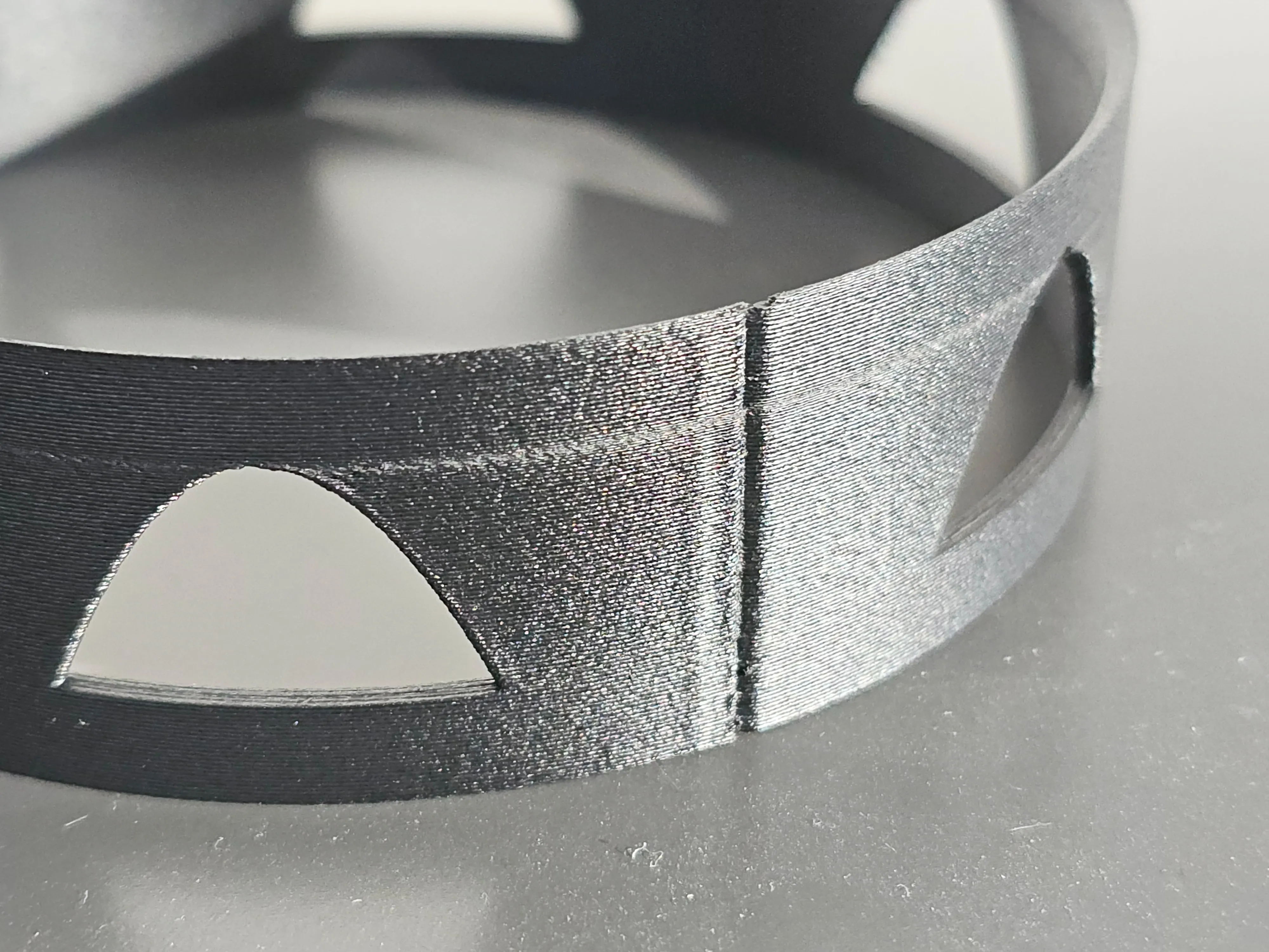

I don’t mean the bayonet lock. That is working perfectly fine and I don’t want to print this in place :slight_smile: - I meant the “dial ring”.
I designed the “dial ring” so that it can be broken open at a seam and then slipped over the hose connection:
This is what I would like to print-in-place and this is what this simplified model was supposed to represent.
