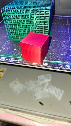

I have downloaded the 1L cube and I am exploring things I can do with this cool object. I want to pause the print at layer 349 which is the layer 69.8 to 70.3, in the 3MF that I have included. I will insert a solid cube to fill the space then resume the print over it. 1st problem is the slicer thinks its empty space and is complaining. I am thinking this has to fit very precisely or my next layer will not bond well to the object. how can I ensure this layer that is right over the top of the inserted object bonds well so the print can be well supported going up. there are a lot of tiny verticals that have to line up perfectly. I thought I if I could force the slicer to bridge across the whole span of the object but I dont know how to do that. The slicer wants to turn the corners of the little squares on top of the insert. I did try to single out that specific layer to make adjustments but I dont know what to do. As long as I have been printing I’m still a noob, LOL ! please help. Thanks.

If I’m understanding what you want to do correctly, you can’t do it the way you’re trying to do it. When you remove some of the structure with a modifier, the slicer assumes you’re doing whatever you need to do to make the void “work” correctly. It just resumes printing the object at the edges of the void as if the void wasn’t even there. If there’s no plastic there (or whatever you inserted, that the plastic doesn’t stick to) for the extrusion to stick to, the print will fail.
If you want a “box” embedded in the structure, you are going to have to model that in to the object. You can’t (well, I’m pretty sure) do it with a modifier.

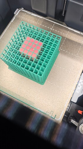

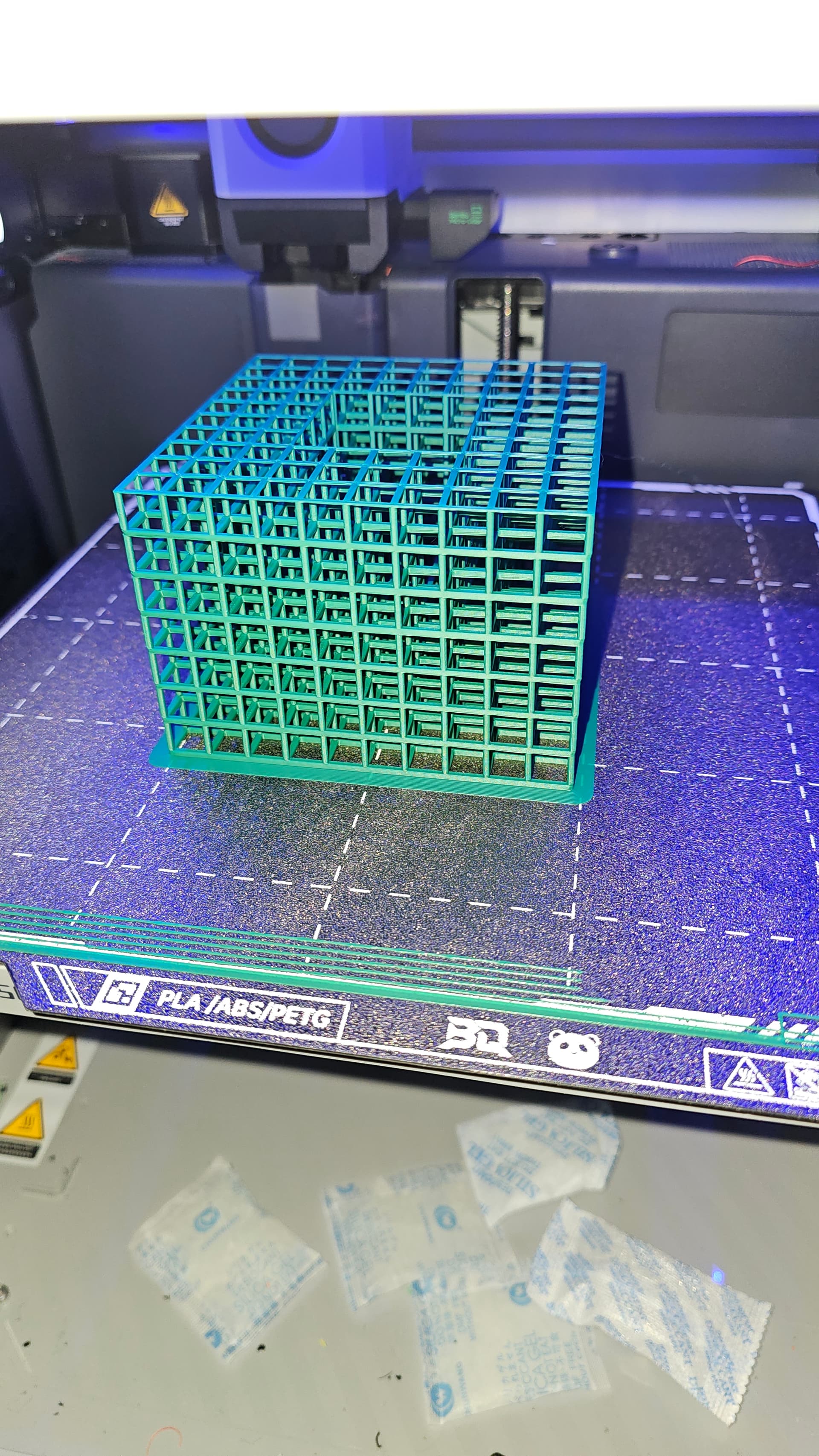

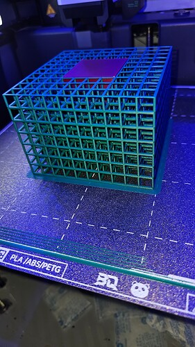

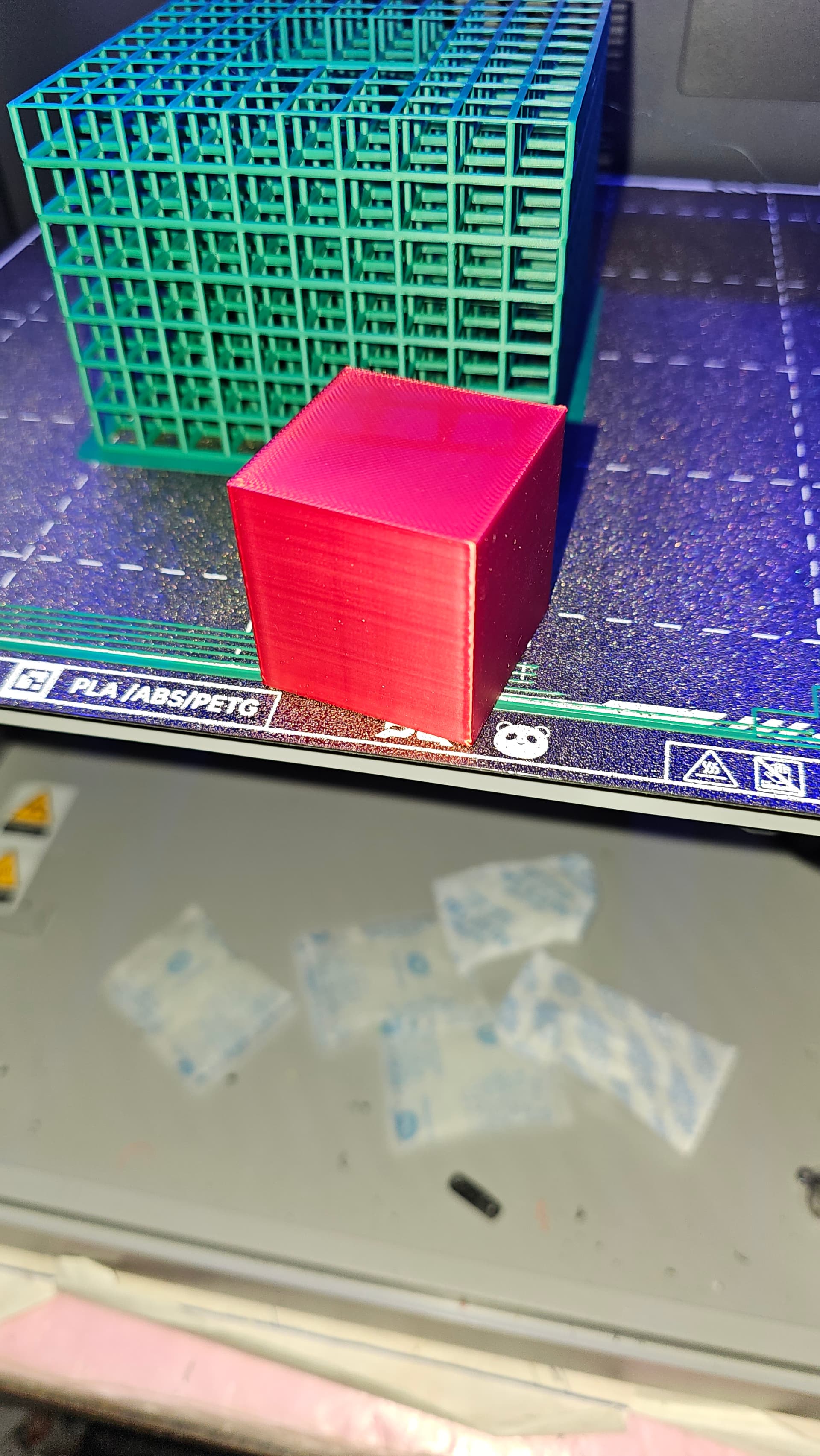

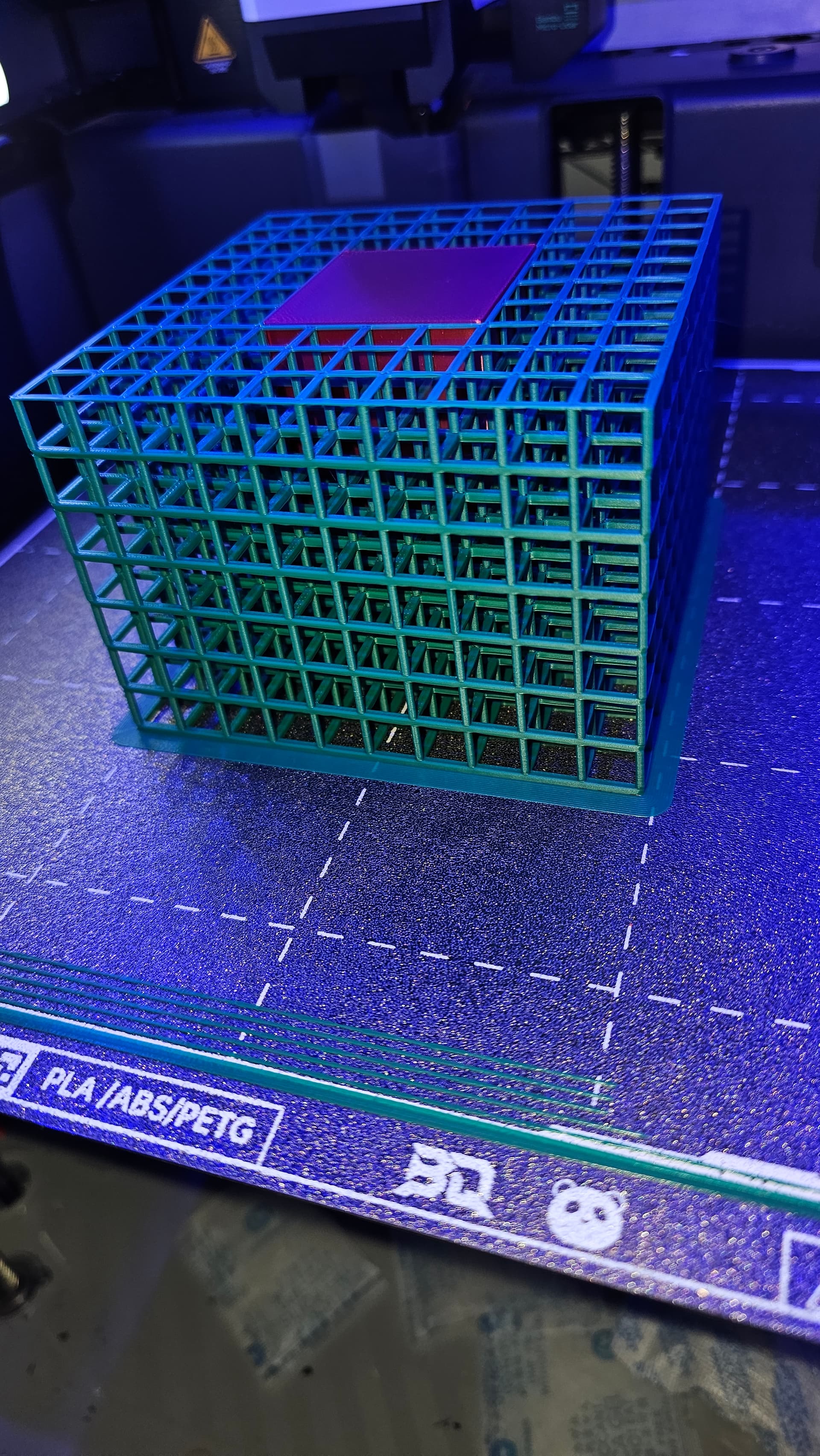

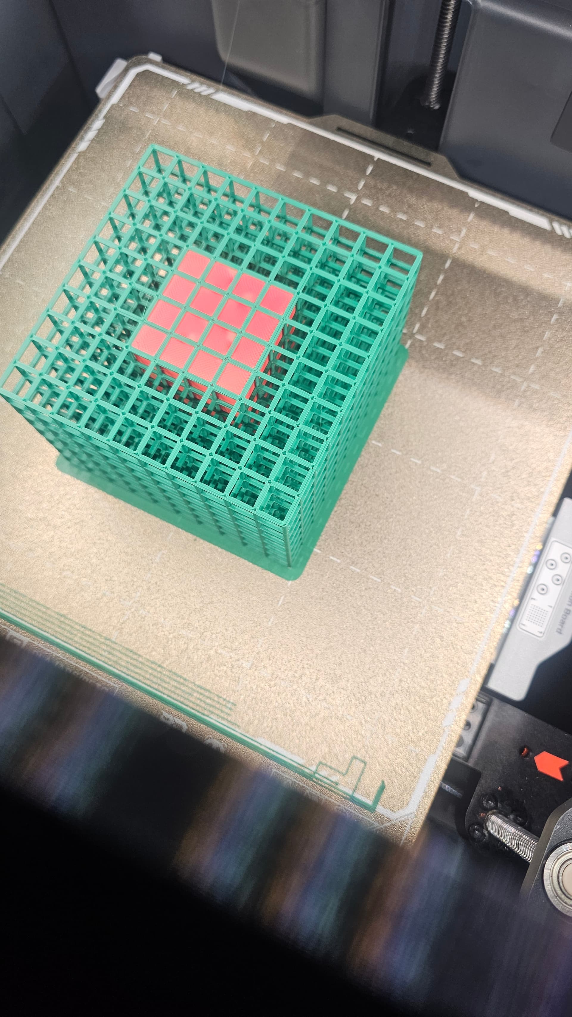

So, I loaded your .3mf. I generated a 39 mm x3 cube in studio and printed it. I then printed the file and only changed the filament to what I had on hand, BBL Mistletoe green. When the printer paused, I inserted the cube. Hit resume and off it went.
