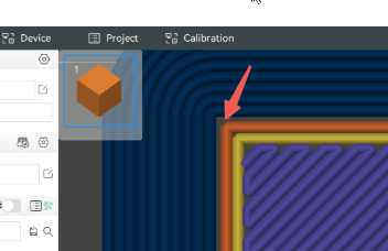

Elephants’ foot compensation (EFC) in Studio and OrcaSlicer intentionally shrinks the bottom layer perimeter slightly to create a precise wall.
By default, brims follow the original model outline with the innermost line spaced slightly outward (the brim-object “gap”). By shrinking the perimeter, EFC increases the Brim-object gap, weakening the brim attachment.

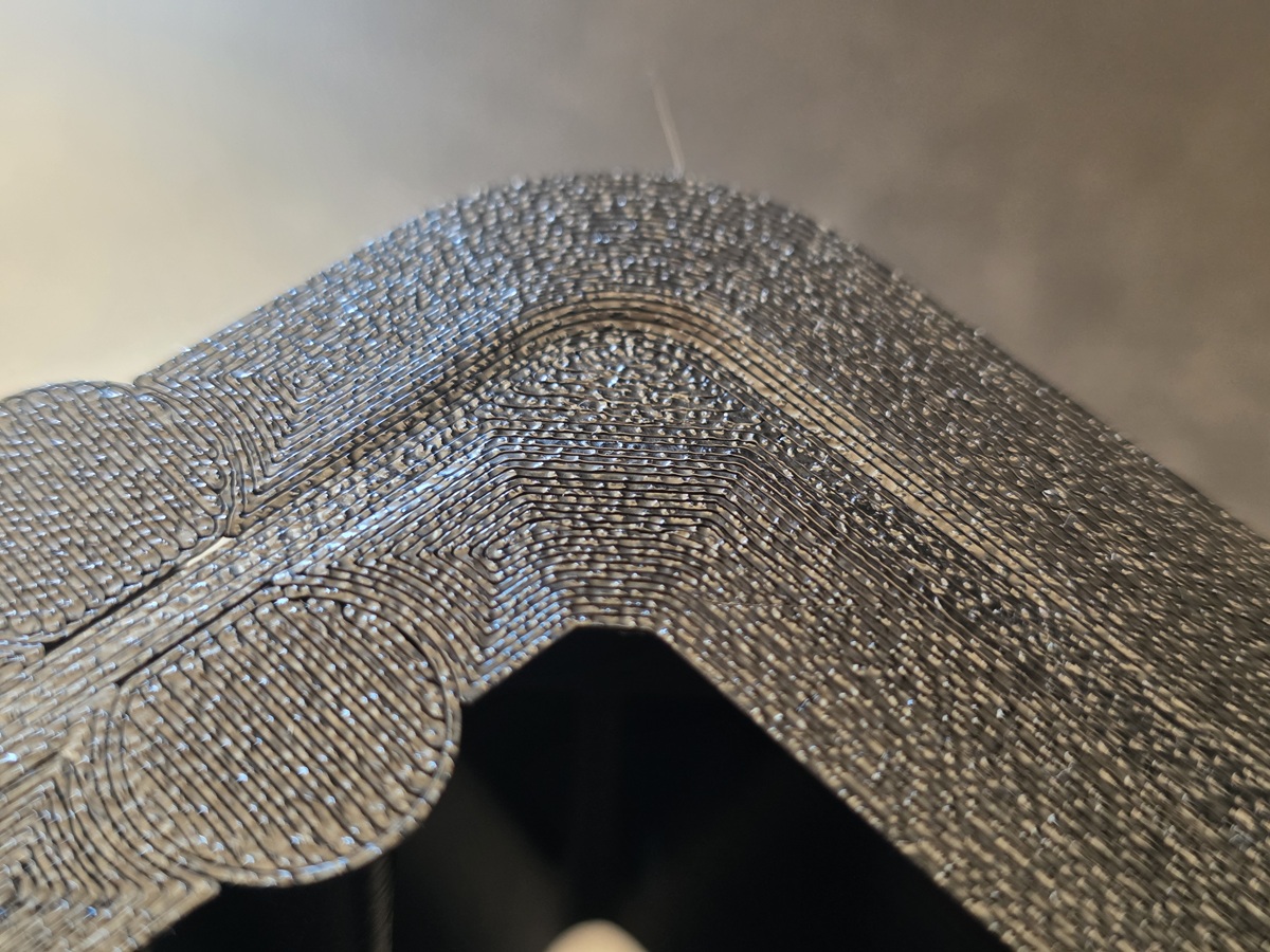

(This image shows an actual gap; it will usually just be an area of reduced “squish.”)
Bambu’s simplistic solution is to disable the elephant’s foot compensation. Of course, this prints a model with imprecise dimensions.
OrcaSlicer recognizes when elephant’s foot compensation is enabled and makes the brim follow the compensated perimeter rather than the original perimeter, maintaining the desired Brim-object gap.

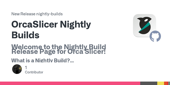

After typing all that ↑, I found that new EFC and brim features are coming to Orca soon, and better explanations and illustrations are in the Orca wiki. Check out these links:
https://github.com/OrcaSlicer/OrcaSlicer/wiki/quality_settings_precision#elephant-foot-compensation
https://github.com/OrcaSlicer/OrcaSlicer/wiki/others_settings_brim#brim-use-efc-outline
Beta versions with the new versions are available here:
