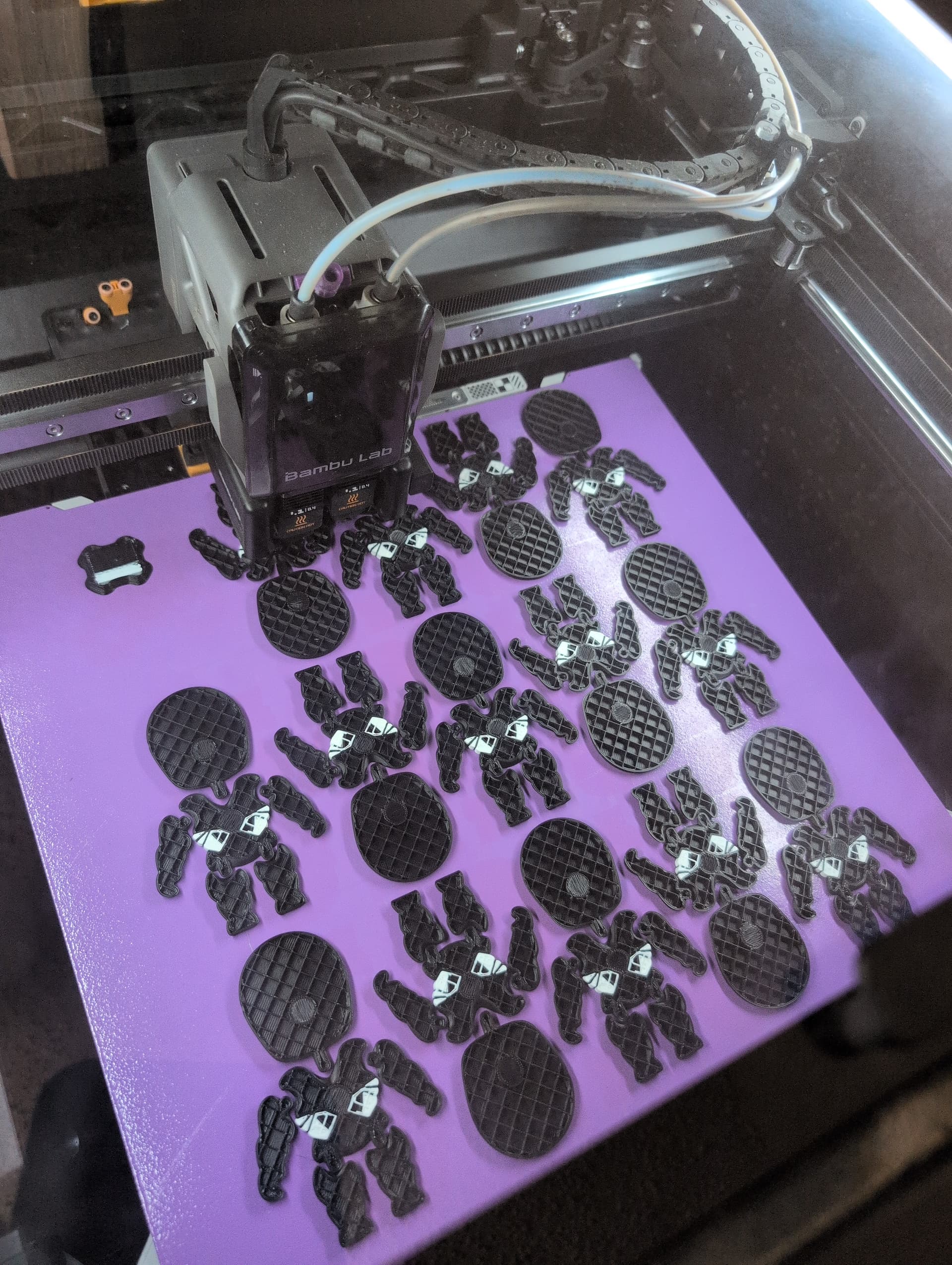

im running some ironman magnets containing 3 colors and keep running into nozzle temperature alarms on the left nozzle when changing from silk to matte, but i do not get the alarm every change, however it only happens when going from silk to matte but not matte to silk. I am wanting to turn in my logs but the only way i know how is to submit a ticket, so do i submit a ticket even tho its working?
bambu basic pla red on right nozzle, bambu matte ice blue and ujbio silk metal series on the left nozzle.

I did replace both nozzles, cleaned the blocks and thermistor contact patches with a brass wire brush and recalibrated after that run, just to make sure it wasn’t a bad seat from debris or anything. Running 2 color pla Venom mini magnets right now like a champ :trophy:

Well, I’m back after some tinkering, been putting off making a report till I could extinguish other symptoms on my end. The problem kept reoccurring more and more, and being less and less about matte to silk. I’ve narrowed it down to the 4 wires on the bottom of the heat end assembly behind the nozzle tip (thermistor wires and heater wires) having a weak connection. I don’t know if they are weak from 5k hours of use, or weak from possibly going across the rubber wiper, or from aggressive cleaning from myself, but they have either a bad solder joint or the wires are brittle and weak. I was able to bend them a little (carefully) and established a better connection. I will submit a ticket after this test run of storm trooper magnet minis, and already ordered a couple replacements for each side as I don’t think this is a warranty item at 5k hours…
