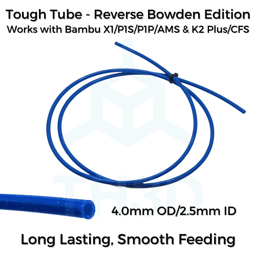

Depending on your location, you may be able to get these. They are more durable than Bambu Lab’s originals while maintaining the same size. I can’t say for certain if they are superior overall, but I have successfully fed TPU 90A through mine without any issues.
