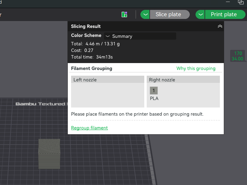

In studio, just change the printer from here, which allows slicing for any model printer listed,
currently a H2c
