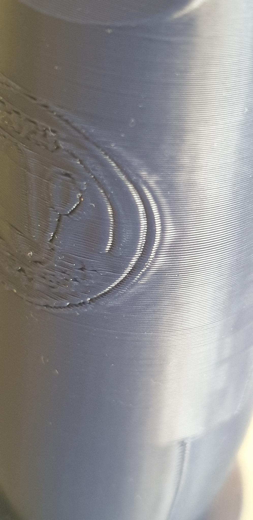

    I am printing mouthpieces and other parts for musical instruments. With the same filament and settings as before the prints show overshoot in the horizontal direction. When I print a logo in het parts it shows some kind of echo as if the printer head vibrates after moving in a steep angel.
  • Printer model used
    The P1S.
  • Slicer settings used
    I use standard settings but decreased the speed of the outer layer. However I think that I should not do that. A week ago there was no problem with the same settings and filament. So I think there is some kind of mechanical problem or unexpected change in the settings or software.
  • Type of filament used
    Esun PLA

Your 1st photo looks like something called RINGING.
You should check the XY belt tension, and redo your input shaping calibration.
thanks for your reaction.
I checked the belt tension and performed this: Belt tensioning procedure | Bambu Lab Wiki
and then started the calibration. But the effect is still there.
Several things were done to solve the problem.
  • cleaning the nozzle
  • replacing the nozzel
  • checking the belt tension
  • general maintenance
  • calibration
    It did not really make a difference.
    I contacted the technical support
    They helped me with a better set of parameters.
    Especially setting the resolution to 0.003mm is an improvement.
