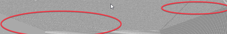

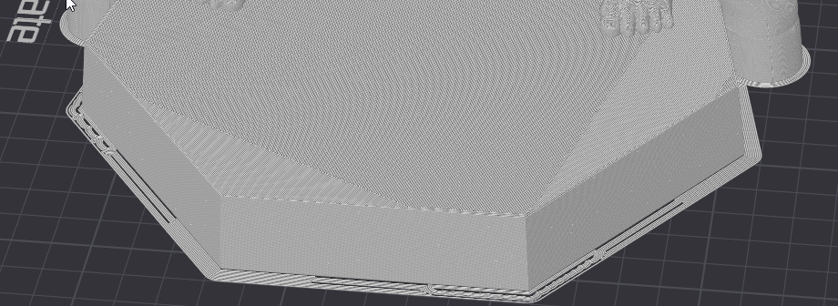

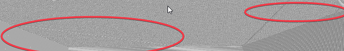

I don’t know how to call this issue I am having when slicing this file.
The base gets a “step” layer on the base. What setting can I change on Bambu Studio to make the surface smooth?

Looks like to me it’s not 100% flat on the bottom
Things you can try
Drop the model into the bed say .5 by moving it down in the Z direction
Right click on model and if using windows os and click " Fix Model "
Cut the model bottom off some
Keep us updated ![]()

I clicked on the Fix Model option but the base still with the same issue on the top layer.
O sorry I did not see that the first time lol

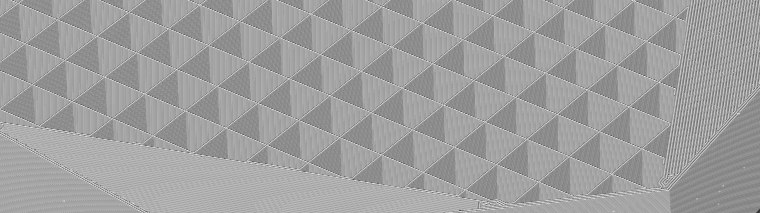

What happens when you change the top surface pattern ?
Unless this model slops off in the design ?

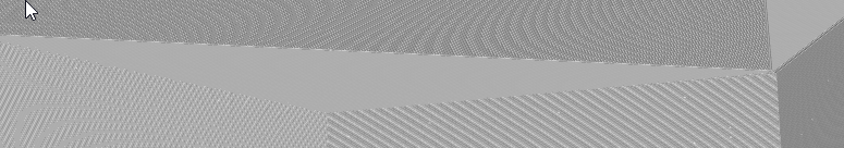

If you move the layer sliders what do you see ?

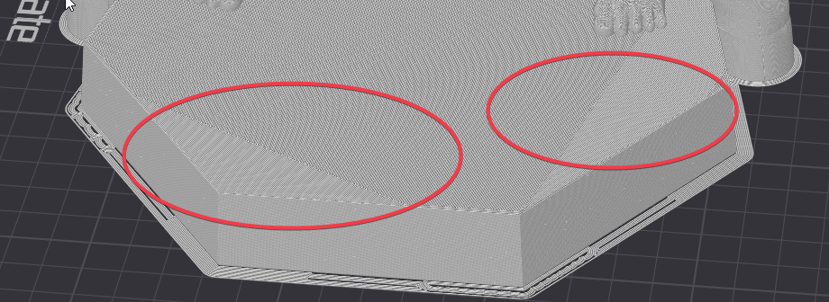

Is that part of the model lower than the center main section ?
Yes, it looks like the layers are lower than the center.
The thing is that on the preview screen, it’s flat. The 3D model has a flat surface.
Do you have a link to the model ?
What is the layer height set to .16 what happens at say .2 or more ?
Do you have another slicer to test this model on to see what happens ?
layer height is 0.2

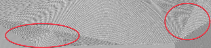

I am playing around the model scale and I was able to reduce the layer issue to a small area. I will keep changing the values until it goes away completely.
You could cut the bottom off and make your own base plate.
I was able to fix this issue by rotating the model a few degrees.
Thank you!
Your top surface was not parallel with the print bed. This is what was causing the anomaly for future reference.
