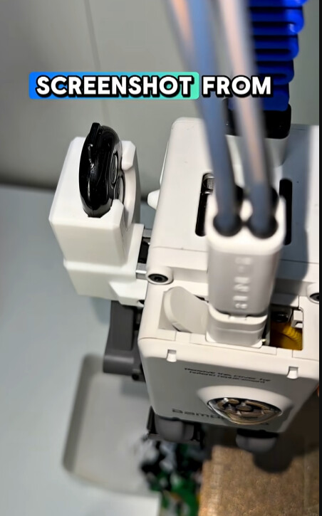

Hi! I’ve got my Bambu lab A1 for a month now, and I wanted to make some layer by layer time lapses with my smartphone (Xiaomi T13) and a bluetooth remote controller (Selfie Stick Phone Tripod, Extendable, Foldable, Flexible, with Wireless Remote Control, Rotating Base, Battery Powered, Portable, Lightweight, Tripod with (Pink) : Amazon.es: Electronics), but whenever the printer presses the button (printed some parts to hold the remote controller in the printer), the phone camera switches to video because it presses for too long I guess.
How can I do good time lapses with my phone? Should I buy a new/better remote controller and which one? What could be the issue? What’s the right way to do good time lapses with mobile phone?

Thanks for the reply. I’ll add the information:
  1. The part of the machine that presses the button looks like this: https://www.youtube.com/shorts/t1Y0muT4QQ4
  1. I just switch on the time-lapse function on the slicer, so the nozzle for each layer goes to the left place where the remote controller is (see the image).
  2. I didn’t change any G-code, but I tried to change the TimeLapse G-Code in Bambu Studio. I changed the line M400 P300 to M400 P200, M400 P100 and M400 P50. However, none of these changes had any effect on the time lapse (300, 200, 100 and 50 all caused problems with the video).
A quick search of Makerworld brings up instructions for the correct Gcode edits you need to make. Basically you need to drastically shorten the contact time and then move the head way from the button.
:receipt: Timelapse G-code Setup
To make this work, you’ll need to slightly modify the timelapse G-code section in your print profile.
IMPORTANT: if your print quality drop, please enable smooth timelapse, this will enable a purge tower.
Replace:
M400 P300
With:
M400 P10
G1 X10
M400 P300
:mag: This sequence does the following:
  • M400 P10: short 0.1s pause at the current position (X = 0)
  • G1 X10: moves the printhead away from the camera view
  • M400 P300: 3-second pause so your phone has time to take a picture
:bulb: If the printhead is still visible in your frame, feel free to adjust the G1 X… value.
Thank you so much! I will try that!
Thanks for the additional details. What @JonRaymond posted was new to me, but it closely mirrors what I did on my P1P about three years ago.
In my setup, I printed a small fixture that incorporated a limit switch, which I hard-wired to the remote shutter actuator similar to what you show in your photo. I then modified the G-code so that, at each layer change, the toolhead moved to a fixed location where it reliably triggered the switch. Functionally, it was just a repeatable move command tied to layer transitions.
