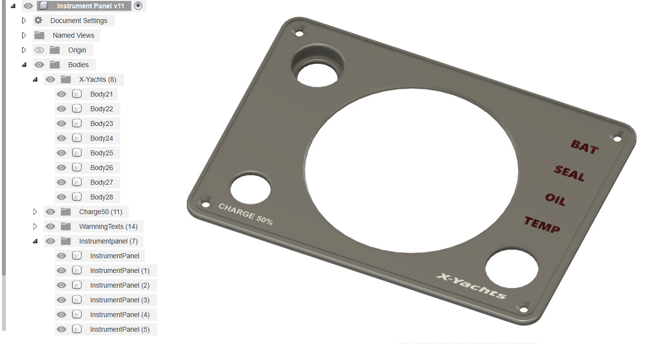

I have designed this three color instrument panel in Fusion 360.
How do I get it into Bambu studio and assign the various bodies to the colors/filaments they belong?
I tried exporting separate STL’s for each color from Fusion and importing to Studio. But then the bodies did not end up aligned but instead in different places on the plate.
Thanks!
There are probably many ways of doing it but you could start with an export to a .3mf file with all the bodies selected. Create a new Bambu Studio project and do an [add] of that 3mf file to a plate. When it asks “Load these files as a single object with multiple parts?”, click “YES”. All your bodies should be listed on the plate and you should be able to assign them colors. If you don’t want so many bodies then you can combine them before exporting them from Fusion 360.
What I do is one stl export per colour -from F360 - (by hiding other colours). With the colour in the name of the stl.
I then add all of the stl’s to BS together so that there is then one object per colour and then just assign the colours to each object.

BS does support colours from OBJ files.
I’ve never really tried them with F360 - but just did a quick test
This test model in F360
File export as obj.
Added into BS - it came up with this screen
And seems to be coloured correctly in BS
@Ukdavewood, perfect, thanks, exactly what I was looking for!
worked like a charm!
Saves a lot of work when there are many small individual bodies of different colors.
I export all of my files from f360 to Bambu as obj and high quality selected. All the colors come through and the object quality is way better than STL or step. I just hit print and it automatically loads the file into slicer. I can then choose the colors that are already in the printer.
