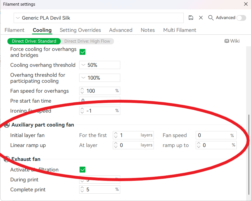

Hello,
Is there any way to disable the printer’s right-side fan (Adaptive Airflow Switching Unit)? I discovered that when it is enabled, Bambu Basic filament and Silk filaments print poorly on the top layer during slower and denser line printing (Top layer (wavy filament))
I modified the G-code by removing the entries related to this fan (;M106 P2 S255, ;M106 P2 S102, ;M106 P2 S127). I also set the fan speed to 0% in the filament settings (see attached screenshot), but despite this, the fan still turns on and I have to walk over to the printer and disable it manually.
Is there any way to solve this problem and fully disable this fan through the printer or filament settings?
