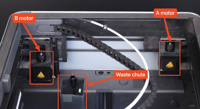

Huge noise from XY movement caused by motor-A
I had huge layer shift in one of my last prints. Since then the motor-A is causing huge noise when XY movement is done. No issues with motor-B. I could not realize anything wrong with movement or belt so i think it’s not mechanical issue.
The issue starts after 1-2min when stepper motor is getting warm. I am usu if the problem is the motor itself or the motor driver. Any idea how to check this? In Wiki i could not find any answer on this.

But i think i have found the issue.
I changed the cable from motor-a with motor-b on the PCB but the problem remains on motor-a which means the PCB is faulty and not the motor. I will order PCB now.
