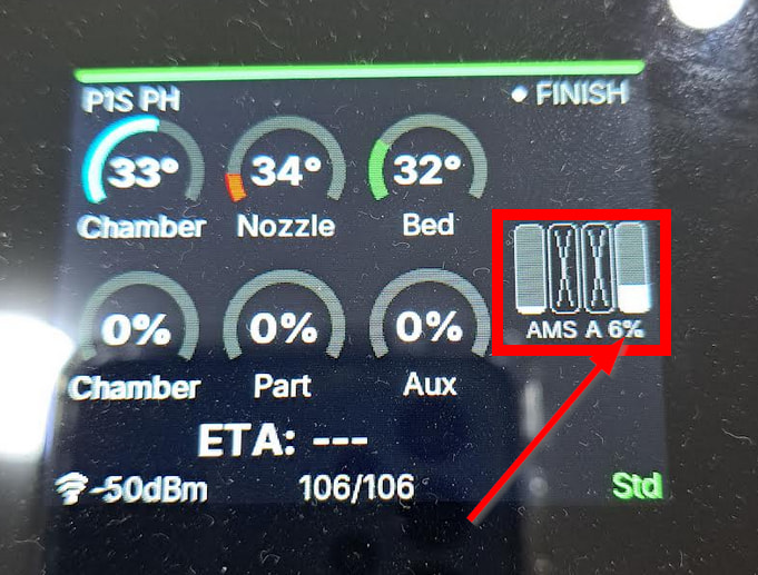

I think it is in Bambu Studio, because on my [BambuHelper]( Simple Print Monitor - ST7789 1.54" display case - Free 3D Print Model - MakerWorld ) I get the AMS 1 (no heater) humidity in %. It gets the information the same way (I guess) than BambuLab Studio through MQTT.
Screenshot is from my forked version of the BambuHelper. The official one doesn’t show AMS humidity.
