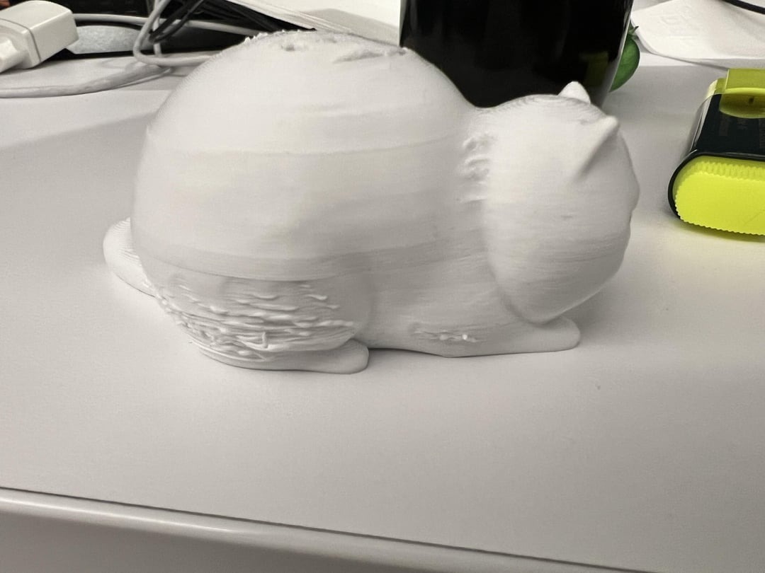

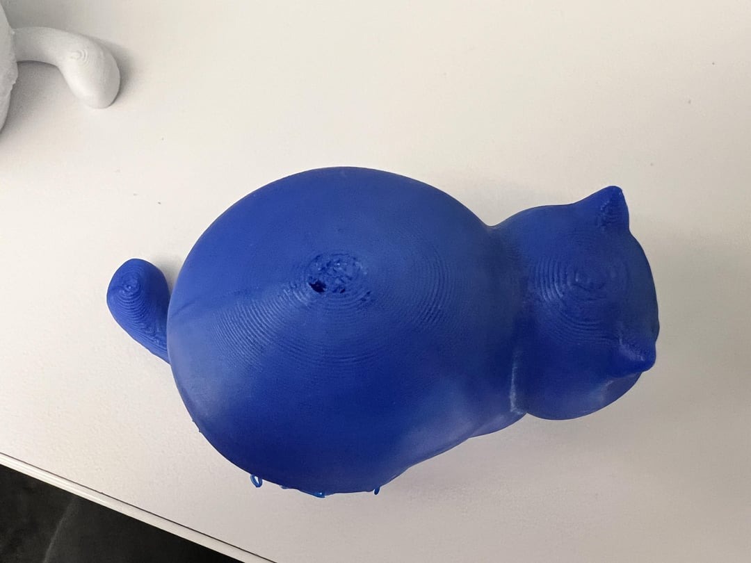

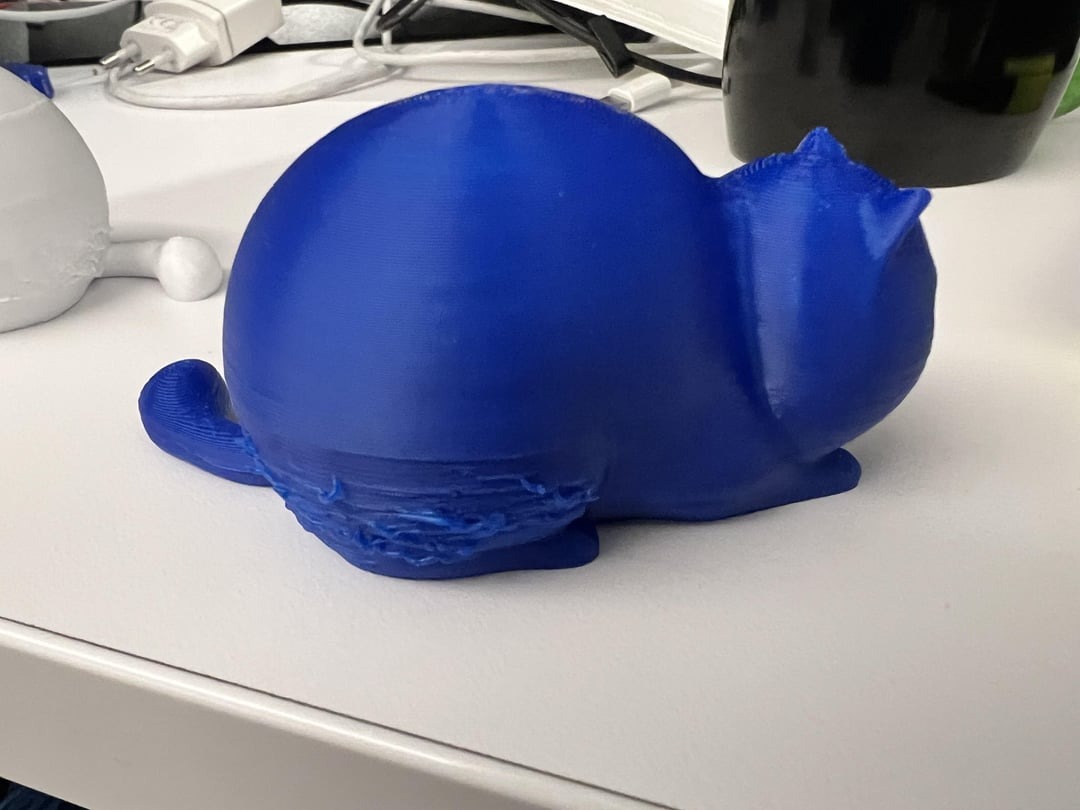

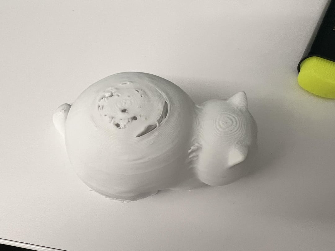

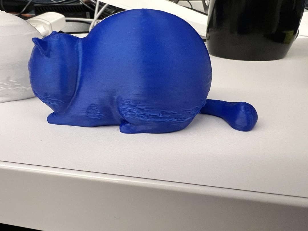

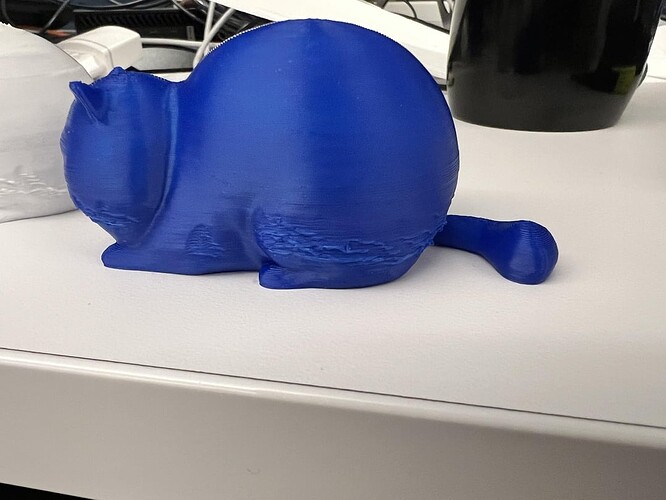

I am at my wit's end. what is the issue here?
so i am having a problem since almost the beginning. i tried everything, i tried flow calibration, i tried different brand filaments (these are different as well) and last i thought it was just a support issue so i manually forced support but still. i dont know wtf is going on.
model is Angry Little Fat Cat by mail.iouMakerWorld: Download Free 3D Models
i am using bambu studio 2.0.3.54
a1 fw is 01.04.00.00(latest)
ams lite fw: 00.00.07.94 (latest as well)

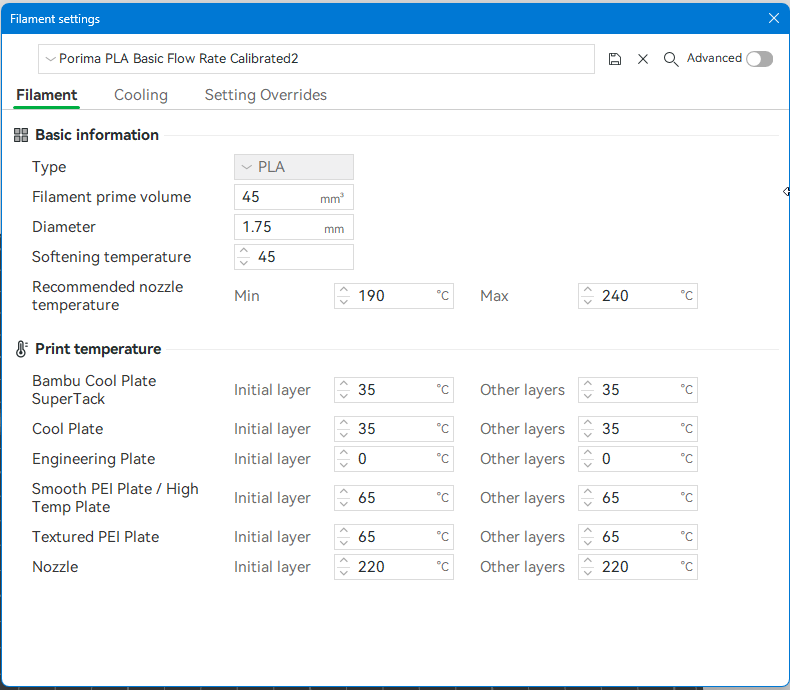

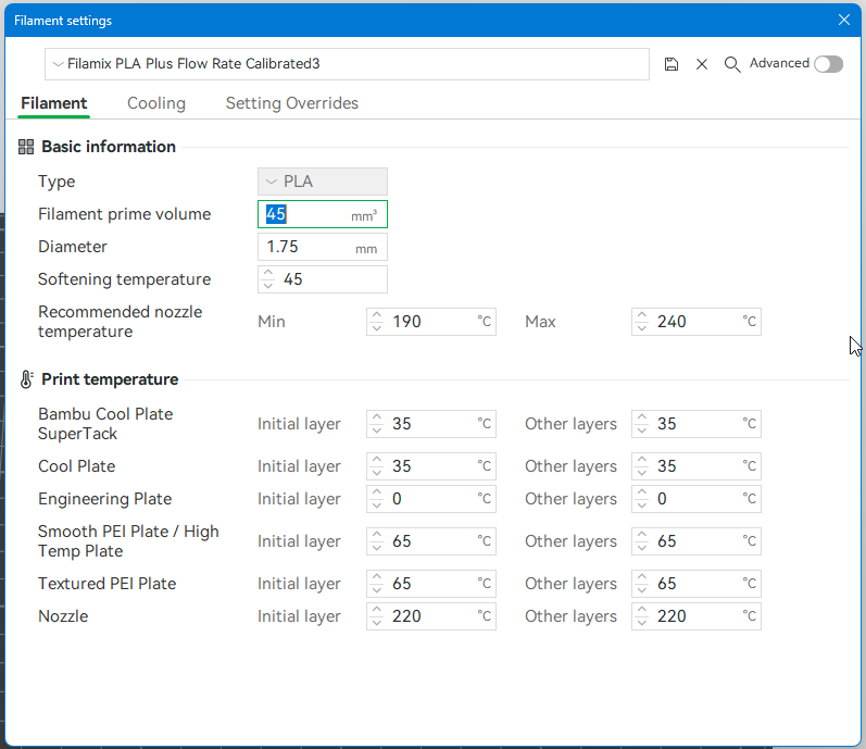

What is the filament you’re using, and more importantly what is the filament in your slicer settings please?
it is a turkish brand, white one is porima pla basic, blue one is filamix pla plus
Try using a generic pla preset
this worked. but (asking to learn) why? or how can i make customized profiles for other brands? i live in turkey and i dont usually (if ever) get any branded plas, all i can find are localized brands. ill definitely replace all my profiles for these brands with generic profile but what about others?
To create a new preset is pretty easy Just change an existing one and save. It will prompt you and you can edit the name. Here a good vid on it How to CREATE and NAME Filament in Bambu Studio to use 3rd Part Brands - P1P/X1/X1C
One of the best options ive found comes from my own mind, its one of keep it simple , a generic profile should suit most filaments on the market, as they are all pretty much one of the same

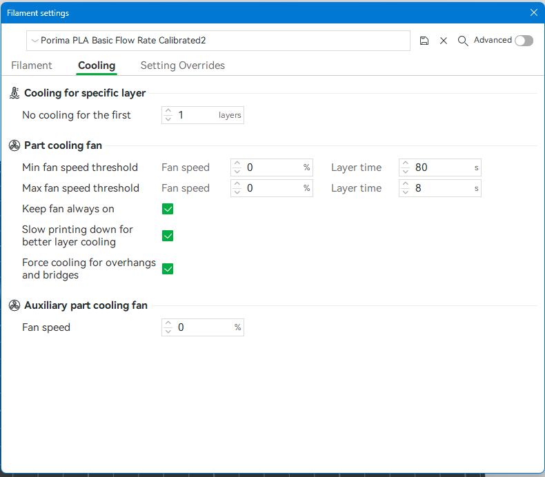

The “why” is because the filament setting you have screenshotted shows that you have 0% fan, and you are printing PLA.
PLA loves fan. Give it fan.
