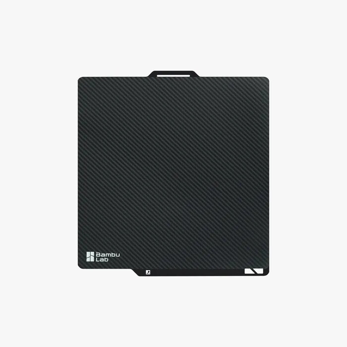

I bought PEI Build Plate Kevlar texture Original from Bambu but it's not detect!
I bought PEI Build Sheet Kevlar texture Original from Bambu but it’s not detect !
I don’t need to print ArUco (QR alike) from 3d plastic I need original. Why X2D not support even original which expensive?
Best Regards,
GSL
On the US store product page for those effect plates there is a warning (in 2 places):
For X1/X2/P2 Series users, please disable the Build Plate Position Detection in “Settings ->Print Options → Enable the detection of build plate position” when printing with the 3D Effect Plate to avoid error reports.
HTH,
-Max

There are many people use texture but they are using copied build plate which work fine but X2D have many sensor detector so we should close that options. The sound like you said they should update program…

I met the same situation when buying a “new” engineering plate, which had a different marking from the older , and it took 6 months to get a firmware able to recognize it
