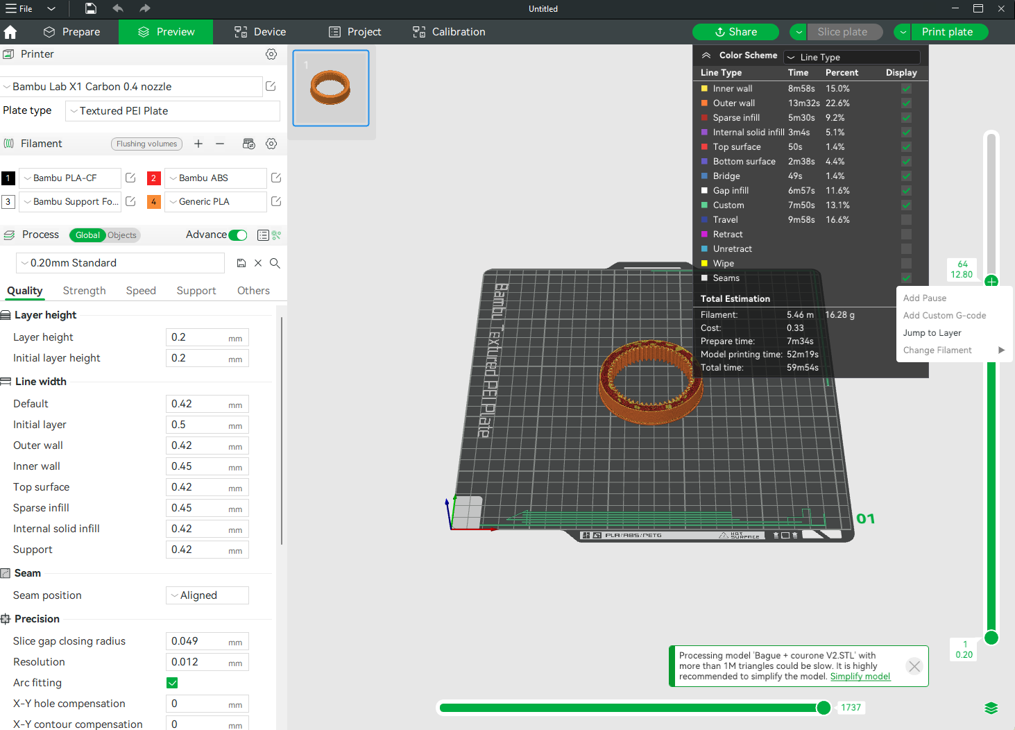

Hello,
I can’t insert a stop in my prints (I have a X1 carbon +AMS). The insert stop button is grayed out and I can’t click it. The problem is very similar to this one: Add Pause in drop down greyed out but the solutions provided do not work for me.
Do you have any idea to solve the problem?

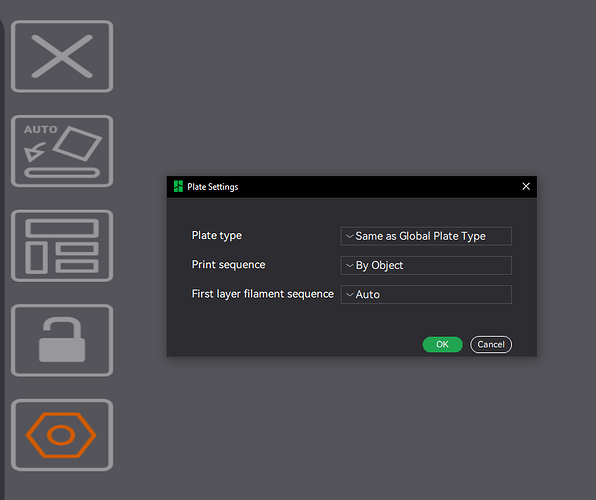

The only way I was able to recreate this was to select “By Object” in “Print sequence”.

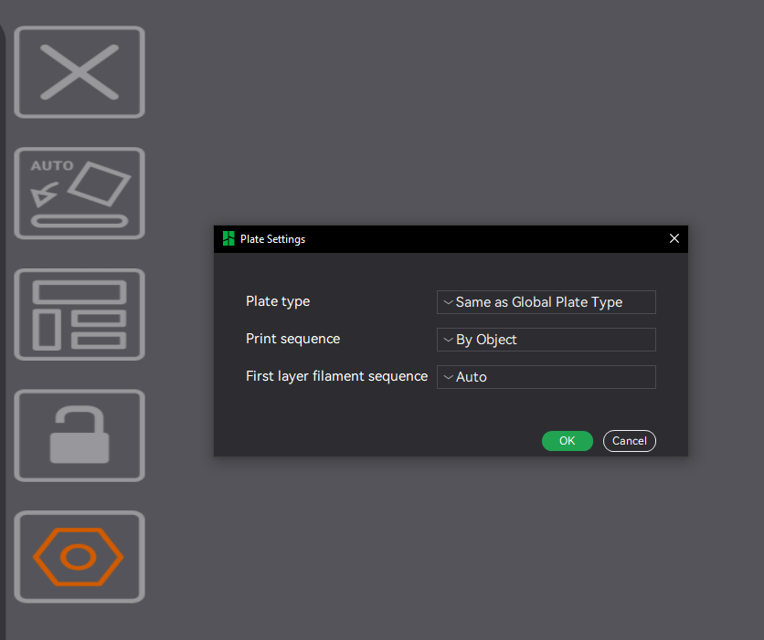

In the Prepare tab look at the top right hand side of the plate and click on the hexagon at the bottom of the icons.
It has to be set to either “By Layer” or “Same as Global Print sequence” to be able to add the pause.
Thank you for your help! I had to place it “by Layer”
