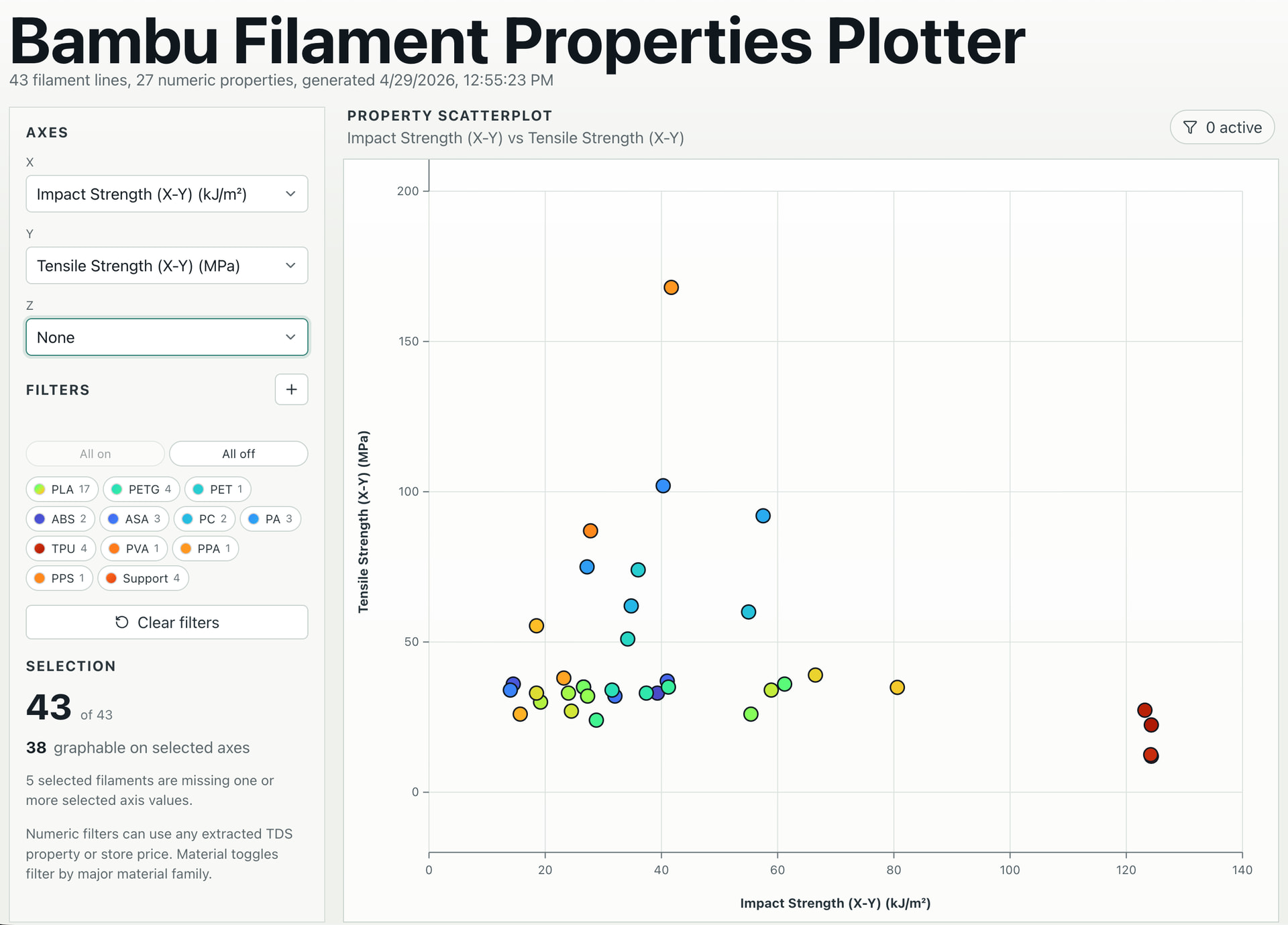

I created a Bambu filament properties visualizer : totally free
I had a hard time mentally keeping track of how different Bambu Lab filament parameters relate to each other, so I built a small visualization tool for myself with data pulled from the USA store.
It lets you plot filament properties against each other in 2 or 3 dimensions, filter by property or material type, and compare things like strength, temperature resistance, price/kg, print settings, etc. Click any data-point and it takes you to the PDF data sheet. It turned out useful enough that I figured others here might be interested too.
For example, you could try plotting tensile strength vs impact strength vs deflection temperature with a price cap of $50 and you would find out PC is an interesting high performer.
Free, no account needed, no ads, and currently Bambu Lab filament only.

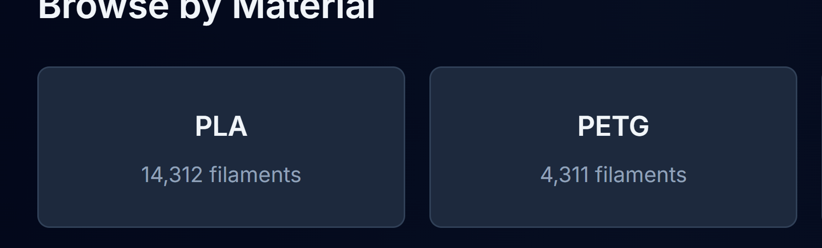

https://3dfilamentprofiles.com/filaments
The use case there was to provide a convenient location for slicer settings. That was a worthy goal, but it became overwhelmed with non-curated settings and had no clear way to grade the reliability of the data. It also appears to contain a large number of incomplete records, which significantly reduces its intended value. As one example, most of the 14,000+ PLA listings appear to be incomplete.

Thanks! I’m an experienced developer, and with AI assistance, I managed to build this in about 4 hours. The hard part is data quality. For exactly the reason you pointed out with 3dfilamentprofiles.com, lots of mid/low quality entries are useless. The tool is only useful if every entry is complete and trustworthy.
If I were going to expand it to other manufacturers, I think it would have to be limited to those that provide robust data sheets like Bambu does. I don’t think allowing community members to hand-enter data would work.
Even if I restrict it to manufacturers that provide data sheets, like Polymaker and Prusa, there’s the problem of each providing only a partly overlapping set of specifications. How do we graph filaments when the user selects 3 dimensions, but some of the filaments don’t share the exact same measurement for the 3rd dimension? Some manufacturers test “Heat Deflection Temperature” at 0.45 MPa and some at 1.8 MPa, but some only do one of those.
Then there’s the data reproducibility problem. They’re testing with different printers in different labs with different setups. Can the values from two different labs be compared? Probably, yes—but what’s the margin of error?
Finally, there are terminology problems. Is Prusa’s “Flexural Strength” exactly the same thing as Bambu’s “Bending Strength?” Probably!
All of these issues are solvable, but not in a few hours! I’d be willing if the tool got a lot of traction, but so far there are only about 70 views of it from this thread, and almost none from Reddit (I’m convinced I’ve been shadow-banned), so I’m probably not going to move forward unless it suddenly gets more popular.

Thanks for catching this and for checking against the TDS. I looked into the PLA Aero and PLA Silk values, and I think the discrepancy is coming from two different sections of the TDS.
The app is currently plotting the values from the “Recommended Printing Settings” section. For PLA Aero, the TDS lists nozzle temperature as 210 - 260 °C, and the app plots range values using the midpoint, so that shows as 235 °C. The TDS also lists recommended printing speed as < 180 mm/s.
The 210 °C and 150 mm/s values you found are from the “Specimen Test / Specimen Printing Conditions” section, which describes how Bambu printed the test specimens for the mechanical property tests. Those are real values too, just a different category of data. So your praise for including those data was misplaced! :face_savoring_food:
Same idea for PLA Silk+: the app is using the recommended print settings, while the specimen test section has separate specimen-specific settings.
I updated the app labels to say “Recommended Nozzle Temperature” and “Recommended Printing Speed” to make that distinction clearer. I do see the point of the specimen test settings, but I think most users want the recommended settings and the test results. The most important thing I think is the comparative values, not the absolute values.
