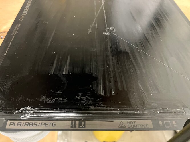

Allright, I’ve been using the X1C in my shop to print fixtures and similar for well over a year and really haven’t had to solve any technical problems apart from service items, the thing just plain works. That is, until I managed to mess things up.
Changed out the hotend fan, got interrupted by a phone call and then started the print. What I completely forgot was to reattach the screws holding the hotend. As a result the printer “printed” the whole piece before realizing something was wrong. The hotend naturally sort of fell out and dragged across the buildplate. Not sure why it didn’t realize something was wrong.
Anyways and naturally, now I’m having issues.
Popped another hotend in and the print quality is really bad. For those of you who have dug deeper into the guts of the machine, any suggestions on where to start looking? What could have been damaged?
Recalibration of the machine did little, and trying to calibrate flow results in no extrusions at all even though prints are printed, however with low quality.
Not sure how you can have even a low quality print with no extrusions at all.

Yeah sorry, straight after the incident it printed with a replaced hotend (paste looks good), albeit bad quality as per photo. The hotend from the incident was badly bent.
Then I recalibrated the machine and did flow calibration during which it didn’t extrude anything. Just tried doing a print and it’s stopped extruding altogether.
The stringing on the last print plus no extrusion makes me think the extruder probably was damaged so I’ll just order a new one straight away. Hopefully they can ship today.

For future reference, the issue was the extruder.
As the hotend came loose and got pinned and dragged along the build plate the extruder kept feeding filament which probably strained the parts within it.
