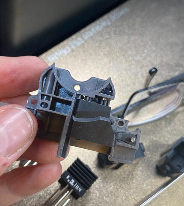

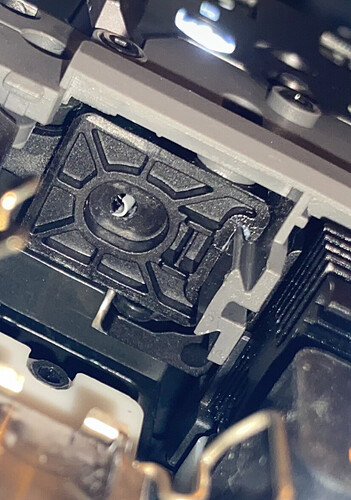

I ran into a strange situation. After printing some ABS on the left nozzle, I attached the laser module. During the startup checks, the left nozzle was jamming when trying to retract upwards.
I removed the laser and the hot end, and discovered pieces of a white tube-like material above the hot end, which was causing the jam. After removing it, the nozzle now moves up and down normally—so that’s good.
However, I’m now concerned that something might be broken. Could this white “tube” be an actual part of the printer, or is it more likely to be filament that’s built up or deformed over time? Should I just try to fish out any remaining bits?

There is no ptfe tube in there.
Open a ticket with these photos, something is likely to have gone very wrong .

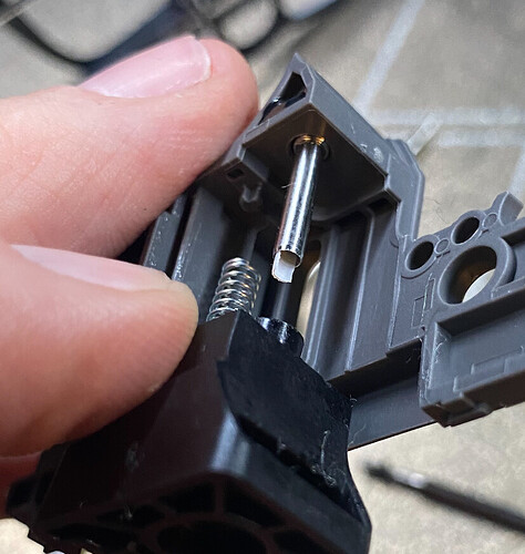

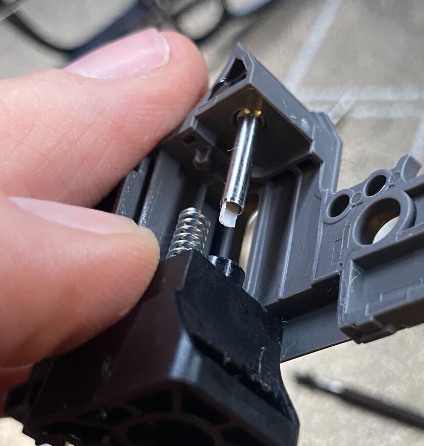

Anyway, I’ve opened a support ticket, but curiosity got the better of me, so I also had a go at disassembling the printer. It looks like the issue was indeed a bit of PTFE/teflon lining from inside a metal tube that’s part of the extruder filament guide. It had slipped out and jammed against the filament cutter, I suspect its function is to insulate and allow for reduced friction, it’s the only plausible explanation I can see as it’s defiantly a tube lining, and it’s held in place with the bottom of the metal outer tube slightly tapered, I guess it got soft while the printer chamber was hot the past few days printing ABS and just slipped out or broke up fragments and snagged!
After removing it, well whats left of it! the filament guide now springs up and down as it should. However, I suspect some PTFE/teflon fragments may have ended up in the nozzle—so that’s probably going to be trash, as it’ll likely jam again.
I think I’d better also wait to see what Bambu support says, but for now I’ll just stick to using the right extruder. That’s one of the perks of a dual-nozzle system, I suppose! :+1:

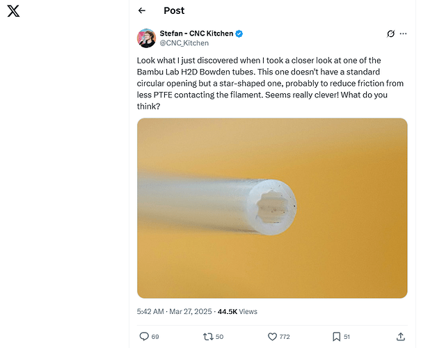

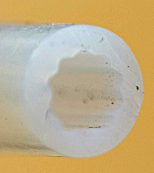

If it’s damaged you can buy replacement H2D PTFE tubes in the bambulab store. They have a star pattern on the inside diameter, so you don’t want to replace it with some random PTFE tube from aliexpress or amazon which wouldn’t have that.
AFAIK, it’s considered a “consumable”.

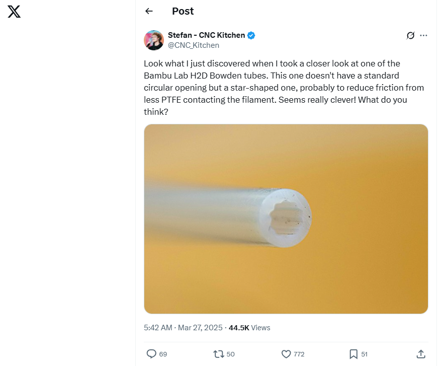

Whoa, do you have a picture of that? That sounds awesome and maybe something to help with other machines. Is the overall dimension still ID 2.5mm / OD 4mm?
never seen it before, have you got a link? I only found it from aliexpress and creality.
I’m basing it on what was said in CNCKitchen’s interview with Tao (the really long one you can find on youtube). IIRC, they discussed it, with CNCKitchen “noticing it” and then bringing up the topic.
I haven’t seen a picture either.

If the OP decides to replace his, maybe take a cross section before tossing the old one and post a photo of what it looks like? It would only take less than a minute.
doesn’t look like to be star shaped to me, I might just get it from creality and cut it myself
