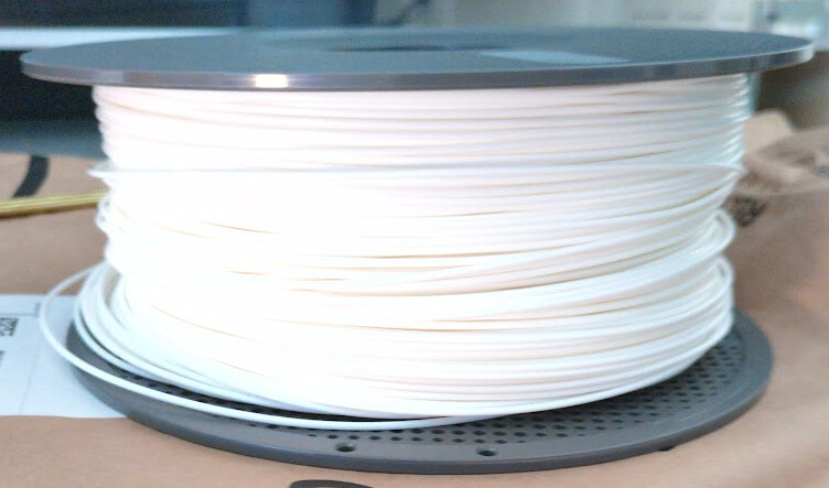

I HATE these refill spools
Thought I had it locked. Evidently not. Some lock much easier than others.
This is $15 worth of white ABS in the trash.
sigh….

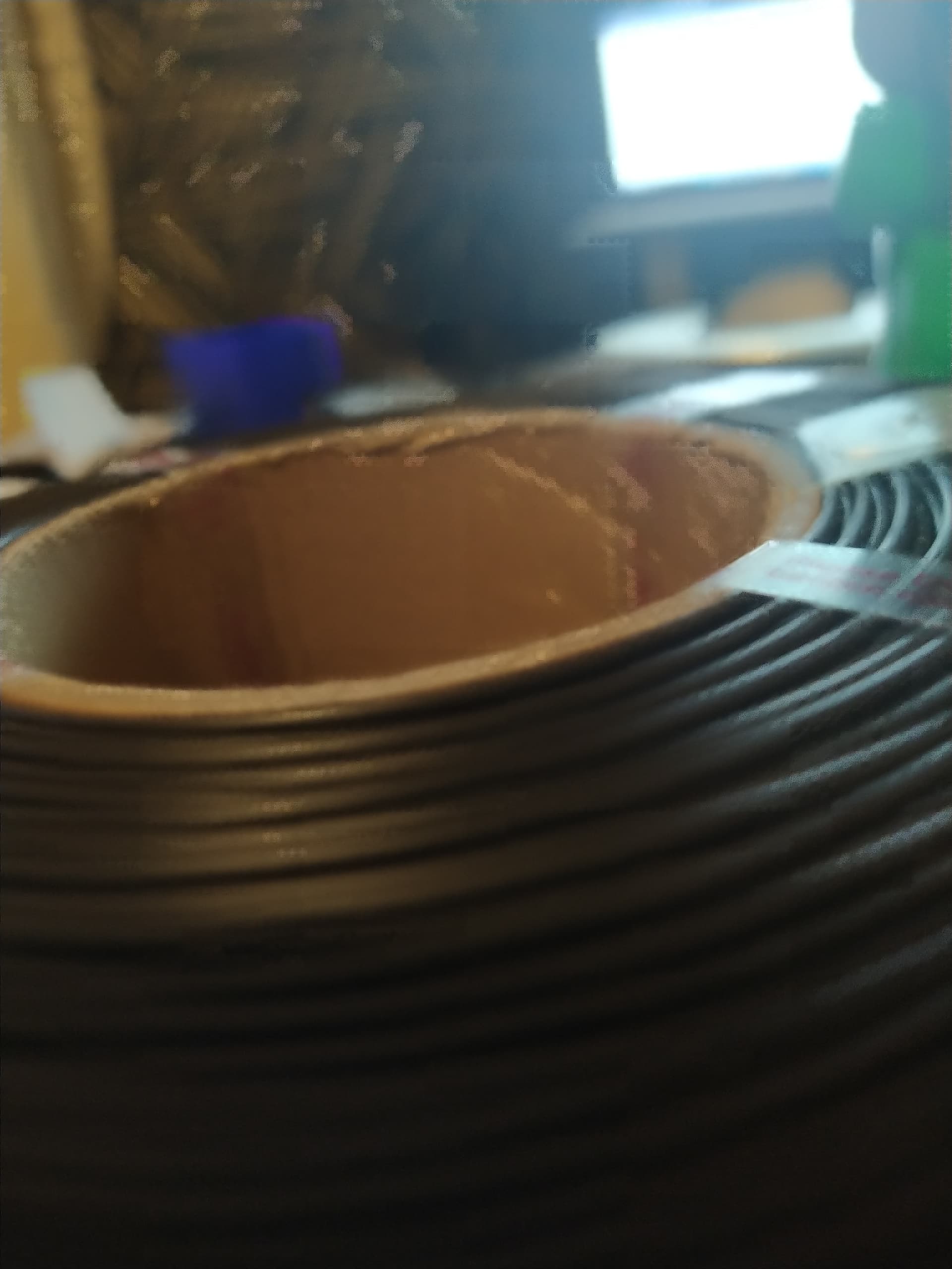

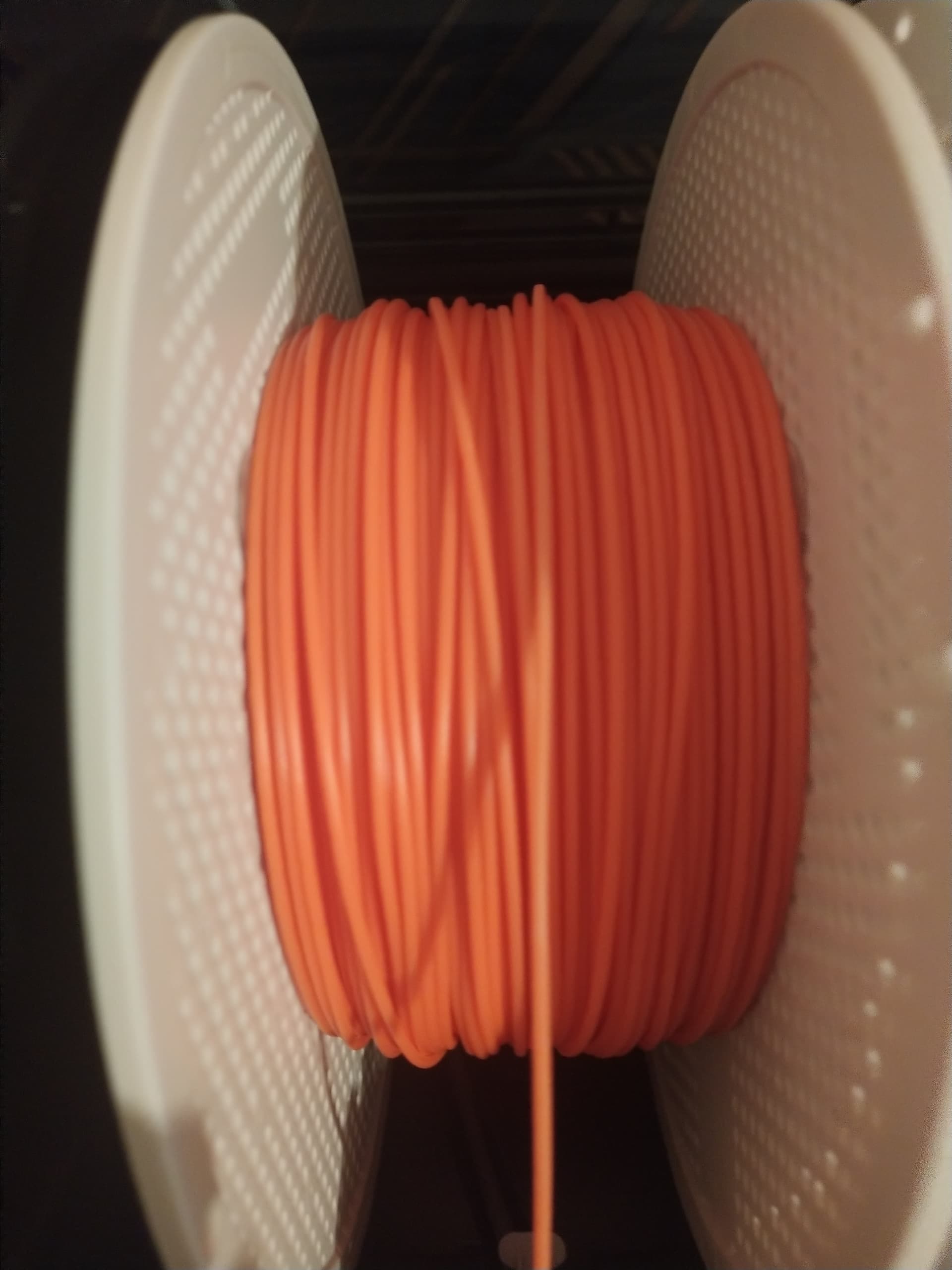

You may find the inner cardboard spool is at fault , ive found one or two to be slightly higher on one side meaning the outer spool wont lock correctly, you need to double check the formation of the spools before removing the tape ,i have an image in orange still working correctly through the ams.

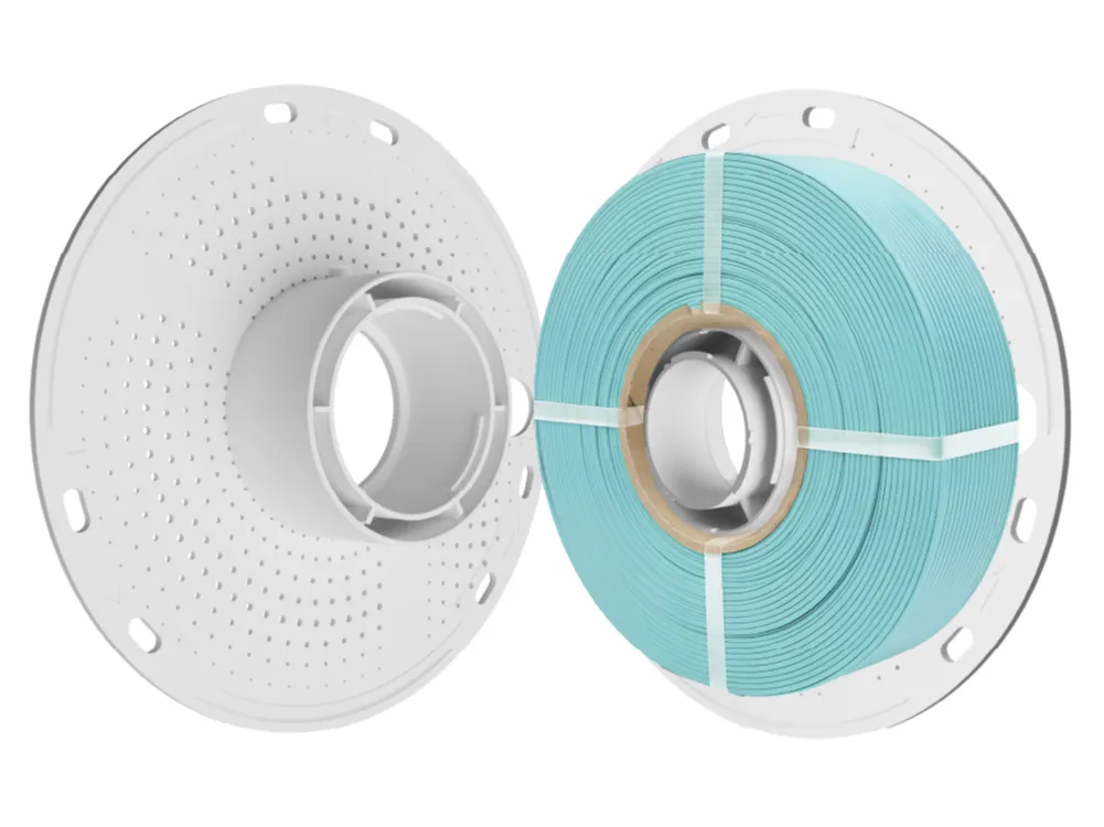

Make sure the notch is aligned before you do anything. Also, make sure you have it aligned properly, I found they only go together one way. You might want to look into Anycubic spools, they screw together.
The trick to Bambu spools, put the left spool with the notch in your left hand, use the right hand for the other spool, put the refill on the left spool with the notch in place on the refill, then take the two halves and align the two holes on each side where filament is kept when not in use, rotate the right half until it engages the other spool, and then turn it some more clockwise until it locks. Practice on an empty until it become muscle memory and you will find yourself doing refills in under a minute.
Sunlu spools are different, you have to look at the insides of both halves, there are marks on the outer edge, above the notch. Same technique though, but align the arrow on the right spool with the one on the left spool and rotate towards the mark on the left spool. When you get them aligned they snap right into place, if you do it wrong you can bugger it up. It will still go together, but wont snap into place and then you have happen what happened to you, a blown apart spool with filament all over the place.

Interesting tool but it doesnt help with the issue of the spool being slightly longer on one side of a surface ( like this /, probably from cutting with a dull blade as pointed out in the video ) the inner spool just needs squashing / cutting so the two slots can interlock… i downloaded for future reference though , thanks .
