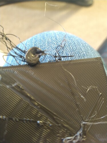

I have tried everything but the Print Head is knocking off my print every time
My A1 has recently reached around 1920 hrs on it, and I have been seeing more frequent issues since I reached 1400hrs. Most of the issues occur with the print head knocking a print off of the print bed, hitting a support, or hitting the model and having a huge layer shift which causes immense stringing and a ruined print. This has been happening non-stop on one profile and a few other makerworld profiles as well. I have tried changing slicer settings support recommended, as well as other troubleshooting steps I will list below. Important to note that the machine has been lubricated on the x and y axis every month and the z axis every other month.

I will happily take any advice as to what to do because I have tried different types of settings, filaments, hotness, build plates, and more with no luck so far. I am tempted to sell this and buy a different printer so if anyone has any recommendations for a printer as reliable as the A1 was when it was new I would happily take suggestions

Did you figure this out? For me it was the infill type. The infill was bulging up above the layer itself. Once it got tall enough the nozzle would catch on it and knock it off. I switched to crosshatch.
Infill type for me as well. I was printing a tall, relatively skinny file and when I switched from Gyroid type to Triangles type infill I was able to print it without it being knocked over around 20-25% through
