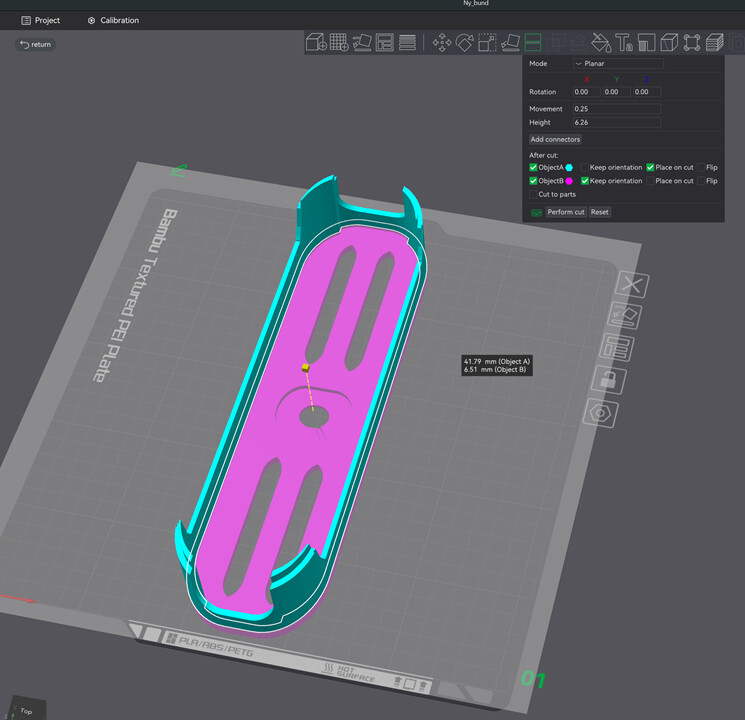

1: Bambu Studio’s Cut Tool lets you define a plane across the model to divide it into two pieces.
This function, could be used to print a template of the selected area.
