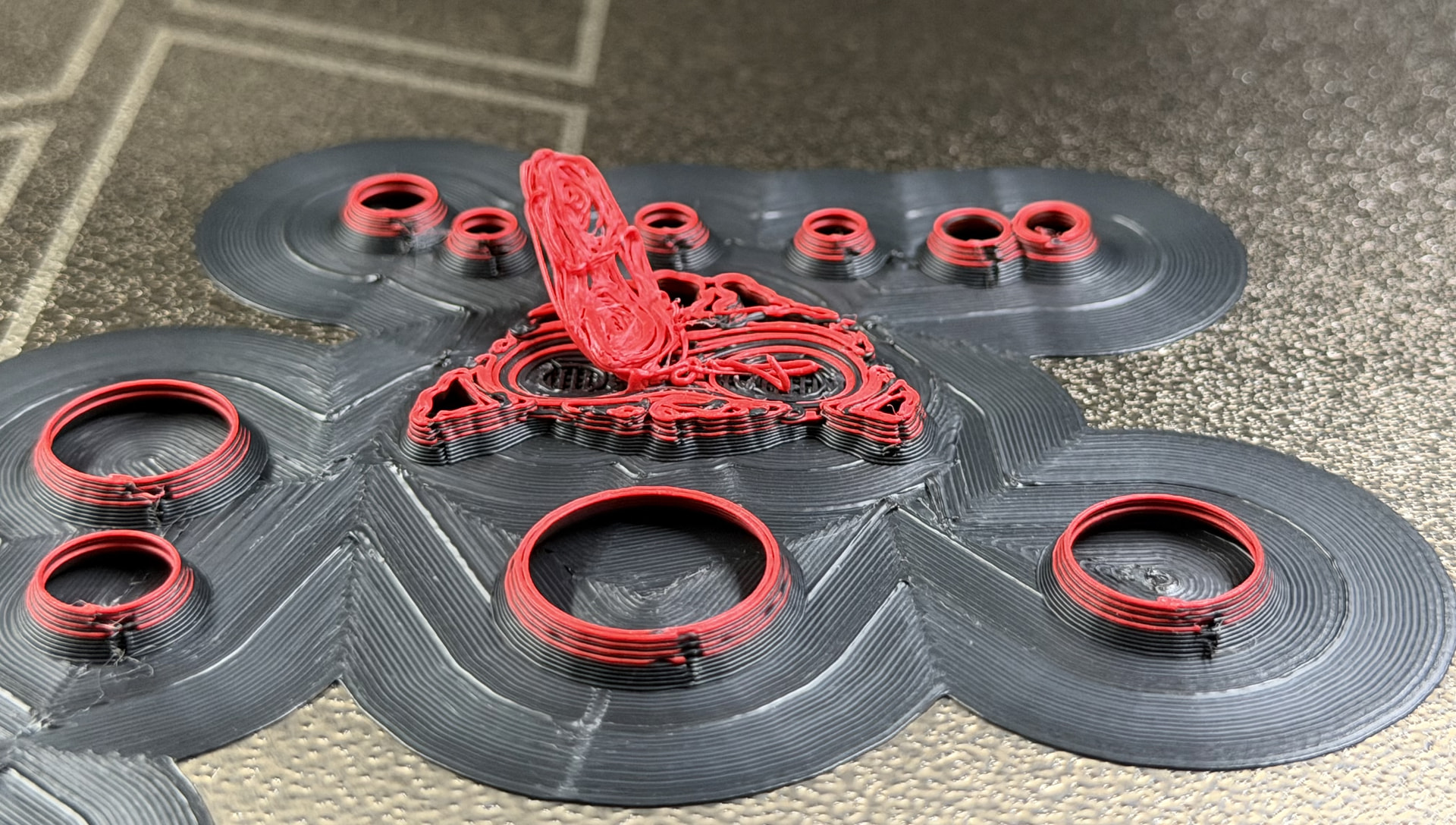

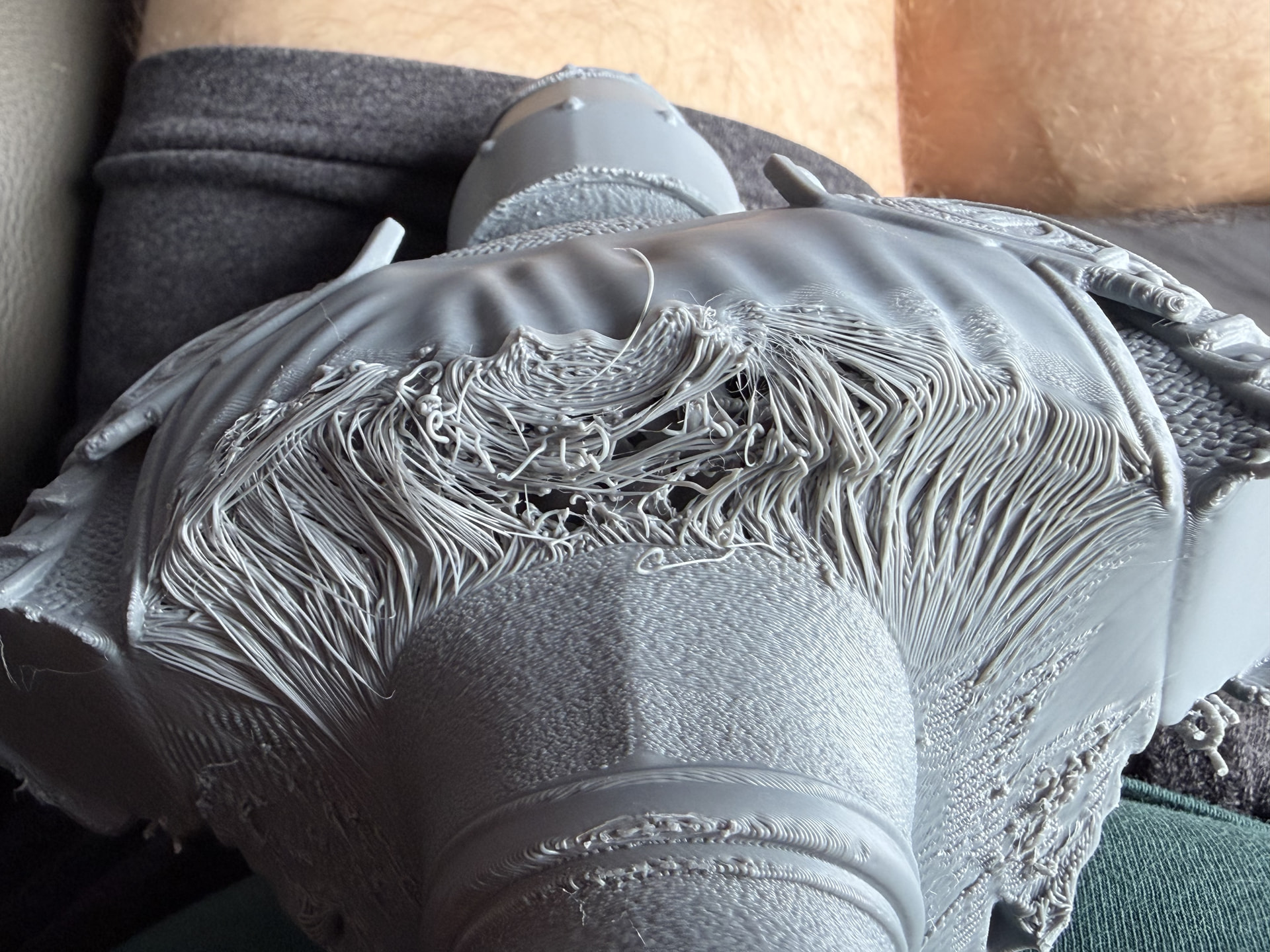

I need help I’ve tried to print an item at least 12 times now and have no idea what to do now I’ve read virtually everything I can find on the issues I’m having I’ve followed various guides changed multiple settings made sure the pla I’m using is dry. Spent hours watching videos.
Textured Build plate has been cleaned multiple times. Printer is a H2D and using both hot ends I’ve changed filaments to either hotend. I’ve used different areas of plate and the other side.

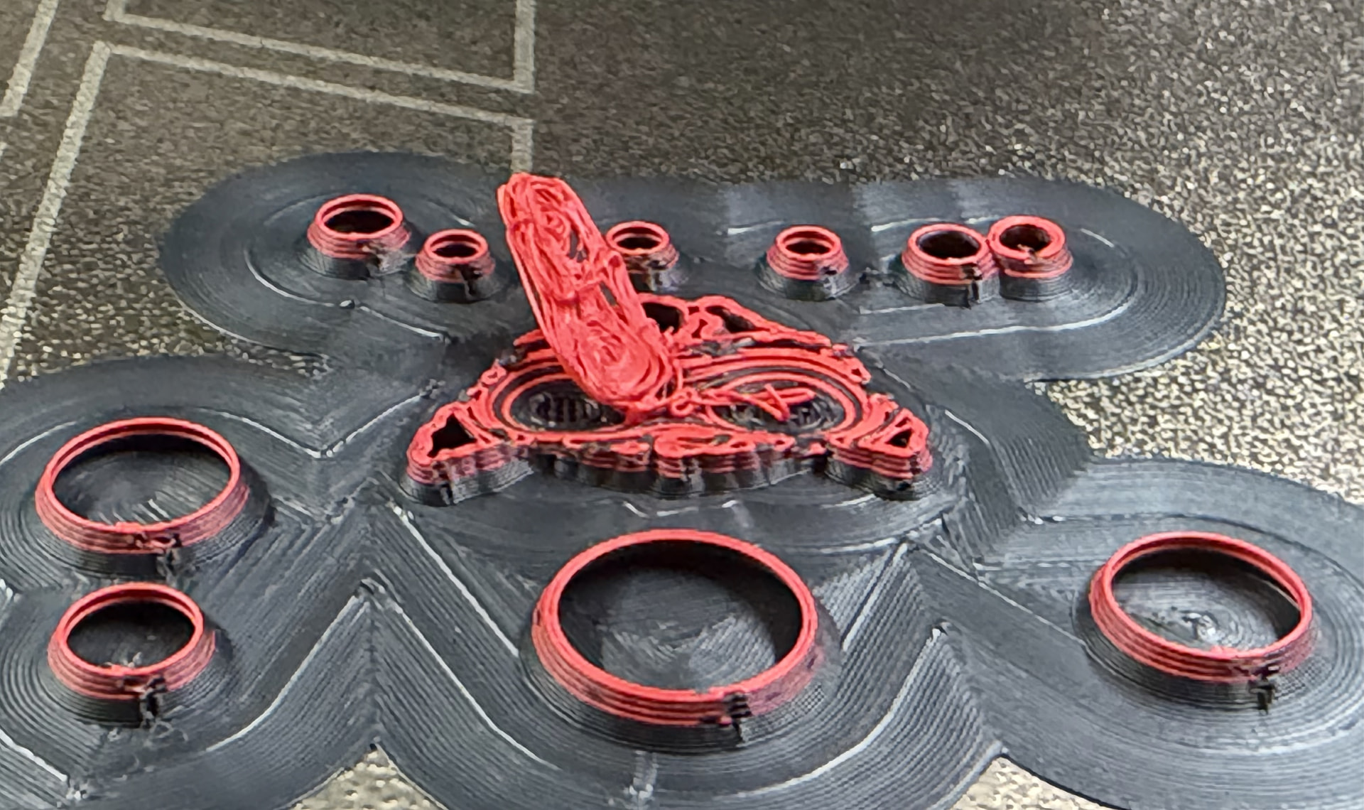

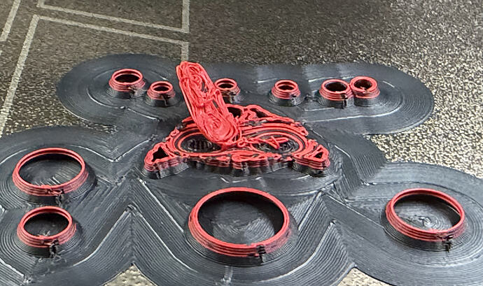

It’s a multiple pla print 3 colours all Matt black, red and white all Elegoo. The print starts ok seems to adhere to the build plate then it starts to string and rips the items off the plate. Just as a quick guide I’ve adjusted nozzle temps, build plate temps, z hop, turned on avoid crossing walls and retraction I have genuinely tried now I’m out of ideas.
I’m considering setting the printer back to factory settings and hopefully someone on here can explain what to do.
I’ve added some pictures of issue of a print I’ve tried afterwards using single filament which has issues also.

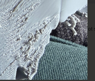

You say you’ve made sure the PLA is dry but how?
Those look like water issues to me and I would bet a printer I can print that clean on stock settings. Stock settings is all I’ve ever used but I know for a fact my filament is dry.
Things that matter are how you store, ambient humidity, and how you dry.
IMO that filament still looks wet. Im not sayin its the full problem but its a problem. Could be running too hot or a retraction issue, but I stoppped using mattes so I dont have a good eye for them anymore.
I will also add, prints shouldn’t be pulling off a properly clean build plate mid-print.

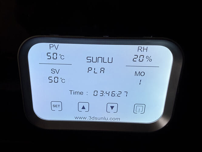

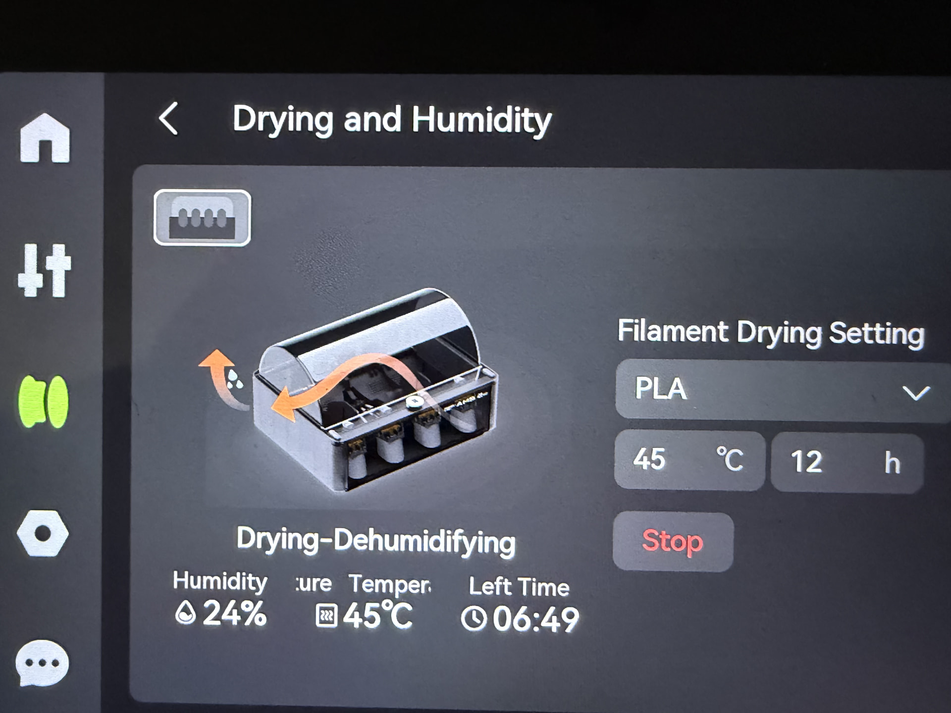

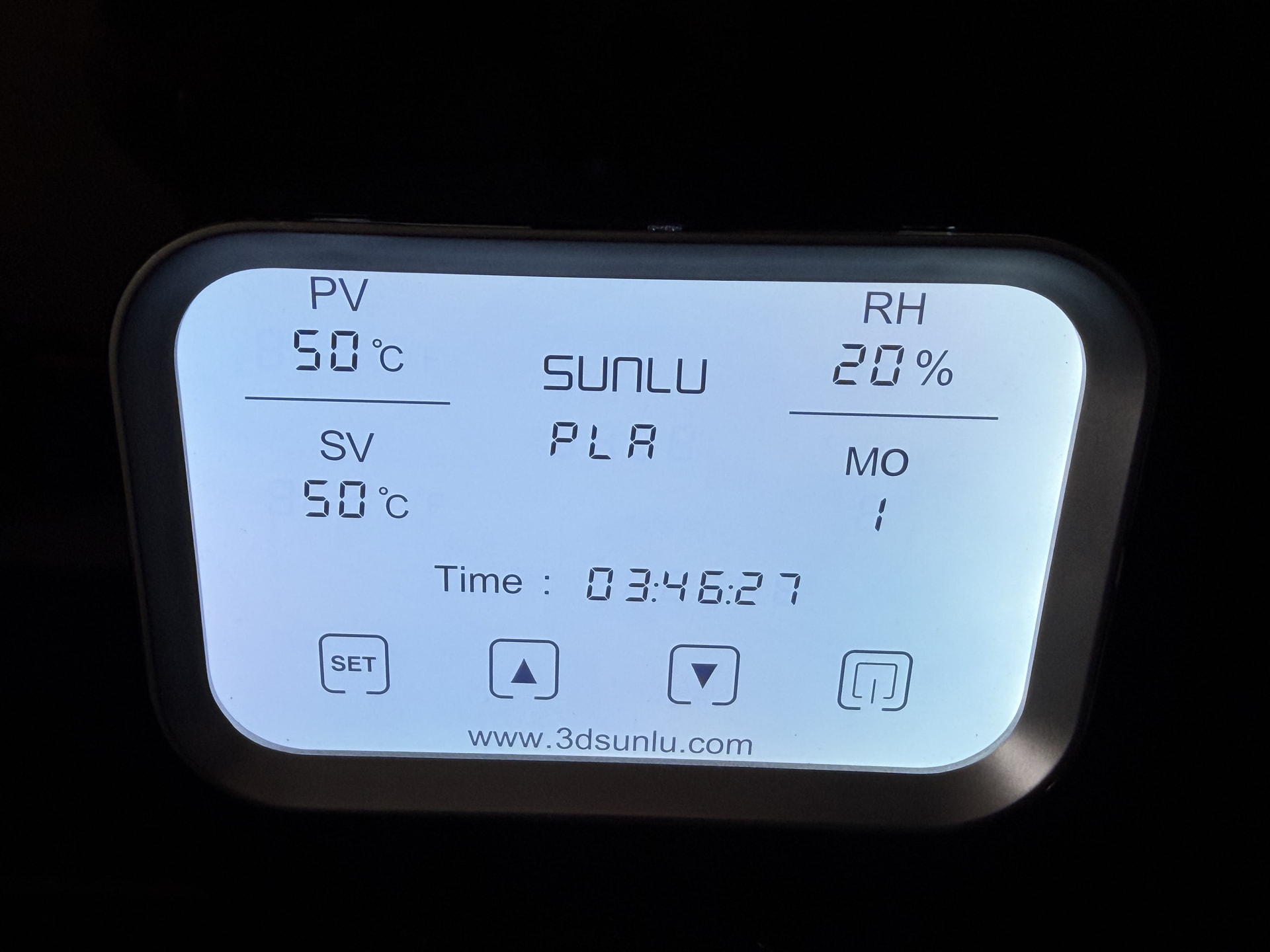

The filament has been dried overnight in a Sunlu drier removed and immediately placed in the ams which has new desiccant in it.
I’ve even used the ams drier facility.

And at least with my sunlu, I get the best results by propping the door open about an inch at the start of the dry and then closing it once the humidity has peaked and starts dropping again in the drying chamber and leaving it closed for the rest of the dry. I purge with dry air in the 2nd half. That’s just a disclosure. I found my Sunlu S2 only dries marginally without it because I have high ambient humidity. You won’t be set up like that but the open door/close door trick really helps.
What is your ambient humidity and what is the humidity in the dryer when you took the filament off?
You can test your filament directly for water by putting a spool in a ziplock bag with a hygrometer and sealing it. In 30-45 minutes or maybe sooner (when the number stops changing) the humidity number tells you about the moisture content. With PLA I don’t print it if the number is over 25% RH.
Is your AMS one of the new ones that dries? If it is, the desiccant you add must be kept dry. If you let it pick up too much water, the desiccant will actually reduce the effectiveness of the drying action.
If it’s the old style AMS that doesn’t dry, new desiccant in the AMS is a good start but will take a while to further dry the filament. At room temperature the drying process happens but it’s slow.

These are from the ams and sunlu I printed the black and white matte pla filament from the ams and the red from the sunlu drier.
Those are too close to values I use though there are differences and the AMS number seems a bit high to me. I have no experience with the drying AMS units to say much there. Mine are AMS (I) units.

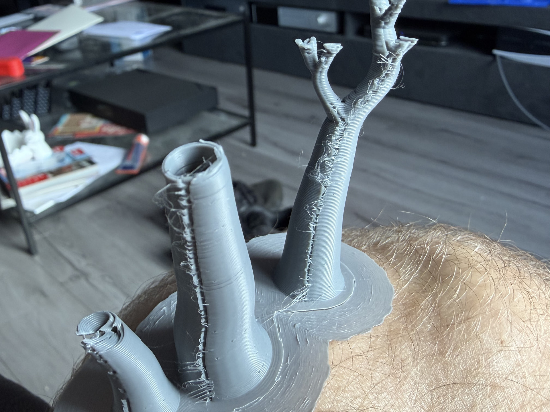

The seams to me imply a retraction issue, but I am not sure.

I dont think its a wet filament issue though. Probably pa or seam settings. If this is completely using the pla preset, possibly hardware issue. Trying any other pla will tell you if its machine/settings or filament

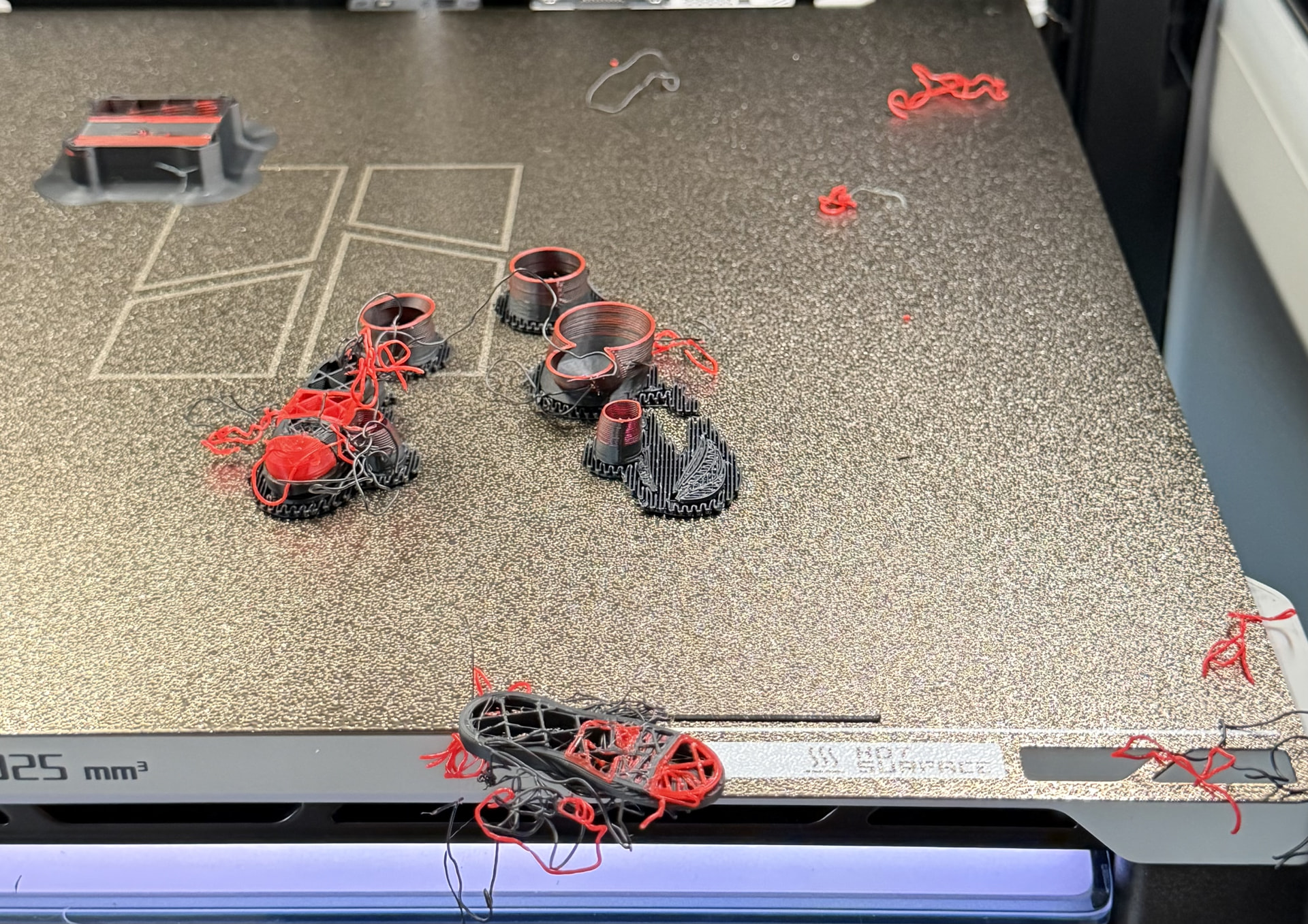

I’m still having constant issues with the left nozzle only and to me it seems that the left nozzle is scraping across the print. Over the last week 2 brand new bambu 0.4 hotends installed and a new textured bambu build plate. The printer has been calibrated multiple times as well as the use of the vision encoder. I’ve taken the print unit apart cleaned and oiled parts that require it. The printer is regularly maintained so I’ve no idea what to try next. A H2D was a big investment for me and I’ve enjoyed using it but I could gladly smash it up with frustration, if it wasn’t for the pure mess resin printing makes I’d gladly go back to my resin printer.

I’ve already tried a brand new role of bambu pla dried it in my AMS and no better on the left nozzle but works ok but not perfect on the right nozzle. I really am clutching at straws now I’m not sure there’s any setting, cleaning or filament I haven’t tried. I’m definitely not a tech wiz but I try to research and learn and respect the people who share knowledge but I’ve come to a dead stop and my hobby is close to being parked on a shelf.
I would detail everything you have done to date and open a ticket.
