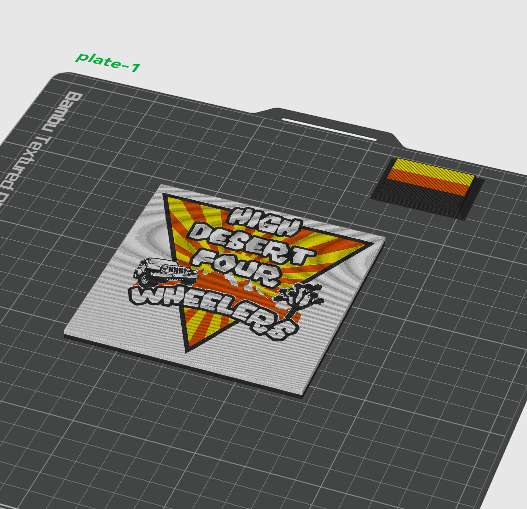

3dpea.com_HDFW Logo 1500 x1500 (1).3mf (2.1 MB)
This is a perfect application for the Maker lab tools.
The first one I would use the image to key chain. The second one would have to be a relief.
But you can make something like this in a few minutes
A few extra steps would be to erase the background and add a border. Nano Banana could do that easily.
Thank You! I’m on it like flies on a Bar B Que. I thought there has to be some easy way. Well, easy for most, but not me actually,
I have a file. and it is loaded into Bambu Studio. But when I attempt to slice it the slicer gets to 5% and stops. I’ve tried it twice now. I must be doing something wrong.

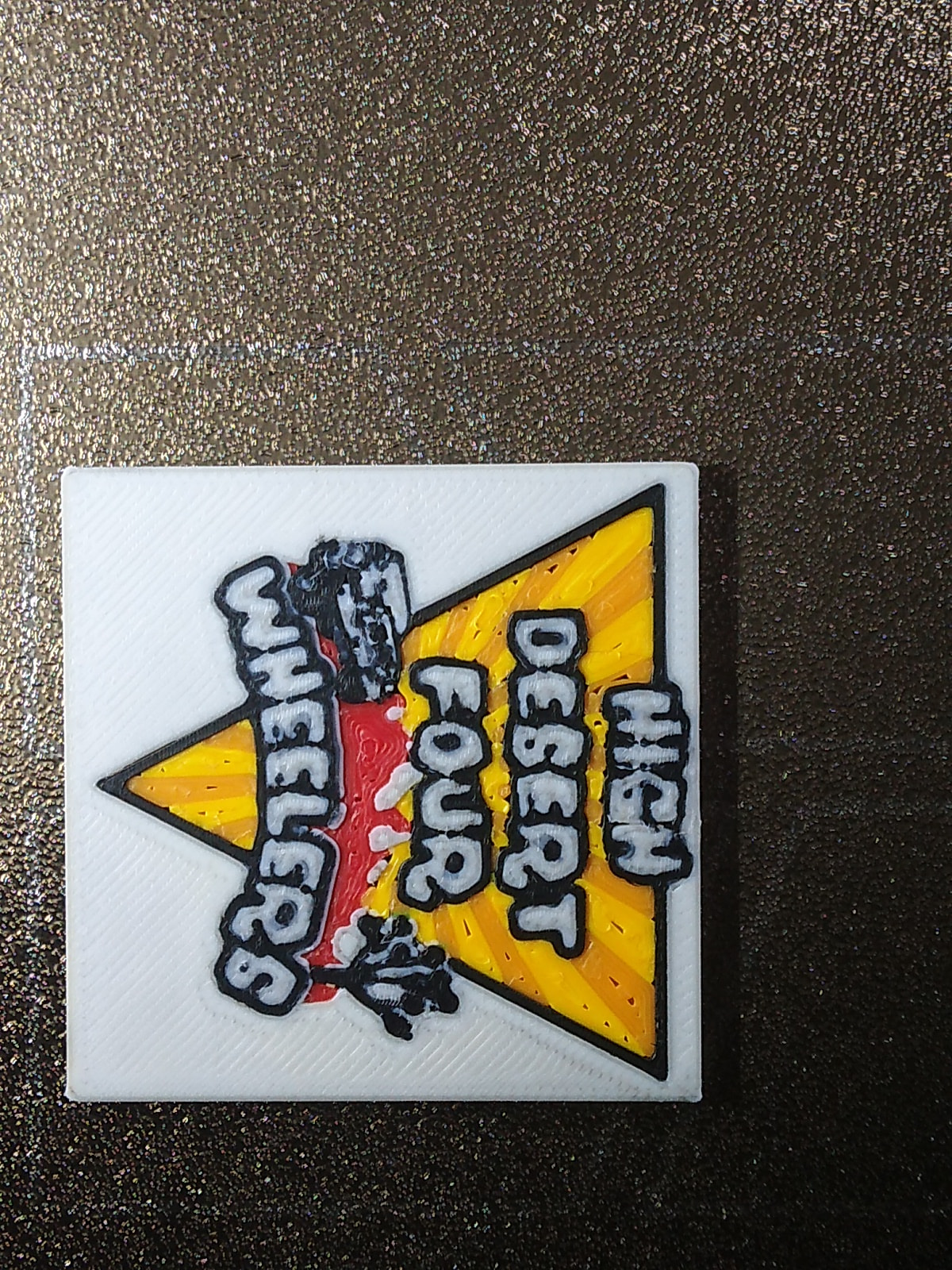

It came out decent for it’s size. I happy so far. Needs some fine tuning though. The dirt (brown) came out red. So it looks like a wildfire. The color selection was true, but the printer had a mind of it’s own. I just ran it and hoped for the best. It did come out fine.
I’m now running one with a 0.2mm and it will be much slower than the standard 0.4mm. About double the time, which does not surprise me for half the capacity to spray filament.
All can be tuned in time. But overnight this has become a viable workable project. I was just pinging around outside the Bambu Studio, and never finding my way there.
Yes, I have my nozzle changing down pat now, and how to change it everywhere it needs to be changed. I dug into the wall generator and found out it is already doing Arachne. So I think good to go there. Ironing (whatever that means) (I’m a jeans and T-shirt kind of guy) is set for top surfaces, Rectilinear, 30mm/s, 10% flow, 0.15mm spacing, and finally inset is 0.11mm. How it got there is beyond me, my guess is (and hope) that Maker Lab did it automatically. I need all the magical help I can get, as you can probably tell by now. :wink:
Here is the result: (a Picture is worth a thousand words… LOL)
0.4mm nozzel, Just opened last nights file and sliced, then sent to the printer. I haven’t figured out why my printer is also using colors not in the file. But there will be time for that later.
The newest one (0.2mm) is coming out Lavender where some of the white is. But I’m letting it run because one of the gals has much of her small details on her Jeep in Lavender. So rather than toss it, we’re going to toss it to her. She’ll love it! And I got the spool of lavender for trail badges for her especially.

Thanks The Generals. So far just changing to the 0.2mm tip has really helped the result. (as suggested in the fine print of the model). I’ve used the smaller nozzle for other badges and like the results. These have both printed out at 2.05mm thick. So not very thick at all.
The 0.4mm has a more three-dimensional look to it, but is rougher as well. The 0.2mm is flatter appearing yet still has a three-dimensional appearance. they are 2" X 2" as they sit. Which is about the size of many round medallion’s Jeepers like.
Front side down, yes considered that and may even try it. But I’m a visual person, I like to see what I’m doing. Right now, since the printer and AMS can’t behave, After the second one after changing the nozzle to the 0.2mm printed in Lavender (B3 spot in the second AMS) I simply changed the Lavender spool for a deep blue that matches the sons Jeep. And Wa-La, have a Blue printing just that easy. Has 28 minutes to go now.
