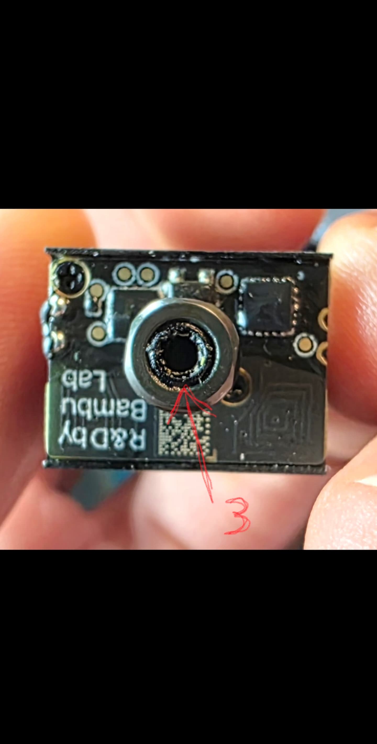

Loaded 90a in right nozzle. decided to use the top holder, unloaded, moved to top, went to reload the right nozzle and its clogged. Tried pla, still clogged. Seems that it melted pretty far up the throat. Bet the fan was added due to the heat creep on the new nozzles.
I also see why they are hard to unclog.
1 is silicone. cant torch the tip.
2 is some sort of wrap. Cant torch that.
3 is a plastic insert? cant heat an allen wrench

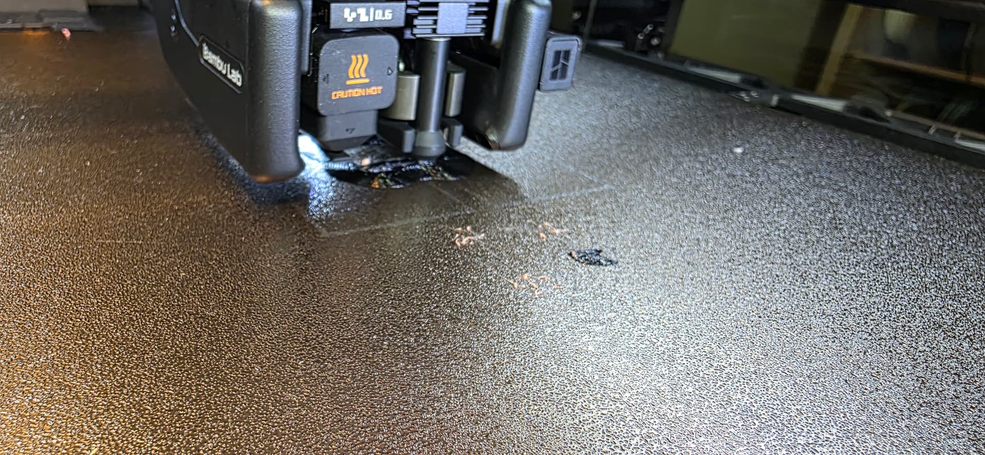

Just clogged a brand new .6 induction nozzle. Same deal. Clogged while waiting to do its initial purge. Guess they should have made the left nozzle the fixed nozzle. The left barely works for 95a
Before anybody asks.
Im just doing normal stuff. Nothing weird. Not my fault. Just looks like the new nozzles wont be be great for 90a or 85a. Makes sense because they planned on the induction nozzles being fed from ams units. I haven’t tried 95a in the right side yet. 95A in the left side sorta works. Doesnt clog atleast.
But does look like the printers are getting less tpu friendly with each new model. Atleast the H2D has that fixed nozzle. The H2C is in fact built around ams units. Probably the most profitable product bambu sells.
Sorry but is it a clog or a extruder jam or heat creep?
A clog caused by heat creep is my best guess. 2 nozzles. both after purging once and then sitting while the other nozzle purges. The purge looked good both times, but the clogged next time it goes to move the filament.
When I try to manually extrude afterwards, its just clicks… When I pull the filament out, after cutting, its not mangled or stuck. Try to extrude some harder filament, still jammed. New nozzle and repeat
