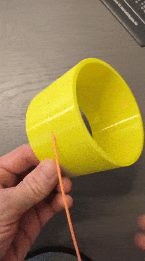

I made this for “TPU for AMS”.
sleevegif
It has high friction along the tangent but low friction in the radial direction.

Excellent take on the concept …no multiple parts needed, just a simple channel. I presume making it in TPU or similar is an essential part of this. I’m surprised that the object holds together like a solid when printed in TPU, I thought TPU was more flexible than that.
So this would slide over the hub in a Bambu spool? I assume you’ve sized it just right to hold tight to the hub and not rotate. (Oh wait, of course if it’s like the cardboard spools, you’ve added that notch which is what stops it from slipping… gotcha…)

Let us know how it turns out! I used HARD TPU, (Bambu “TPU for AMS”). Only tested it a few times in the AMS but it works. Might even work printing it in PLA if you adjust the channel to pinch properly. Same size as Bambu cardboard sleeves.
The channel is centered to have optimal angles when it runs out. It shouldn’t matter where you start spooling as it will always “step up” for each layer.

I haven’t posted it to Makerworld yet because I wanted to test it with a few more filament types first :slight_smile: I remember one more detail: this is a section view, and it prints support-free with no overhangs when oriented with the notch facing up. Not sure how many people actually respool (I’m lazy so I don’t…), but I’ll share it for remix if there’s interest. Collective data is what really matters here!

Well, I rather foolishly thought “I’ll make one in PLA even if I know it’s not going to be ideal…” so I did, and of course it was far from ideal! The rotational grip might be enough to allow respooling to start (it feels a bit slippy), but the filament is covered over too much to allow angled extraction at the end of a print run - it bends the filament at the entrance to the ‘tunnel’ part, but there’s not enough room for it to ease out vertically - has to be pulled back out the way it went in. So with PLA (which is all I have to hand at the moment), either I have to reprint it with a wider gap above the filament … or take a file to the channel and open it up manually :slight_smile:

I had a bit of a head scratch and decided to do a small test to see if a simple tapered channel in PLA could be made to work. Turns out it can - the deeper of the four test slots in the code below works quite well. I’ll map it on to a cylinder next. The slight taper serves two purposes - the obvious one, but also it removes any need for exact fine tuning of the slot for marginally different widths of filament - just push it in far enough to grip and you’re done.

Creep, in both the sleeve material and filament, is a real issue. If you exaggerate that and conclude that “everything will be loose” after a few weeks, the result would still be favorable: The last few turns on the sleeve will not be retractable by the AMS but it will print just fine.
I hope so! And if repeated use of the same hub makes the grip a little slacker, the taper in the channel should automatically compensate just by pushing the filament in a little farther the next time. I haven’t printed it yet because I don’t have my micrometer to hand to measure the spool diameter, but I’ve hacked up most of what’s needed in OpenSCAD if you’re interested. I’ll see if I can send what I’ve got so far to you directly through this system and if not I’ll come back and add it to this post. Apart from entering the right dimensions, the only tweak I still need to make is to round off the top of the channel so that there’s a less sharp overhang.
Well, after 9 :frowning: iterations I finally have a design that works acceptably well in PLA. ( https://gtoal.com/OpenSCAD/grabber2-v0.9.3mf ) It relies on being a tight fit in an original Bambu spool and it takes a little bit of practice to find the sweet spot to pinch the filament in between the two halves, but it does work! I may be the only person to use it given that it’s a little fiddly to attach, but I will definitely be using this myself on all 4 AMS slots. (I suppose I should put together a short video to show how to use it. I don’t make good videos :frowning: )
