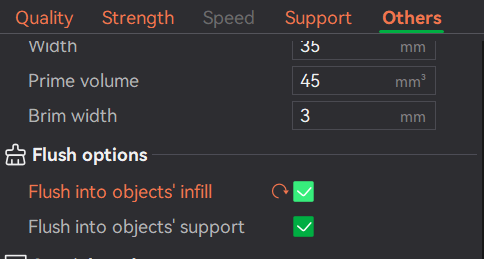

Is there any way to set up the Bambu to just use regular infill space as the wipe tower, thus reducing the need for the tower at all?
If I could have the printer wipe off the color as infill, that could be helpful. This would obviously only work with dark colors but it was a thought
That’s in the slicer settings, just a checkbox, unless I misunderstood the question.
No way to control what colours go in though, so if you have dark infill with a light shell it might be visible.
Purging and priming are different things though. We can purge to infill instead of the poop chute, but we’ll need priming regardless. If we could prime to infill instead of building a prime tower the volumes should be small enough that the risk for see-through is lower (but still a caveat).
Might be worth a feature request in Orca, though the only good reason would be for models so big you can’t fit a prime tower. The savings are miniscule - the prime tower is very low density.
