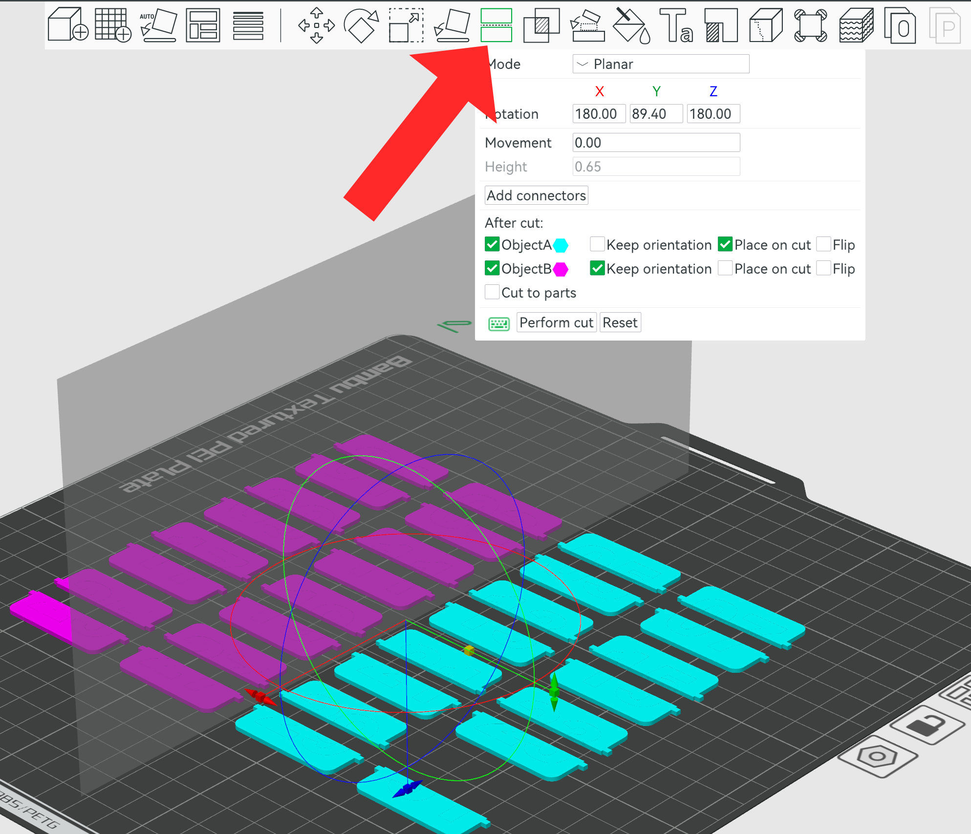

how do i print only the bottom part of 23? i lost it and need replacement but idk how. it shows up as one object. i usually just click what i want to remove, left click and delete. its perpetual cube calendar by tonas. im new, srry if its stupid question

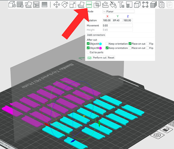

Just checked, it really is only one object. But no problem, use the cut function and separate it. You just have to cut several times until only what you need remains.
It’s best to check the box “keep orientation” so that your object doesn’t rotate.
You can also select it, then right click and use split → to objects.
After that they are all individual parts.
