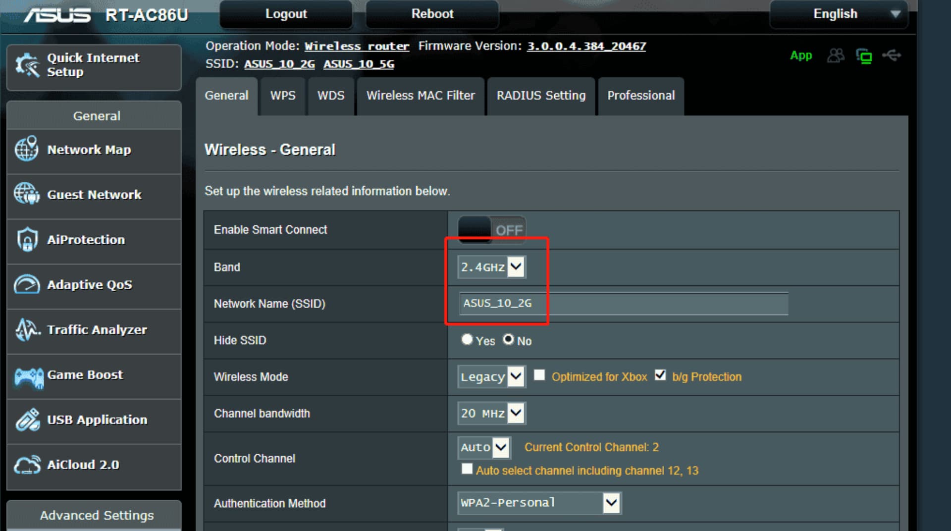

Had problems too with my Asus AX6000 after disable “WiFi Agile Multiband” the problem
was solved. but that’s my WIFI router.

Keep in mind: When using the cloud function, it is not only important that the internal network is stable, but also that you have external contact with the bambu servers. Both your printer and your router must be able to access the bambu network.
Also bear in mind that the printer uses the 2.4 GHz frequency band, so if possible, select a channel with minimal interference. You should also give the 2.4 GHz network a unique name (WiFi SSIDs) and separate it from the 5 GHz network. Make sure you don’t give them the same name, as this can also cause problems. Keep both networks separate.
Solved by updating BambuStudio
