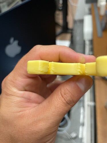

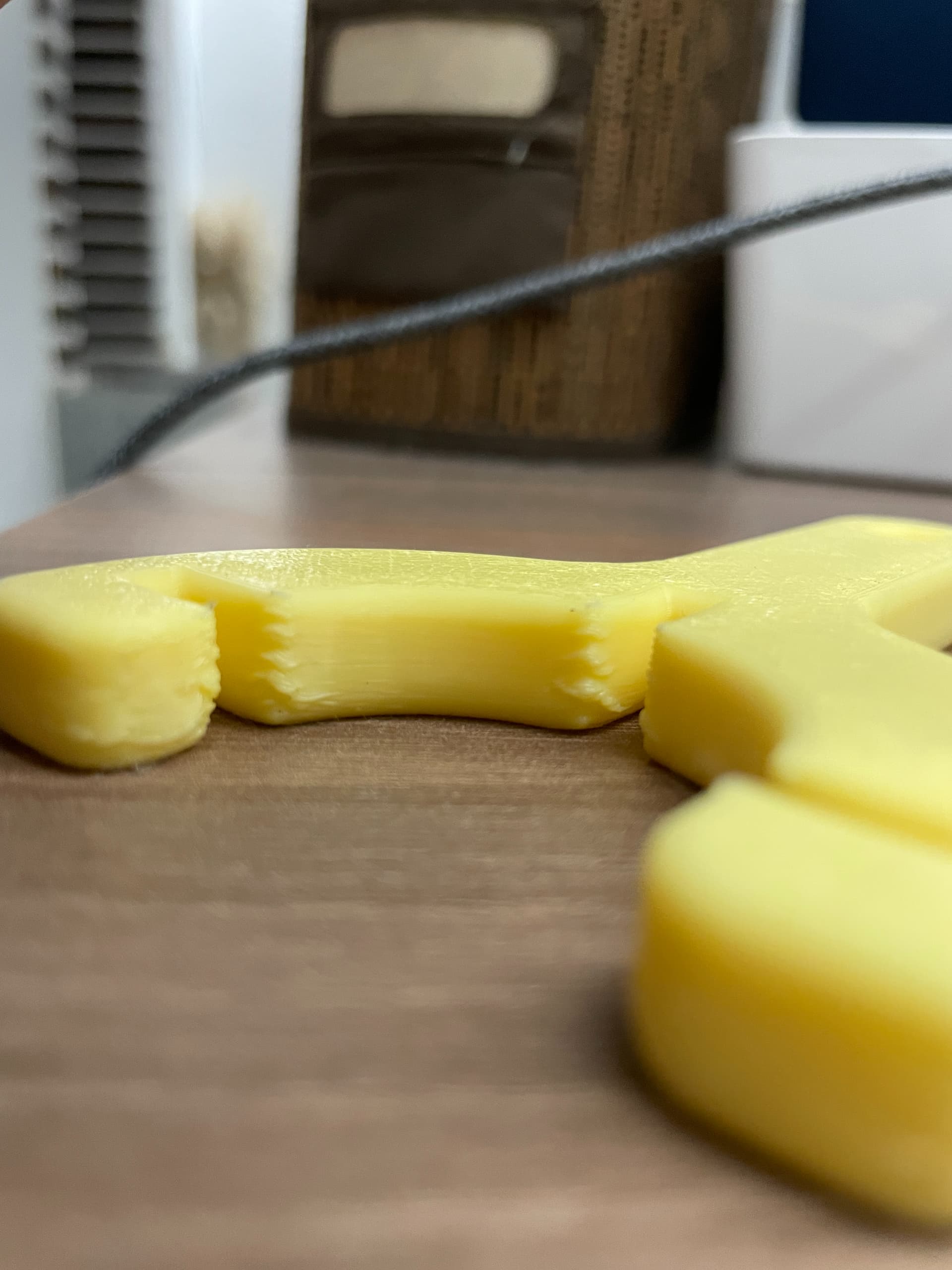

Hey friends,
I have noticed that suddenly my prints do habe some imperfections which are bothering me alot. Since i have had never an issue like this I would like to get advise what most likely the issue could be before I start “randomly debugging and disassembling” my machine :wink:
Anybody has a good hint or even similiar experience in the past? Please see the pictures.
Best Regards
Check to see if your part fan is working.

Indeed my part fan was not running. I did order a new one and wanted to tell you guys whether that was the solution (which probably is).
Thx for the hint i will try so start the old fan m . Mine was looking so in a bad shape that i just assumed it must be broken.
READ, commenting will not help.
@JonRaymond thx man. You were absolutely right. The fan is not broken but was set to be offline though.
