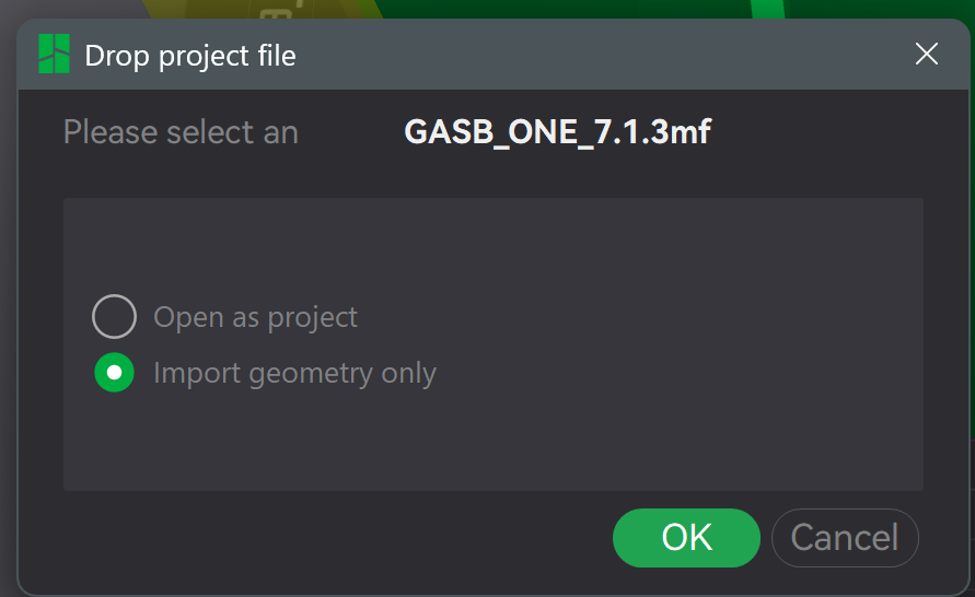

  1. Create a project with your default settings, and save it - for example, as default.3mf. You can use that over and over again.
  2. Then select “Import” and just choose “Import geometry only”

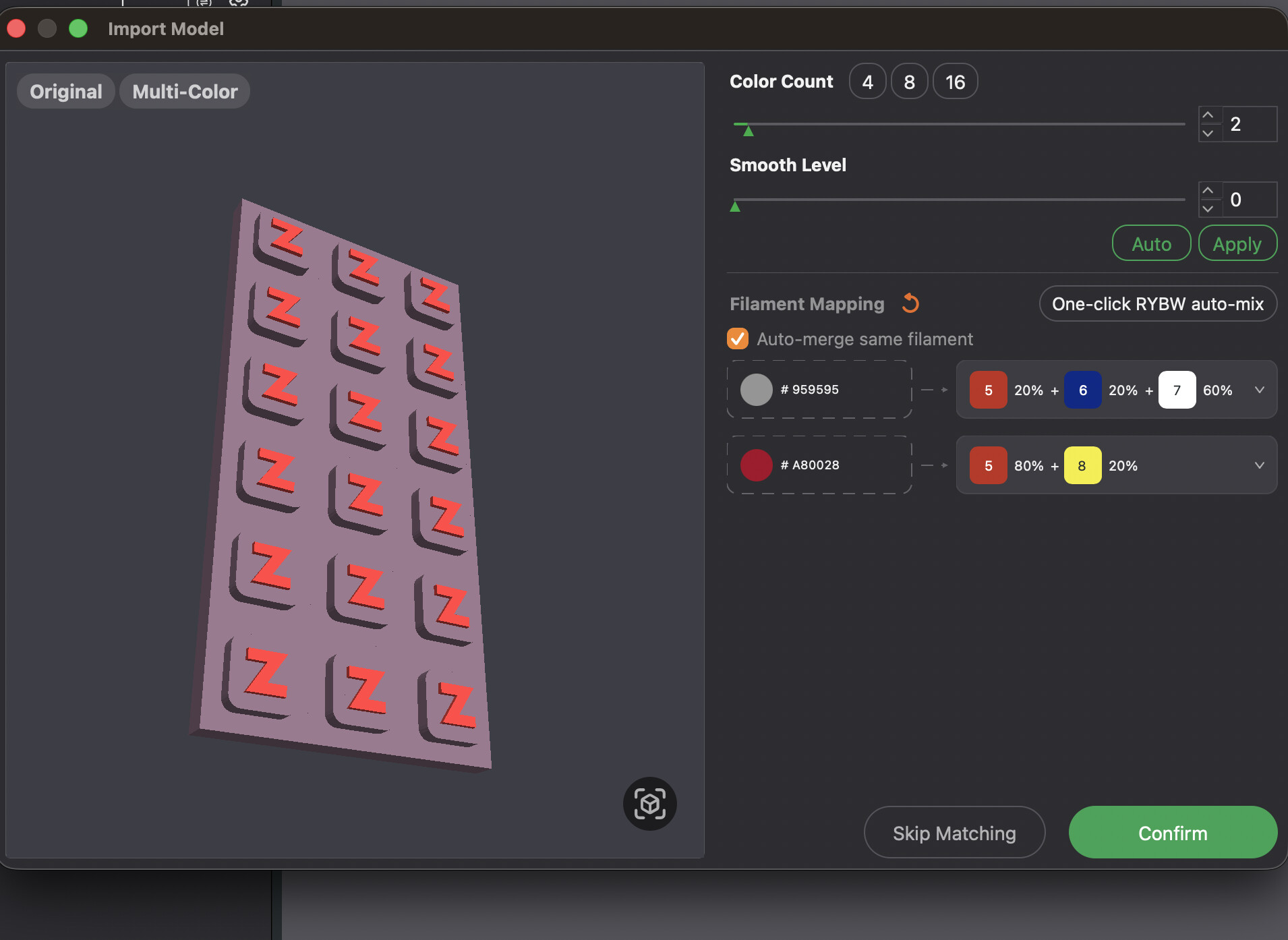

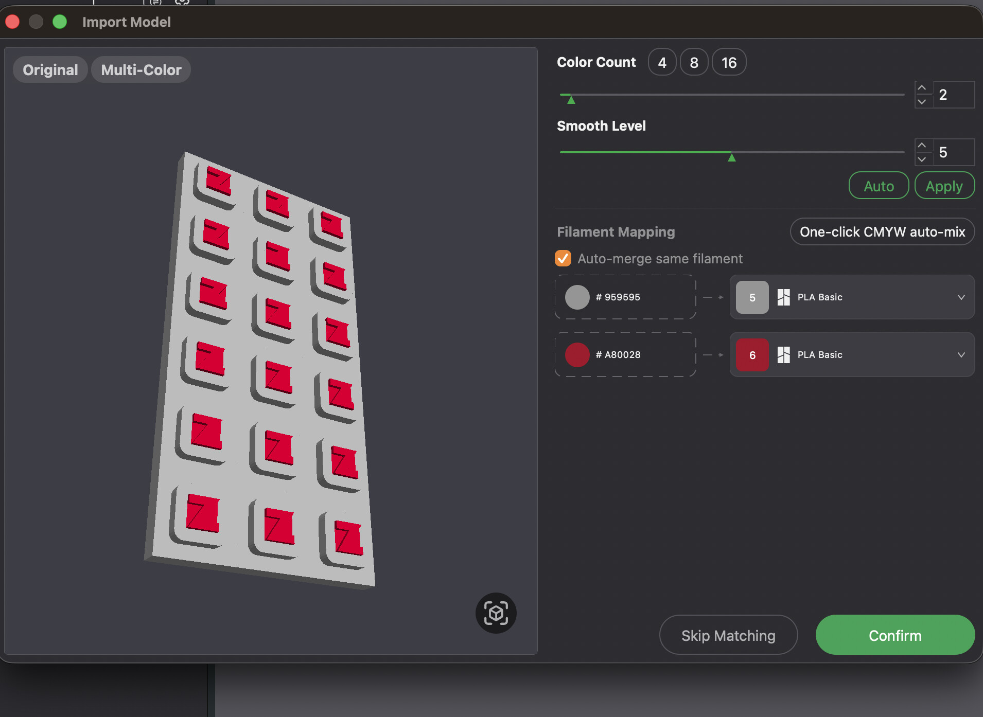

This window that pops up. I suppose it’s hard to understand if you get something different but this is what I get. I have to slide smooth level to zero…hit apply then fix the materials that keeps trying to add PLA matches
If I click the filament area to fix where to print it sometimes tries to mix colors to get the color I want instead of just matching to the red and gray petg I have loaded. Its just so close to being great that its super annoying.
Also if not done in the right order it wipes out what I picked for filament. If I could make it so that color #a80028 picks PETG red…and #959595 picks PETG gray…man it would be fantastic.

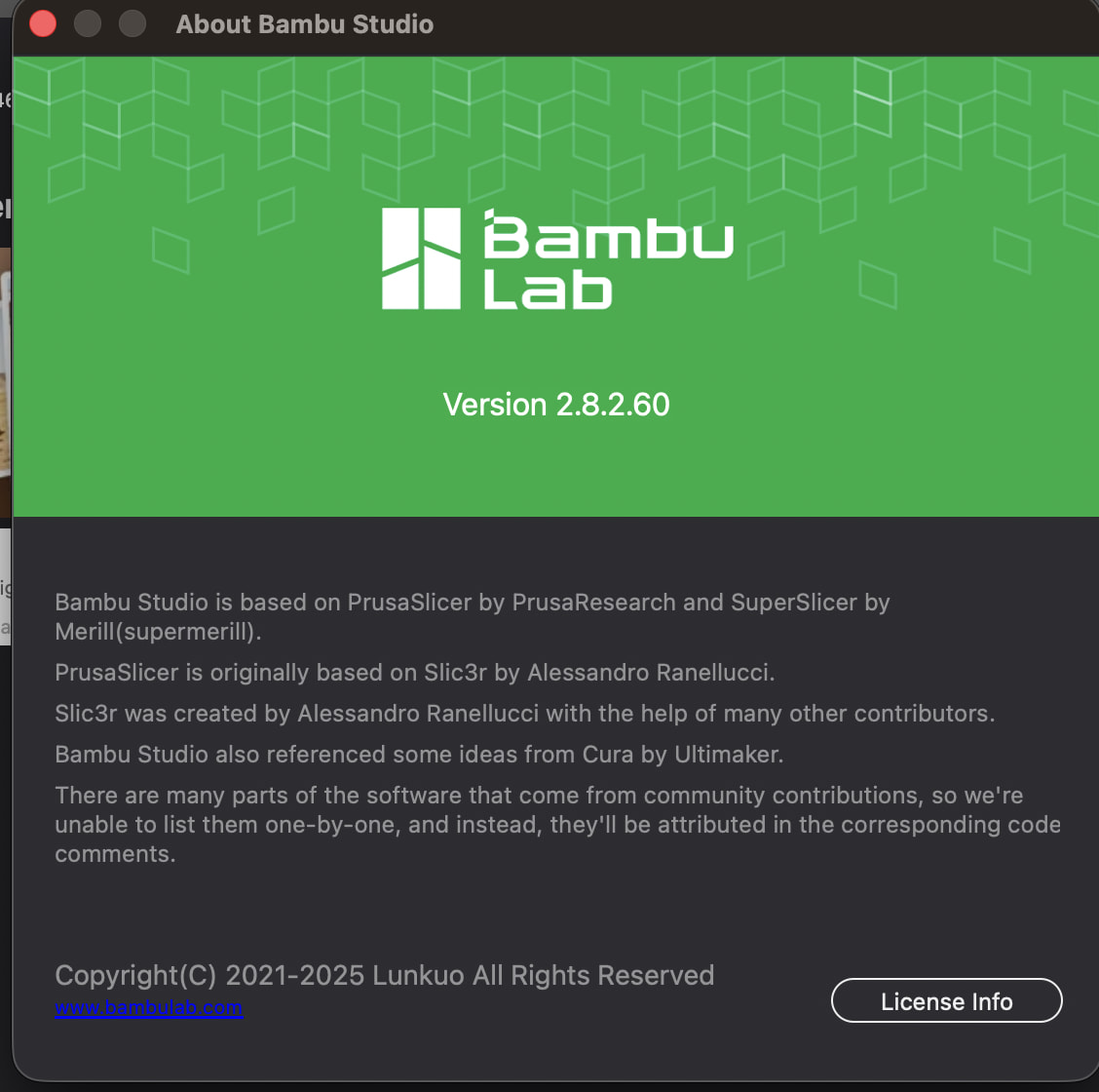

Lol its Bambu Studio 2.8.2.60

When there are true RGB colors attached to faces in the model that you are importing, it tries to map them into mixed filament colors. It can create up to 32 colors if needed.
