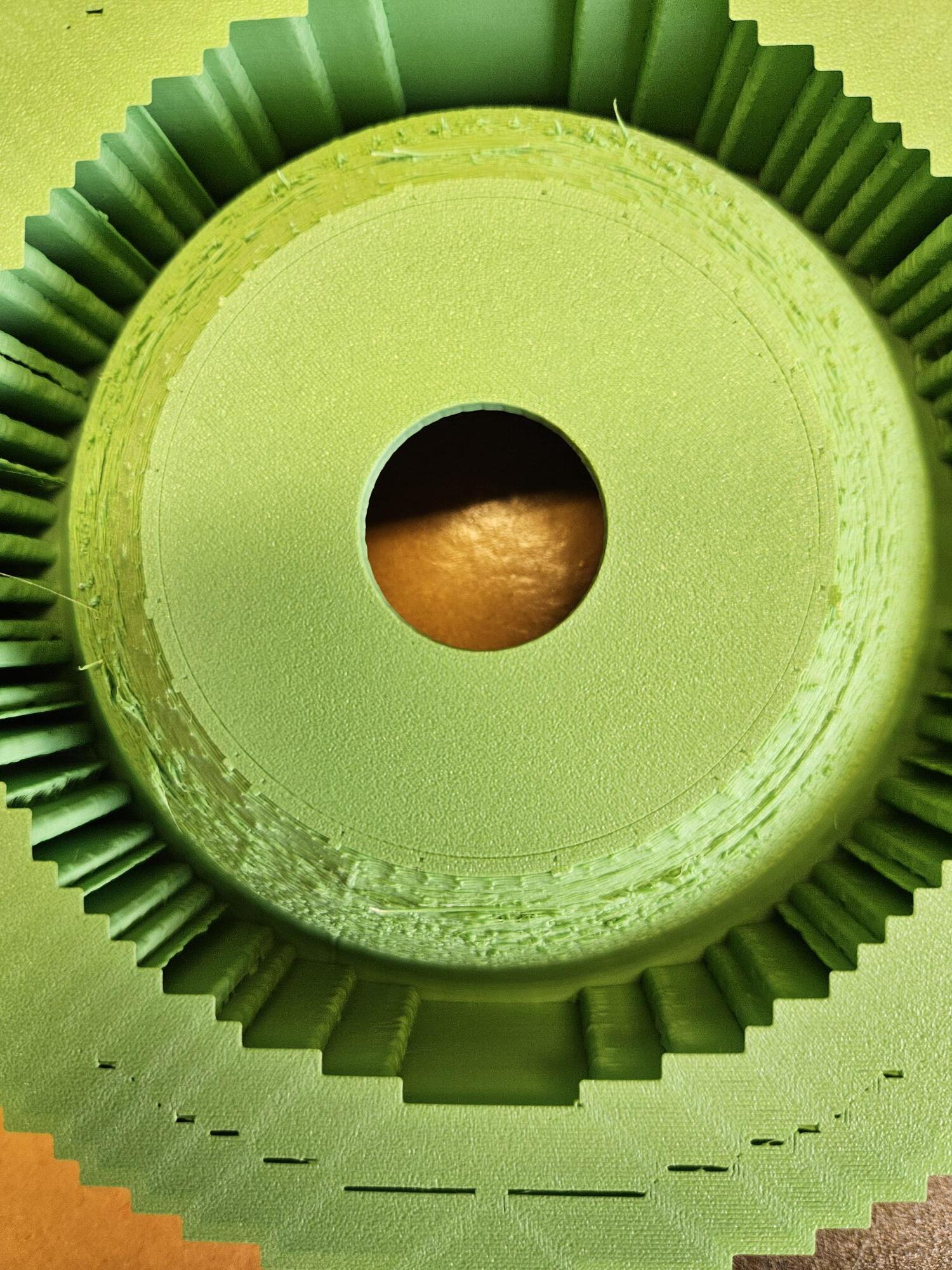

While I’ve been a reasonably happy user of my X1C over the last year or so, I want to do something about the print quality in certain circumstances.
This is a simple bowl I made in Solidworks. The rough bit is where the X1C puts in a bit of tree/auto support. You can also see where it’s a bit poor at the bowl rim (bottom)
The material is PLA Matte and the settings are all standard for printing at 0.20 Standard resolution.
Any hints will be welcomed!!

If you use adaptive layer height it will smooth out the stepping on those layers and probably wouldn’t need support.
Another tip is to avoid shallow layers by using a chamfer instead of a fillet.

Two things. You can possibly “reduce” not eliminate the sagging lines by increasing the filet radius to be more gradual. So in this example(I’m using OnShape) I create an asymmetric filet(Fusion should support this feature too). Figure 1, will produce too much of an overhang. Whereas figure 2 will produce less of an overhang which allows the layers below to provide more support and therefore less droop to the layers above.
The second thing is that you can experiment with layer height as was suggested. The adaptive layer height tool will allow you to vary the layer height by region. But this is a limited tool and whenever you reduce layer height you increase print time. You may also weaken the part or in some filaments like PC that don’t like small layers, you may even weaken or make the appearance worse. So it’s a double edged sword that has to be used where appropriate and appropriate is a decision you have to make based on trial and error. You can click on the “adaptive” button and allow the algorithm to ‘guess’ at what is ideal, or do it manually. Try both.

From what I can see, there are extrusion issues at the bottom which could be improved–not eliminated–by modifying temps and and/or flow rate. The model orientation may have more influence. Also, don’t expect great results from Bambu Matte PLA, as I’ve stated in other posts, on a scale of 1-10 for model fidelity, it is about a 3. I’ve had much better results with Overture, Jayo and 3DHoJor Matte filaments, 3DHoJor usually being far less expensive($13 or $0.37/oz).
I also see evidence of the walls being too thin. But I would be guessing without direct access to the model.
However, at the end of the day, you may be expecting too much of the technology if you feel your overhangs should look like your walls… gravity sucks and it is very egalitarian… it sucks equally for everyone… filament and people alike. :yum: Why do you think that Resin prints looks so great? They print them in a liquid bath hanging typically upside down at resolutions that are 4-8x than that which can be achieved with FDM technology without the sag. So why doesn’t everyone use resin? Because it’s got really bad fumes and must be used in a well ventilated area, it’s messy, more expensive, a whole lot sloooower and the prints are best suited for smaller objects–not functional parts–that one paints afterwards. In other words, Dungeons and Dragons figurines or artistic pieces. You can do some very cool thing with resin that you just can’t do with FDM but on balance, FDM is much easier to use in my limited experience.

Thanks for uploading the file, this really helps cut to the chase and eliminates all sorts of back and forth speculation. It took me two seconds to spot the problem.
Disclaimer: Please don’t take this as criticism of your model if you are the designer but hear me out and look at the options we all have when designing for optimal 3D Print.
Unfortunately, this is about as 3D Printer-unfriendly a shape you can get. This is an important lesson of starting off with an optimal model. It’s easy to get caught into visualizing a piece of plastic that we may have seen as a piece of pottery or a molded piece of plastic in the supermarket but unlike pottery and molded plastic, with FDM, we have to deal with gravity and that where you’re seeing filament sag and supports producing a print that is not ideal.
If I were designing this type, I’d keep it simple.
No lips or edges.
Here’s a side by side using admittedly a very quick and dirty approximation of your object which I did quickly in a few minutes in OnShape, this is not optimized by any stretch but it shows what just a few simple changes can make. This was a shape set 156x156x39mm, which was the gross dimensions of the original model.
Here’s what it slices to. Notice that the slicer did not see the need for supports. Please note that I have not printed this, there may be more tuning but the shallower lines will already produce a no-support print.
And just by adding a 3mm fillet to the bottom of the bowl causes the slicer to want to add one layer supports which will mess up the smoothness.
Now if you still want to get that “Injection molded-like” appearance. Then you can either reduce the layer to something finer at the cost of triple the print time. Or simply use variable layer height and only focus the finer filament layers to the top and bottom curves.
Also, note the difference in time and filament between the original model and the simplified model. This is because supports require a lot of time and filament.

Reason for that shape is that it’s what the customer brief states. There’s several parts to this whole contraption but I have a few days until I have to show a prototype. I have a company in Shenzhen that I use and if I paid him about A$8k, he’d injection mold them for me by the thousands!!!
I’m a Design Engineer, BTW. To me the Bambu is a tool of the trade but, having said that, it’s vital it understand what/how the tools work. Off topic, if you were choosing another printer (apart from Bambu), what are your thoughts?
