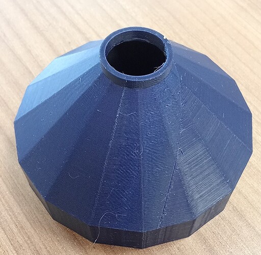

Hello everyone,
I am printing small funnel on P1S (w/ AMS 2 pro) and print quality is decent. Only issue I have is on one side of the funnel where there is certain trace where the print isn’t as smooth as on the other parts. I’ve been adjusting parameters a bit but still cant get rid of it. Filament is Bambulabs ABS (navy blue color). In the pictures you can see how the print looks from the outside, inside and slicer screenshots of flow and line type where you can see the trace shown. I have also added 3mf file. When I saw model being printed I think I noticed it is happening when the next layer is being printer (extruder is finished with current layer, changes direction of rotation and prints next layer). I am not certain though. If you need any specific parameters let me know and Ill post them too. Thanks in advance for all the help and suggestions!
FilterBot_ABS_Modri.gcode.3mf (5.1 MB)
Try printing it “upside down”. It will not require support.
It does not print support now either, angle is not above 45 degrees.
Yeah, but the base will be wider and vibrations on model will be minimized.
Ah ok gotcha, I thought you meant the rough surface is because of support, my bad. Ill try to print it upside down and update on the result.
Lijevak mali_Modri_1.gcode.3mf (2.0 MB)
Unfortunately nothing changed, if anything the print is worse. Also completely forgot that another reason why I cannot print it the other way even though the base is wider is cause there is a small platform on the inside where the incline ends and straight part going up begins. It is used to hold another part that will go on it, and if I print it like this it requires support or it looks bad, probably can be seen on picture of the inside of the funnel that it has some small bulges now where the paltform is supposed to be.
