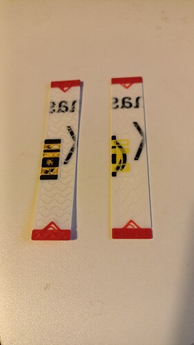

Bottom view of partial print:
Top view of partial print:

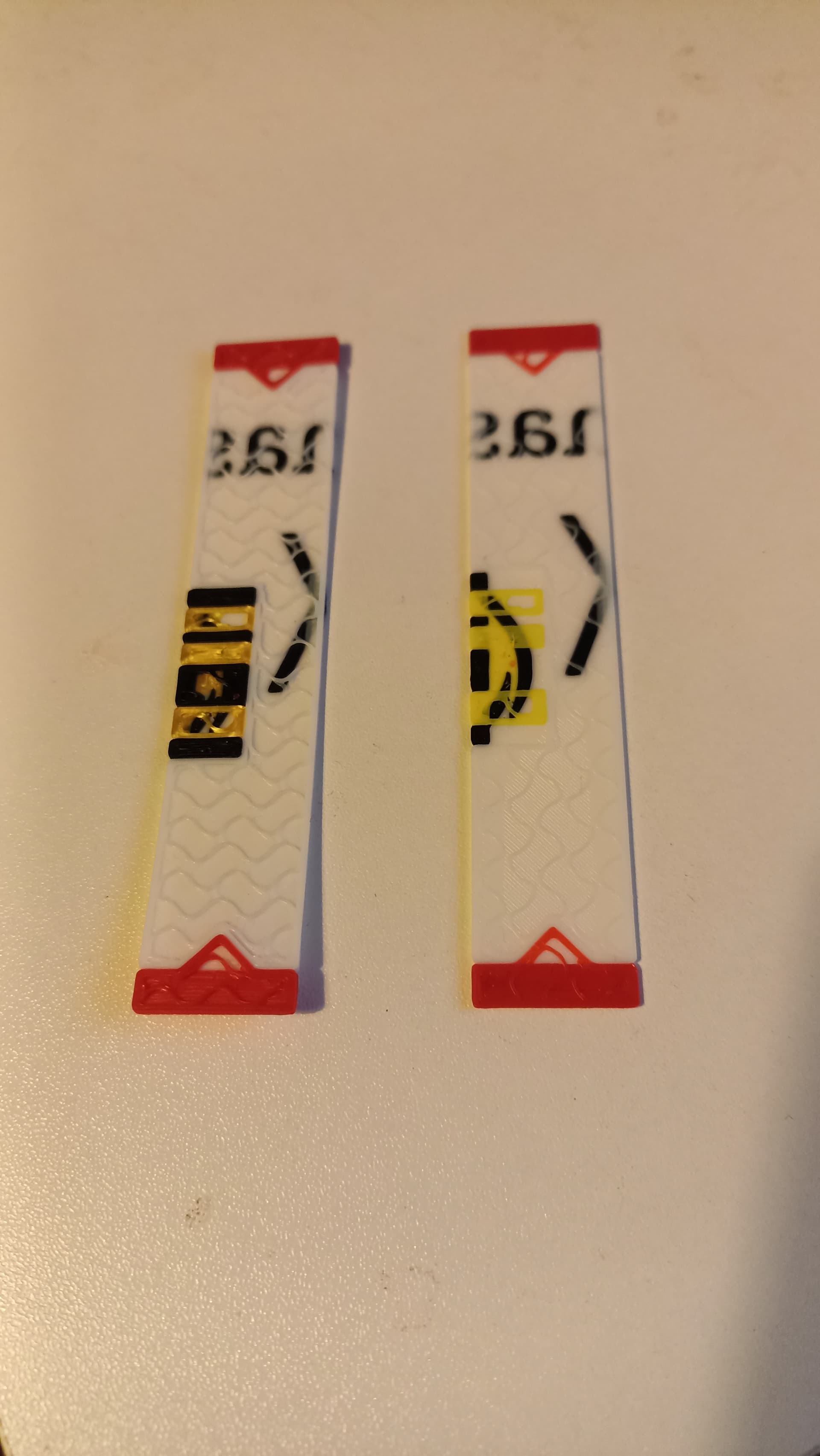

I don’t understand why the black and yellow/gold has been printed like that on the layers above the first - another setting I suppose? The rectangles are visible from the underside which is not wanted. Same with the red triangles. Could these artefacts be related to the problem?

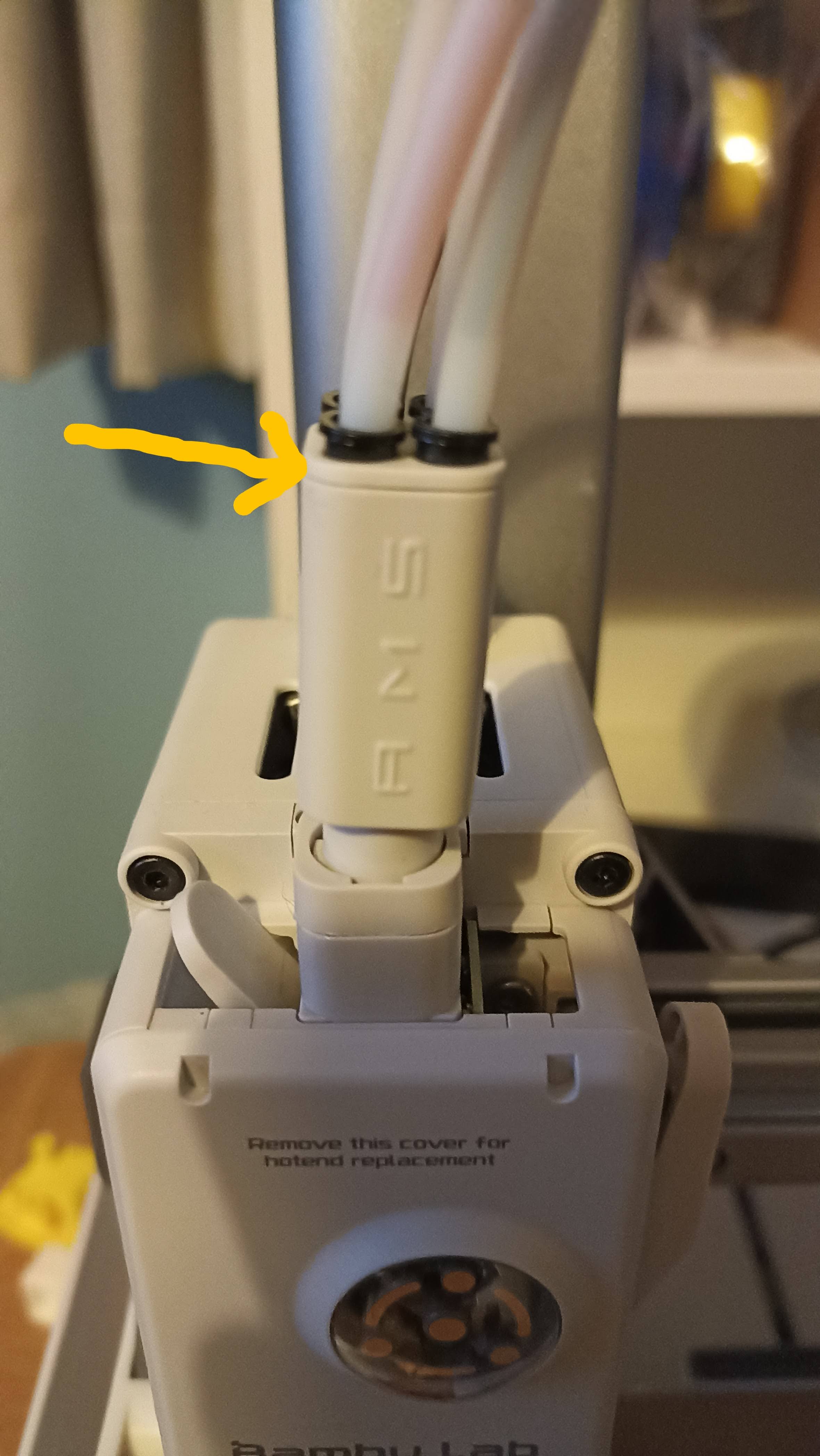

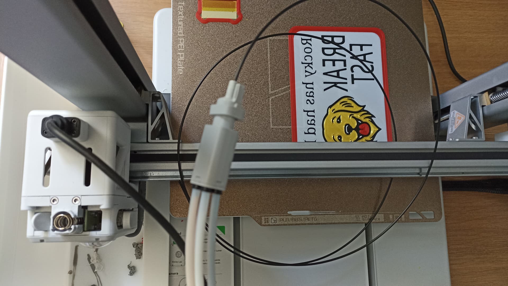

Photos of the filament leaving via a route you said it shouldn’t.
I do! I was just adding them to a comment when you asked. Please let me know if there’s anything else I can add. Unfortunately I don’t have a picture of the printer when the tubes came out, but I can try to describe it better if needed!!
A photo of where it came out would be great.
I have a condition called aphantasia which means I can’t form visual images in my mind. Photos help me work things out.
I can at least mark the spot on the (intact) printer. Where my yellow arrow is, that top square of white plastic had come out of the cuboid it’s inserted in. It seems that so much filament had been pushed through the tube, with nowhere for it to go, that this part just popped off. And then another 50cm or so of filament continued to be pushed by the AMS.
Of course I then checked for a blockage and didn’t find one, but I think it’s relevant that I was able to print something else successfully afterwards, using all four filaments, so I think that means there’s no permanent blockage, at least.
Ah yes, understood. If the image I’ve added isn’t helpful enough for that reason, I can start the print again. Either it works (hooray! But I’ll still want to understand it), or it doesn’t and I can take a picture.

As you advised, I’ve fiddled with the filaments this morning - I suppose my original model had two slightly different versions of the same colour (looked like the white when I checked it just now). When I sliced this time, the prime tower was on the plate, which is a good sign! I did move it onto the plate manually last time, but the fact that was necessary was a concern already I suppose - if the slicer can’t get it in the right spot, something must be wrong.
I set the sample printing again last night, hoping to get a breakage picture - no breakage. So I risked running the full print overnight (without the filament fixes you’ve just mentioned) and it came out fine! Which is good, but annoying from a diagnosis and understanding perspective.
Examining the finished product, there’s some roughness on top, and that jogs my memory - it’s possible I had turned on ironing of the top layer when I tried before. It wasn’t the top layer that failed though, so I don’t know how relevant that is. Now a little nervous to try ironing in future!

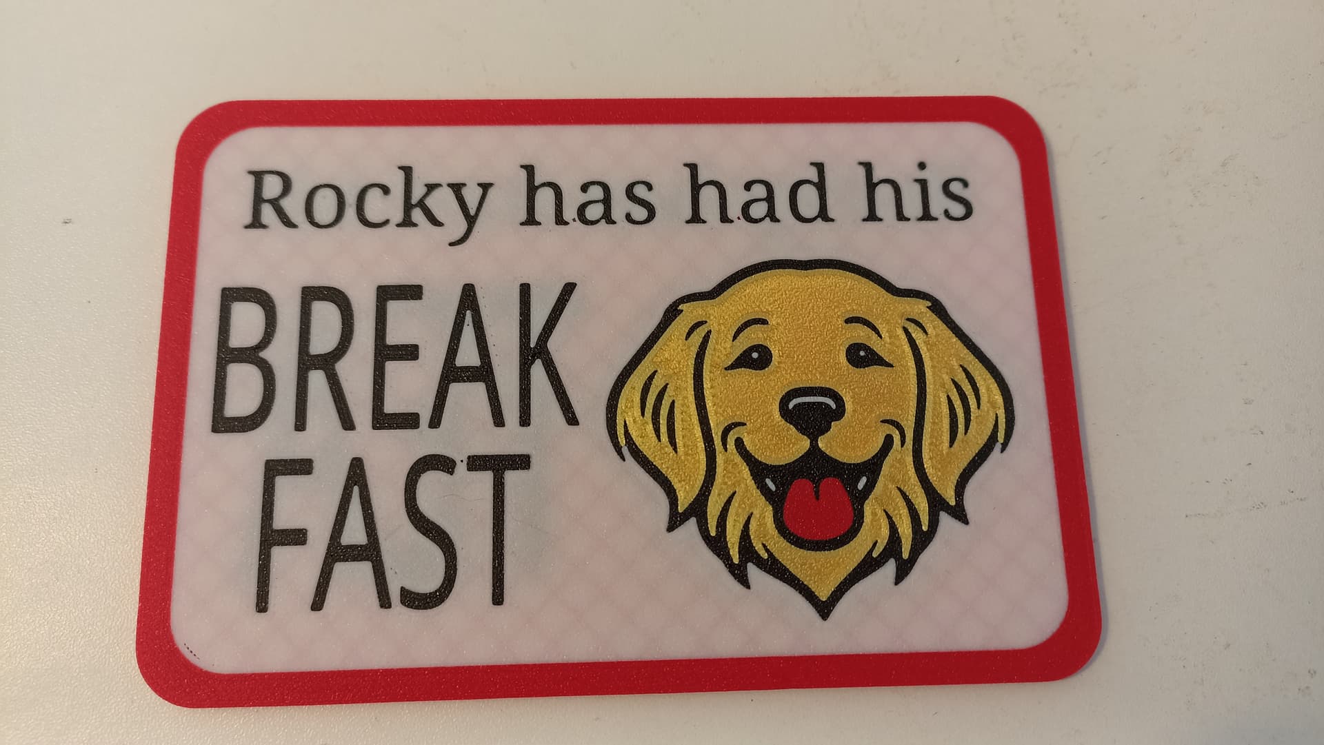

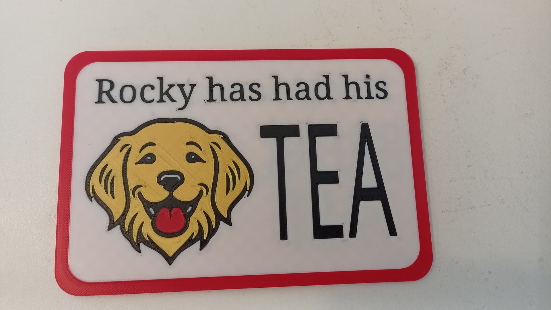

I have one more question, about the successful print (photos below; dog picture is based on an SVG from Tibbixel). The model is solid red around the border and solid white through the bulk of the body. Why then is there red cross-hatching? Can I hint to the slicer to use the white for that (presumed) infill instead? It’s most visible on the breakfast side, which is the bottom of the print.
Thanks again for your attention and help! I am enjoying learning about this hobby.

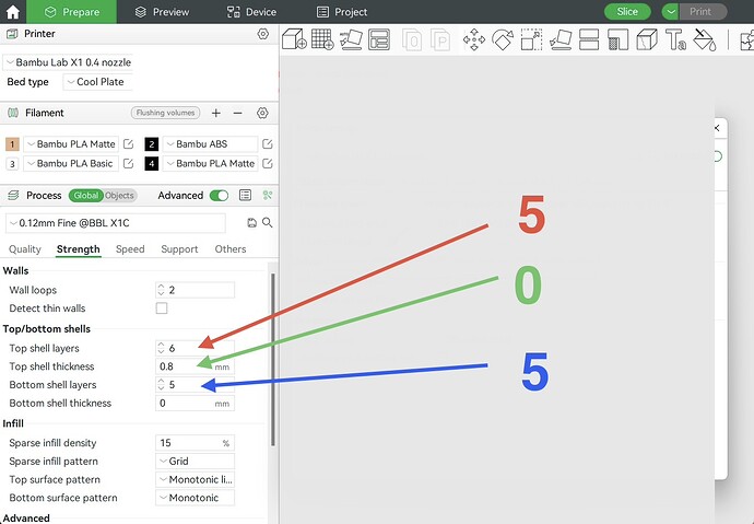

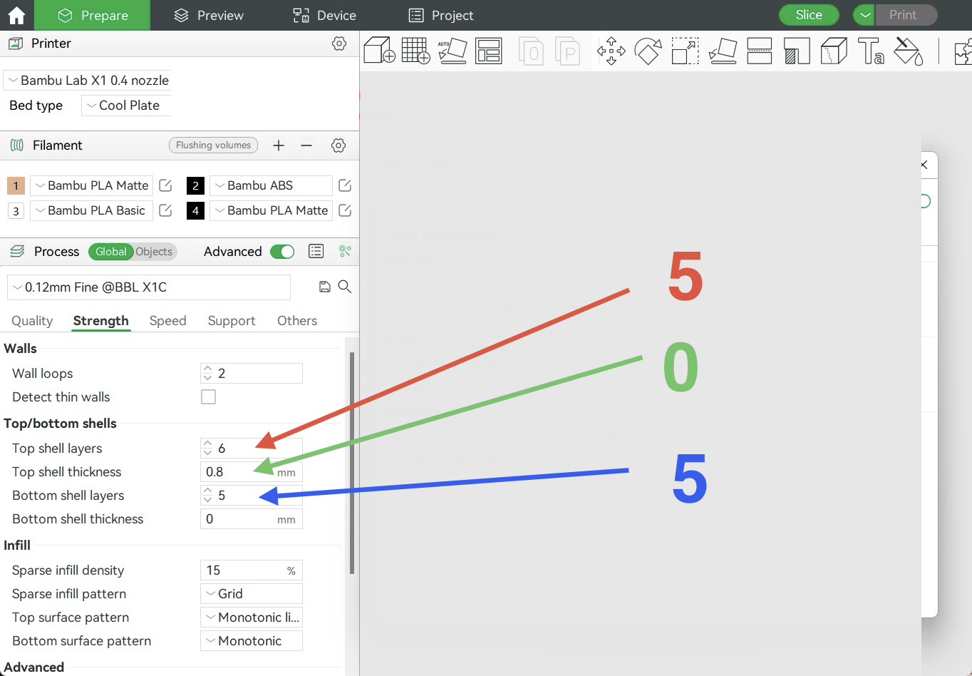

  • Top layers in red, set to 5.
  • Make sure the top and bottom shell thicknesses are set to zero. If not, it will ignore your choice and use this value.
  • Bottom layers in blue, set to 5.
A value of 5 with a layer height of 0.2 will be 1mm thick. 1mm should be considered the thinnest for white material in order to height any colours below it.
You also have Walls, not important for this project, but knowing it helps my next point. Walls is the number of solid lines around the edges of a model. Again, irregular shapes have walls that wrap those irregular shapes and they do so from the bottom to the top.
Infill, is everything that isn’t walls or shells.
Right, got it. Interestingly both of my top/bottom values were already 5, and the thickness was 1mm (which matches 5 x 0.2mm layer thickness). However the “Bottom paint penetration layers” value was 3 (vs 5 for the Top) and the red infill is more visible in the bottom. I’m trying again then will reprint the full coaster (which has a thickness of 3mm, whereas my sample has only 2mm, so in fact I can afford to increase the paint penetration a little more on that one).

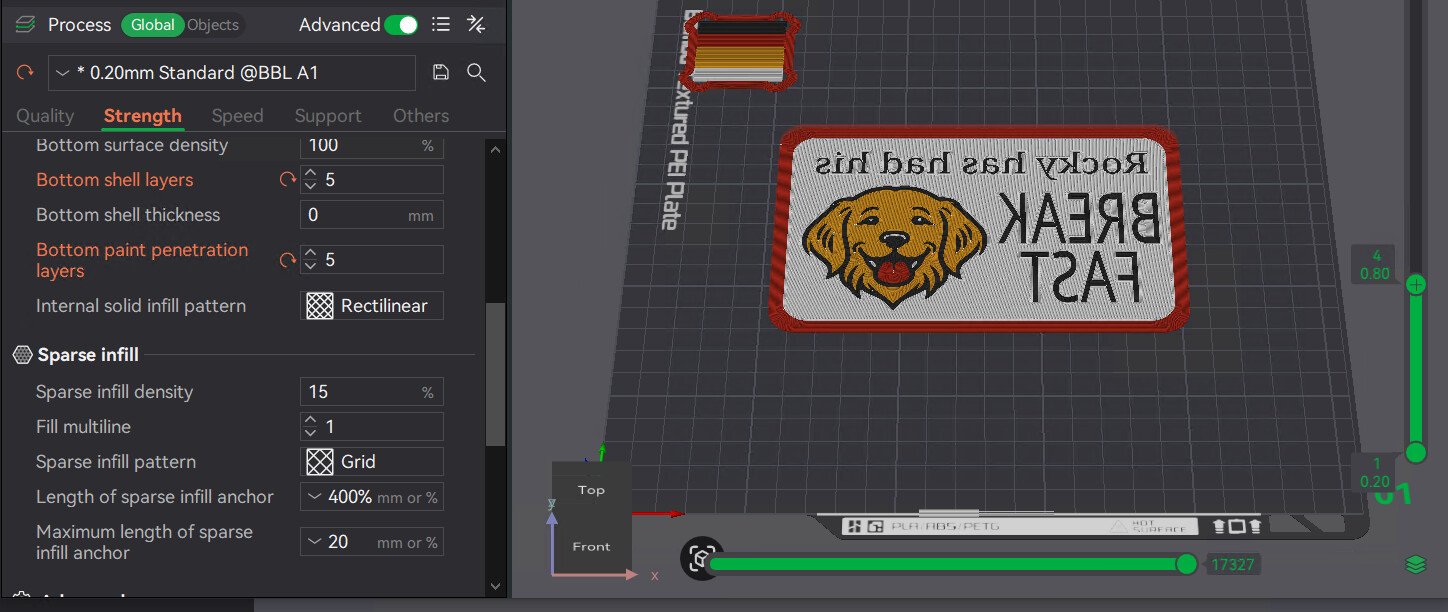

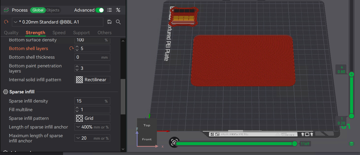

Unrelated to your activities here.

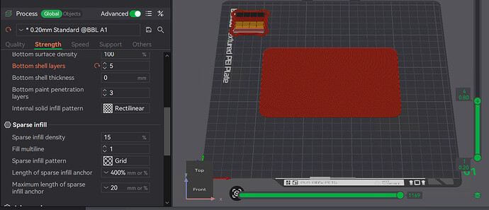

Sorry, my imperfect understanding again! When I change “Bottom paint penetration layers” between 3 and 5, slice the model and inspect layer 4, I see different results.
  • With 5, the colours from the bottom layer are visible on layer 4 (and 5, but not 6).
  • With 3, the colours from the bottom layer are replaced by solid red on layer 4.
Well, despite a successful print of the full model a few days ago, and successful prints of the sample section with new settings (filament order, and change to paint penetration), I’ve had another failure.
The assembly came apart at a different point, but the principle is the same: the AMS was pushing filament which had nowhere to go so the assembly popped apart, and then it continued to push filament for a while.
Since this has been intermittent, I think it’s time to contact Bambu support. Thanks for your help, @MalcTheOracle .
