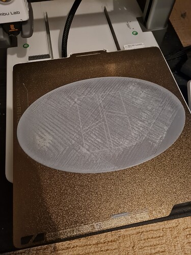

Hi, I’m having some issues on an A1 which I cannot seem to resolve. I ‘think’ it’s the extruder not gripping the filament properly. I sometimes hear rhythmic clicks on larger prints on the bottom layers like it’s slipping. I had an issue with this printer not long after I bought it where it would stop extruding half way through a print for a few layers then start extruding again. I fixed the issue by loosening the tension screw on the side of the print head. But now, some months later I have this issue where it seems to be struggling to extrude at a consistent rate. On smaller prints the bottom layer seems to be ok but then layer 2 upwards go bad. On larger objects the first layer starts ok for the first 10% then goes bad. Anyone have any idea what’s happening here?

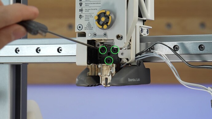

Check the three screws behind the hotend they can work loose and cause issues and if you say you’ve had the hotend and extruder apart that might be a reason
I will try that, thanks! I had heard something about screws being loose but I could not find anything that showed where they were. I’ve never touched those screws though so if it is that it’s a factory issue!

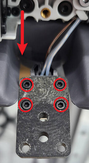

You need to take out those 3 screws completely, and gently fold the black block down towards you. There will then be 4 smaller screws on the back of that block responsible for holding the nozzle holster down. Those ones are the ones to check.
is the link to show you where to go
Did you mean on the actual back of that block? or just behind it? Because I just removed the block and tightened all the screws that it was covering. Testing now(2 of the screws were very slightly loose)
I mean the back of it. That block has a total of 7 screws, 3 accessed from the front to remove completely, and 4 on the back of it that are not visible till you take the 3 off and gently fold it down [wires are attached - hence gentle]

oh em gee guys!!! it worked!!! I’m shocked!!! you just saved me a printer!!! Thanks!!! :grinning_face_with_smiling_eyes: :grin: :smiley:
Perfect first layer!!! I really did not think this would work as the screws only turned a tiny bit.!!!

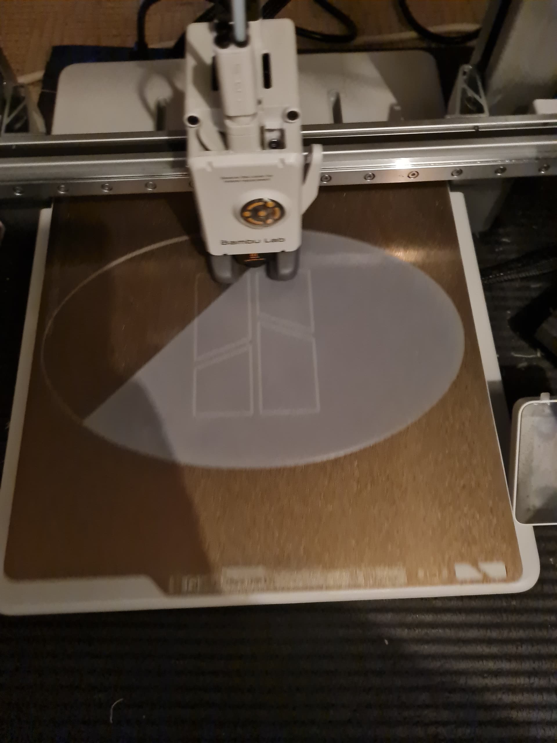

The second layer was bad though and it started clicking again once the speed picked up :frowning:
So, I did as you said and took it off again and tightened the 4 screws at the back of the black block(they were pretty loose) and viola! second layer is perfect as well, and… No clicking. I had mentally given up on this printer and was planning when to buy another etc, so thanks!!!

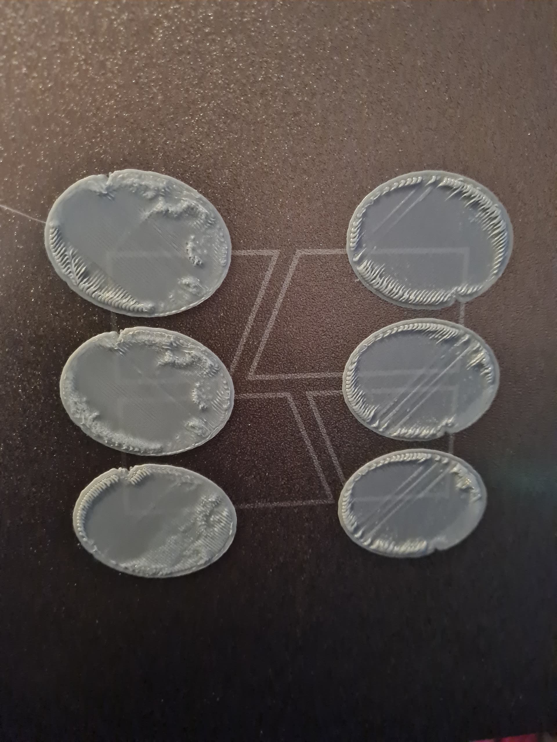

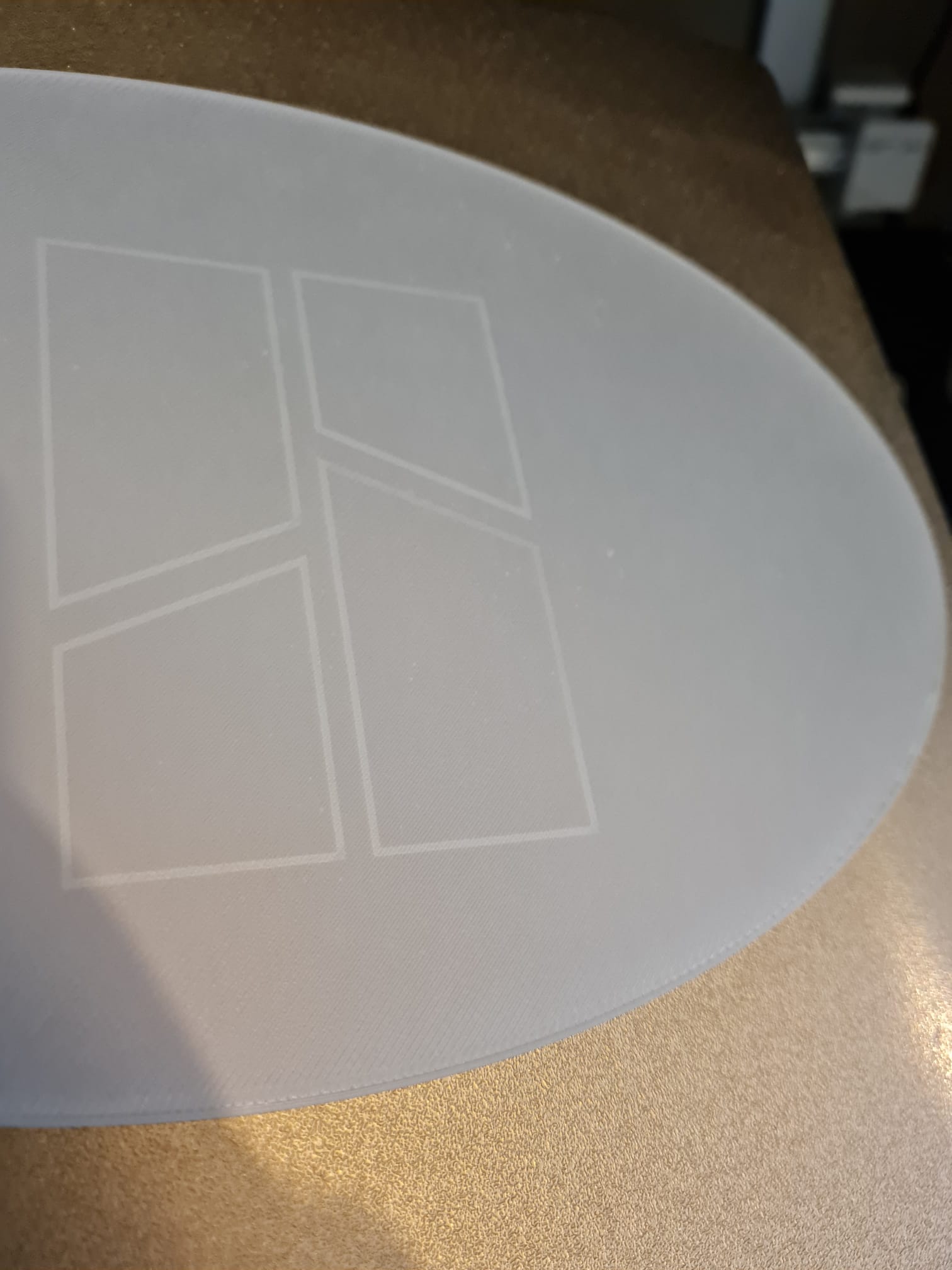

One last update for anyone else with an A1. All 3 of my A1s had this issue, though on the other 2 it was not enough to seriously affect the quality of the prints(yet) so I’m guessing this is a common issue on the A1 and worth doing if you have one. The best way to check if you have an issue is to start a print with something that has a large surface area and if that first layer is not perfect, good chance you need to tighten these screws. All the ones the black panel is covering and the ones on the backside of the black panel itself.
Other printer before tightening:
After tightening:
