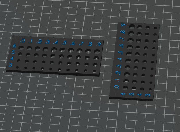

I have a ticket opened with support already but the replies are very slow so I wanted to see if anyone has any experience dealing with this issue. Below is exactly what I have on my support ticket and I am at wits end trying to solve this issue.
TLDR: We got a H2S, outside dimension’s can be good on square blocks but holes are all over the place (0.3-0.5mm with no consistency on sizing in both X and Y so off setting doesn’t help) Have tried both PLA and ABS, external slot and in our AMS 2 with no luck. Have ran through the H2S wiki help and have done the belt tensioning step and tightening the hot end bolts as requested by support (Still waiting to hear back) with no luck on problem. Problem does not exist on P1S with same model.
Any help or insight would be appreciated. Thanks
Support ticket info:
We recently received a H2S unit and have been having issues achieving good dimensional accuracy when compared to the p1s. Attached in the image is the print we have been using to test. On the p1s we are getting a consistent accuracy of ~0.1mm, while on the H2s the accuracy is anywhere between 0.3-0.5mm with no consistency.

  • Printing parts in different orientations (as seen in the image)

You say, your dimensions go all over the place. So what are your results on the given test prints?
Do you see the deviation get less as the holes get bigger? Because that is common in FDM printing if this is not compensated.

It will depend on the hole diameter being measured for instance the first 6mm hole was reading 6.4 but the 5mm was reading 5.5mm, the 6.2 was reading 6.4 and the 4.7 reading 4.4 etc. The next few prints had the same sizing issue but completely different to the first print i.e 6mm was now reading 5.8 etc. This is what has been driving me crazy, the complete lack of pattern.
No actually it stays consistent in its randomness. My 6.9 mm hole is reading 6.44 in x and 6.61 mm in the Y. The 5.9 mm hole is 5.3 mm in X and 5.73 in Y

If you have deviations of 0.4mm in X and Y you ether have an issue with your motion system (but your square block outside dimensions say otherwise) or you are measuring a seam in one direction. You could try to rotate the caliper a bit to avoid the seam.
You could try to add a scarfed seam. Make sure that the filament settings have scarfing enabled on inner and outer contours.
It is a known phenomenon that small holes tend to get smaller, and the deviation increases, the smaller they get. Imagine pulling an elastic band around. It tries to take a shortcut.
But some of your holes are bigger and others are smaller. That is really weird. Unless there is some excessive correction activated for holes.
It would be interesting to test a similar model, but now with square holes to see if you are measuring the same deviations.

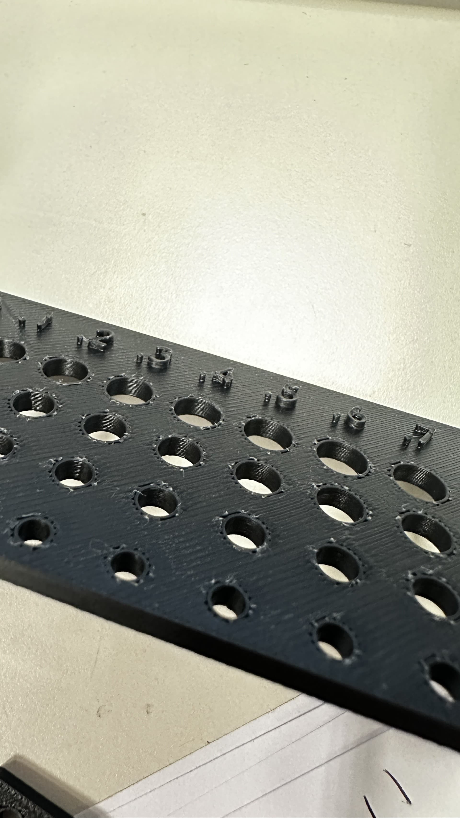

Can you make a close up image of the inside of the printed holes? Are the surfaces looking smooth?

Surfaces look smooth internally. Im pretty sure this was printed with default settings aswell.
