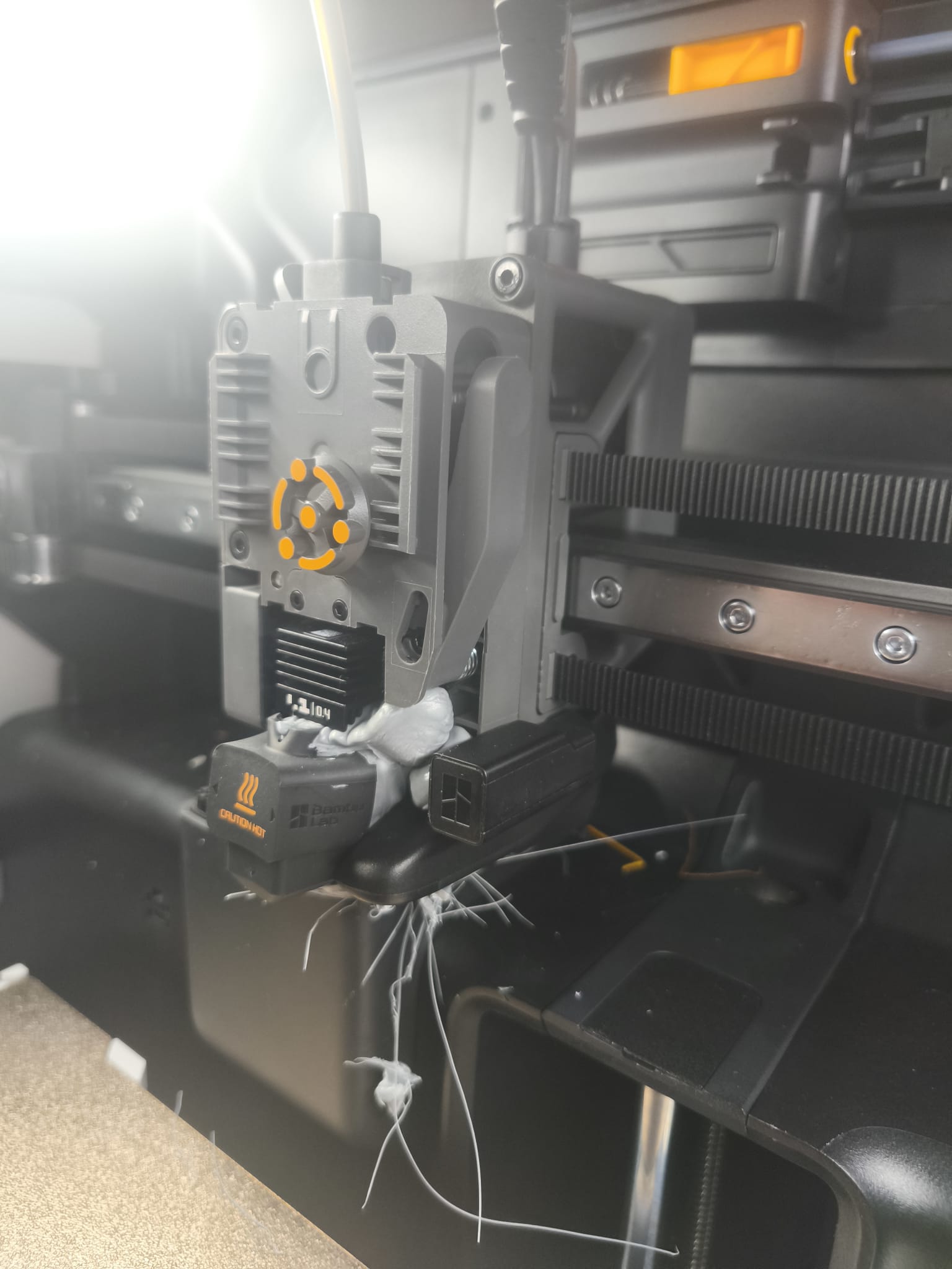

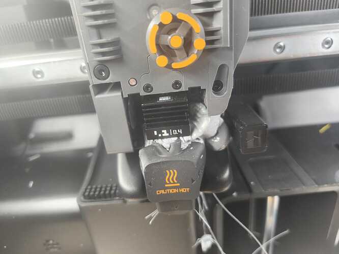

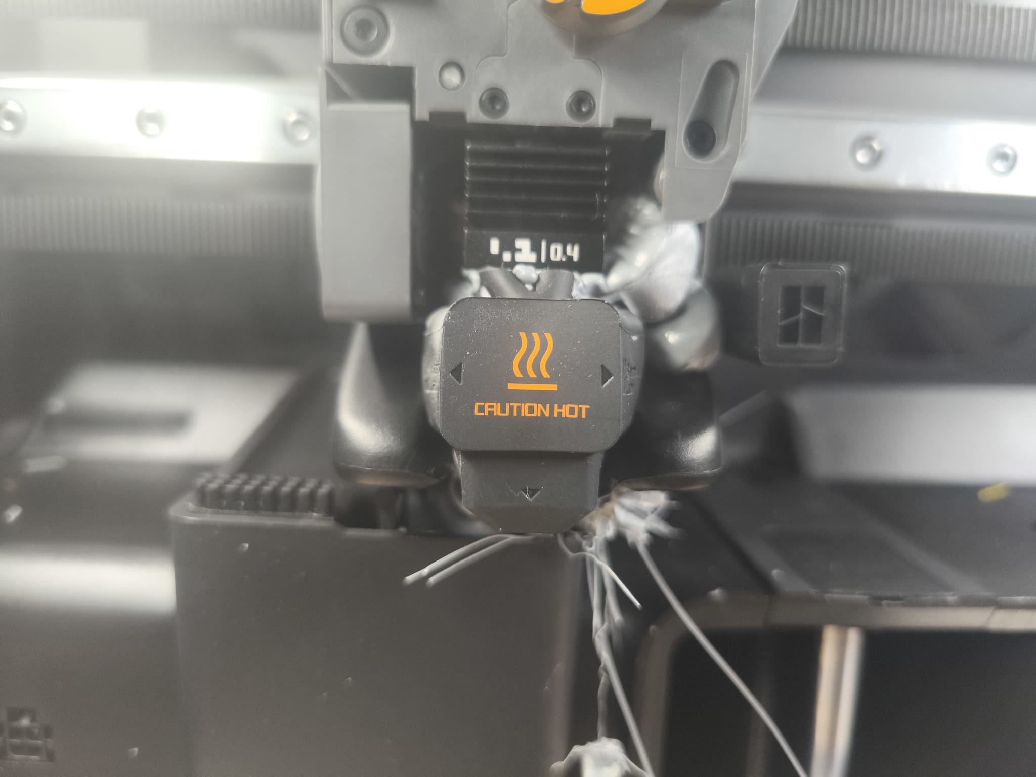

But the other night I left a print overnight, and found a disaster upon checking the next morning.
Images below should how the filament clogged up the extruder.
I was able to slowly break away all the pieces and eventually cleared all the clogging, and continued printing afterwards.

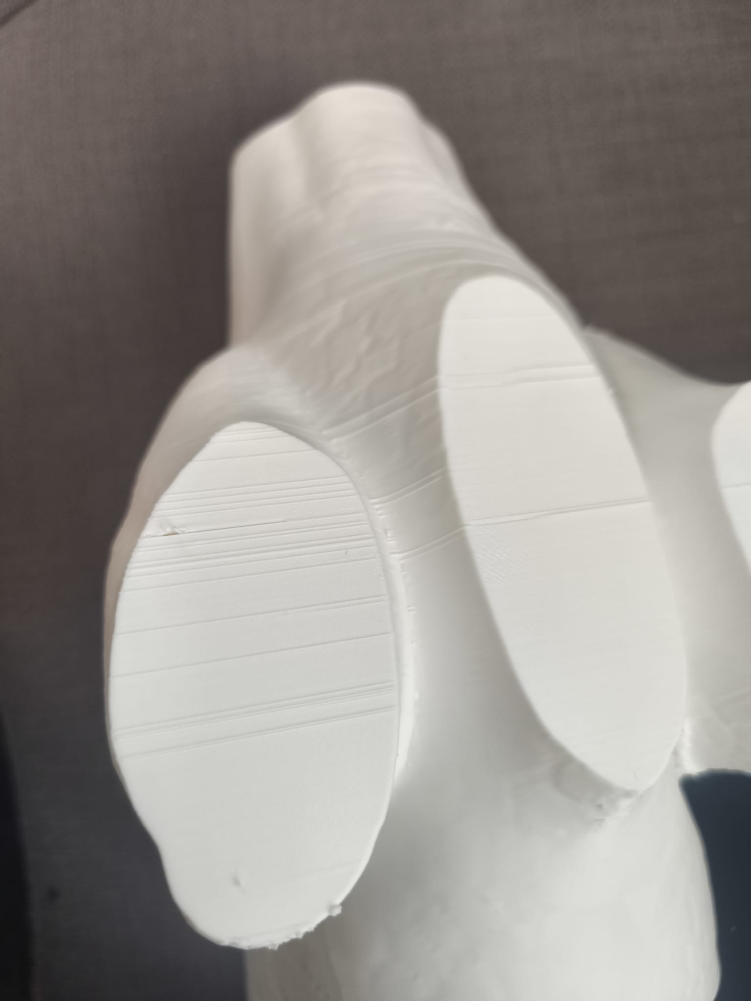

But now the printer seems less reliable. About half of the prints fail, either knocking supports over, spaggiti.
Some prints are fine, others just keep failing.

That doesn’t look like a nozzle clog so much as filament escaping from somewhere it shouldn’t be coming out of.
….and I wouldn’t have tried “breaking” that away, I would have heated the nozzle back up and let the whole thing soften then try to pull it off as one piece. Less force gets exerted on the print head that way.
