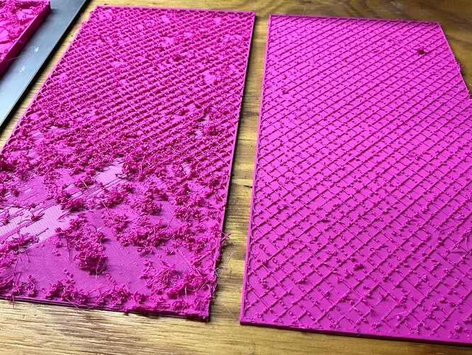

After being pleased with my string test I started my first large print (I have may) expecting all to be well. Below shows the reality I was confronted with. The print was halted by the Lidar detecting the spaghetti. The infill was set to only 5% here in an attempt to save filament on such large objects.
The picture below shows a couple more attempts where I started printing only one of these objects at a time. On the left I had raised the infill to 20% thinking that would give more bulk to allow the infill to stay connected. Then it became apparent the infill was simply not adhering well to the layers below it.
On the right I think I raised the hot end temp a bit after the first layer. But once the print got to the infill it was obvious that was not going to help so I stopped the print.

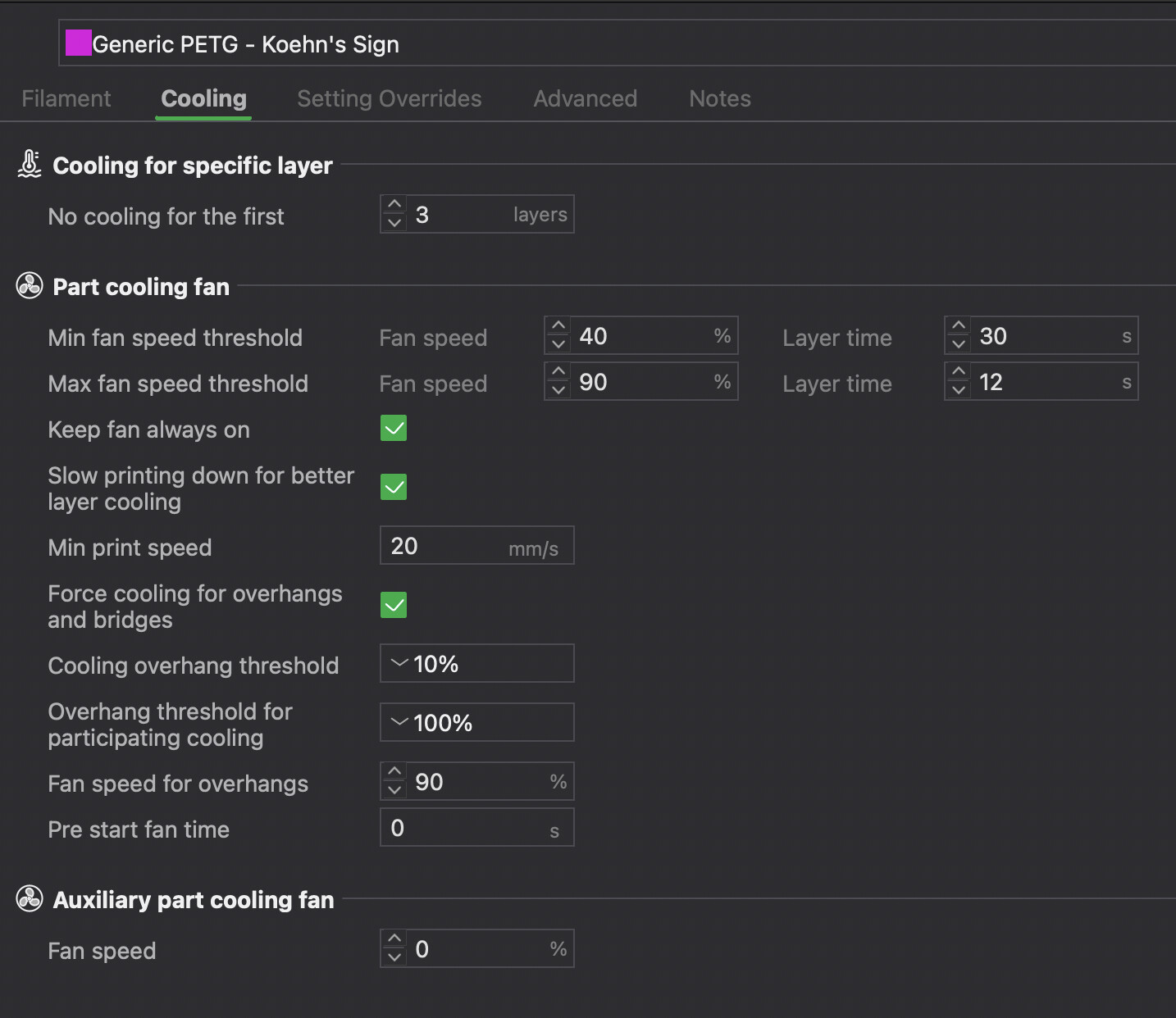

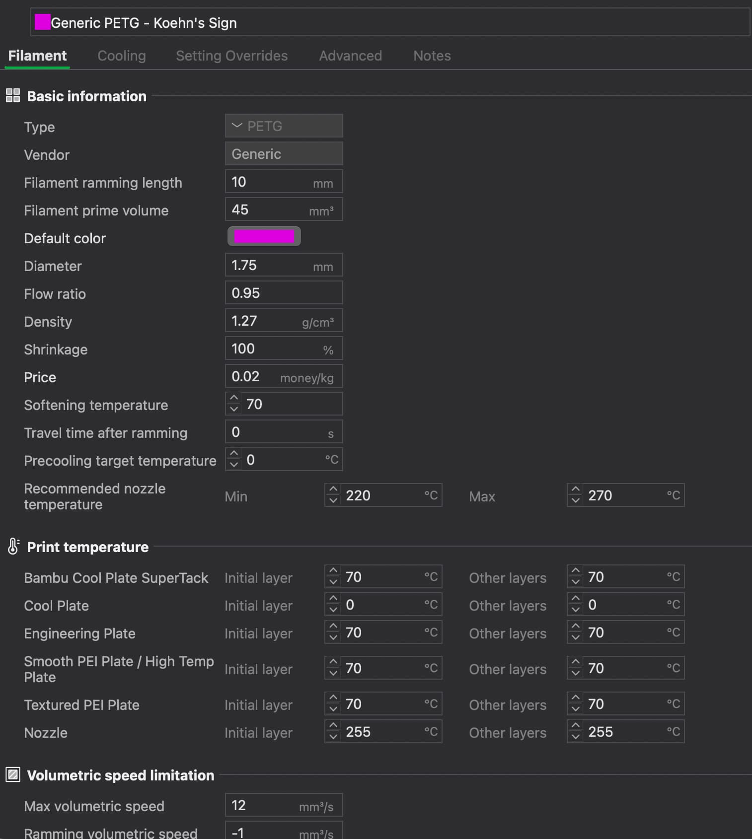

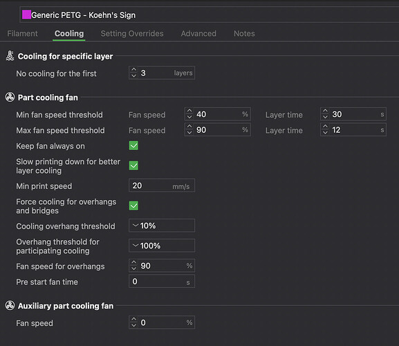

Here are some screen shoots of the Filament settings I feel may be needing tweaked:

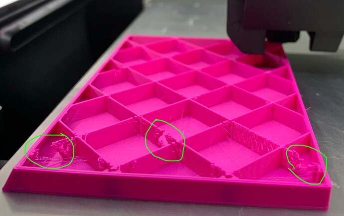

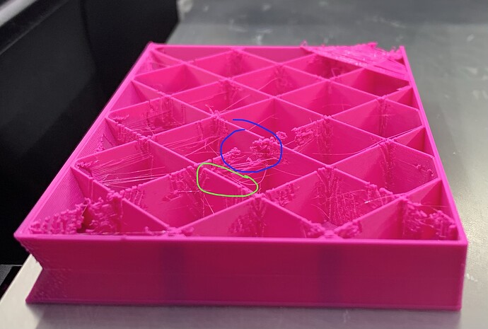

As an update… I adjusted the “Cooling for specific layer” perimeter in the Cooling area of the filament setting. I set it to no cooling for the first 100 layers. This would keep the fan off while the infill was being printed. Then the fan would turn on again when the top layer was being printed. While this printed better… It’s evident below there were still a few areas (circled in green) where the infill still did not adhere to the bottom layer.
In this second pict the printer entered layer 101 and the fan was aloud to run again. But it’s interesting to note at least one infill area had closed and another area had opened up (circled in blue).

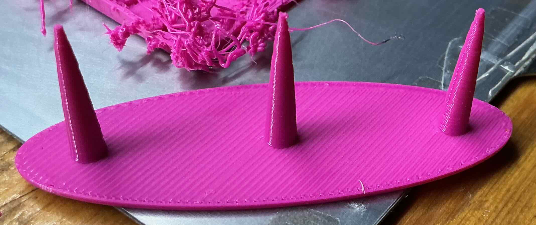

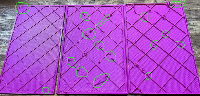

All the prints above are using a .4 nozzle. Below I tried slowing the printhead down to 50mms in the left panel. The middle panel is showing an attempt when using a .6 nozzle to try and speed up the print. In the right test panel I tried a bit slower. This is the same magenta filament from DURAMIC 3D I’ve been using about, the location’s lighting was just a little different. Obviously I’m not getting this infill to still to the base layer well. Any ideas would be appreciated.

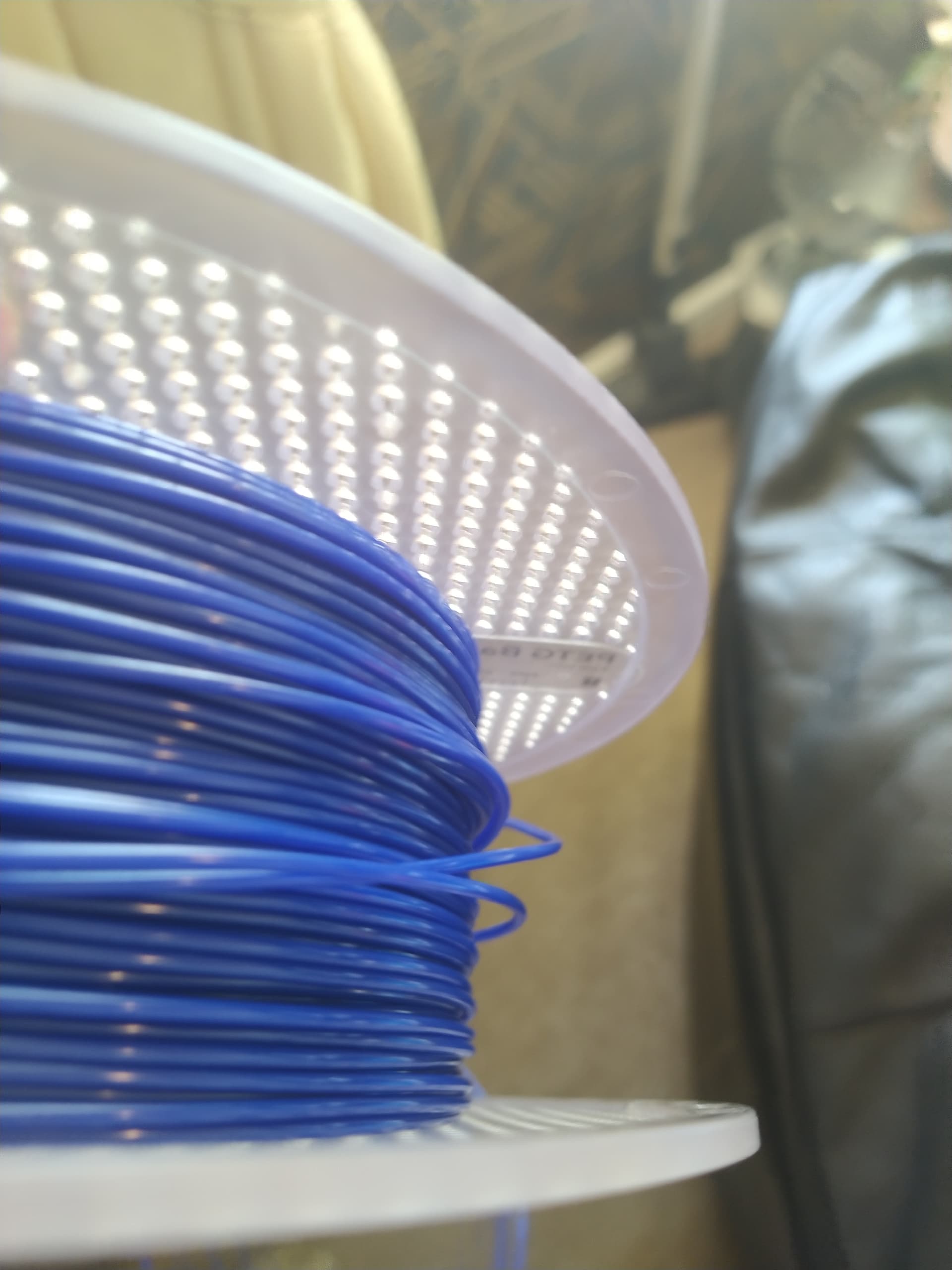

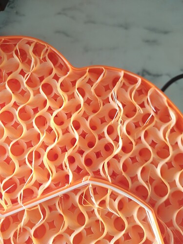

I had a similar looking issue not long ago (not as bad) it was being caused by filament snagging on the spool , (usually from having a underwrap) so it wasnt getting laid and adhering correctly,
As if to prove my own point i had this happen today
