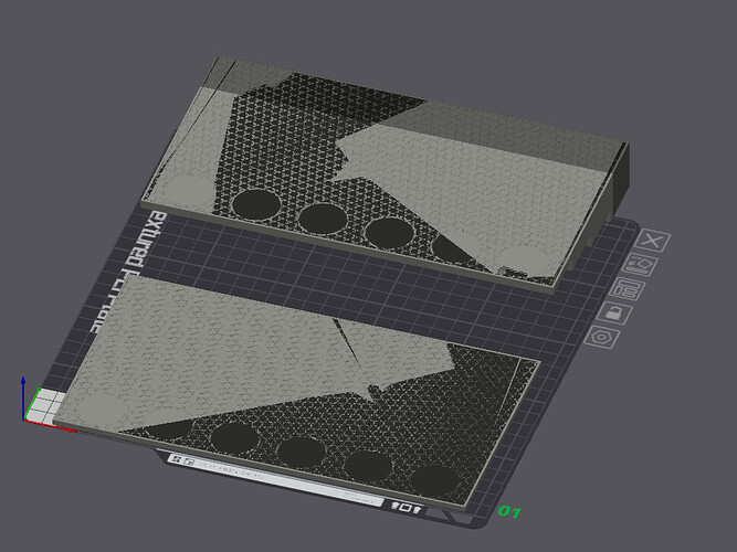

My Nephew built this stl file for me, he built in Solidworks…he has a resin 3d printer. He told me I might have to hollow out in my software. I am not sure what that means. When I slice my plate it want to repair the program but it just sits there it’s been hours… Any help on how to fix this file would be great!!
_AuntCarrie_Part_Hollowed (1).3mf (4.8 MB)
Cutting your part in half shows that it has some crazy internal support modeled into it. This is not a file you want or will be able to print.
Have your nephew send you the solid (without internal support) STEP file for your part and use that.
