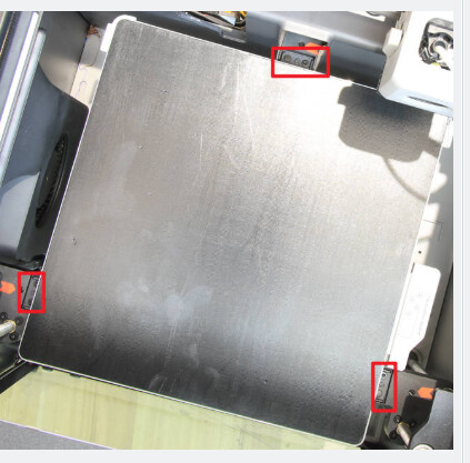

To be sure I had the plate installed correctly, I would remove the plate and confirm that the nozzle is also not moving parallel to the edges of the bed. The bed is held with six screws, they can be loosened and the bed rotated a small amount.
If the misalignment is too great to fix this way, I would be contacting Bambu support for a possible replacement.

Following indications of Ikraus my machine has only one screw accessible at each of the supports it would be great to have adetalled procedure I am not sure , I can solve the problem myself…

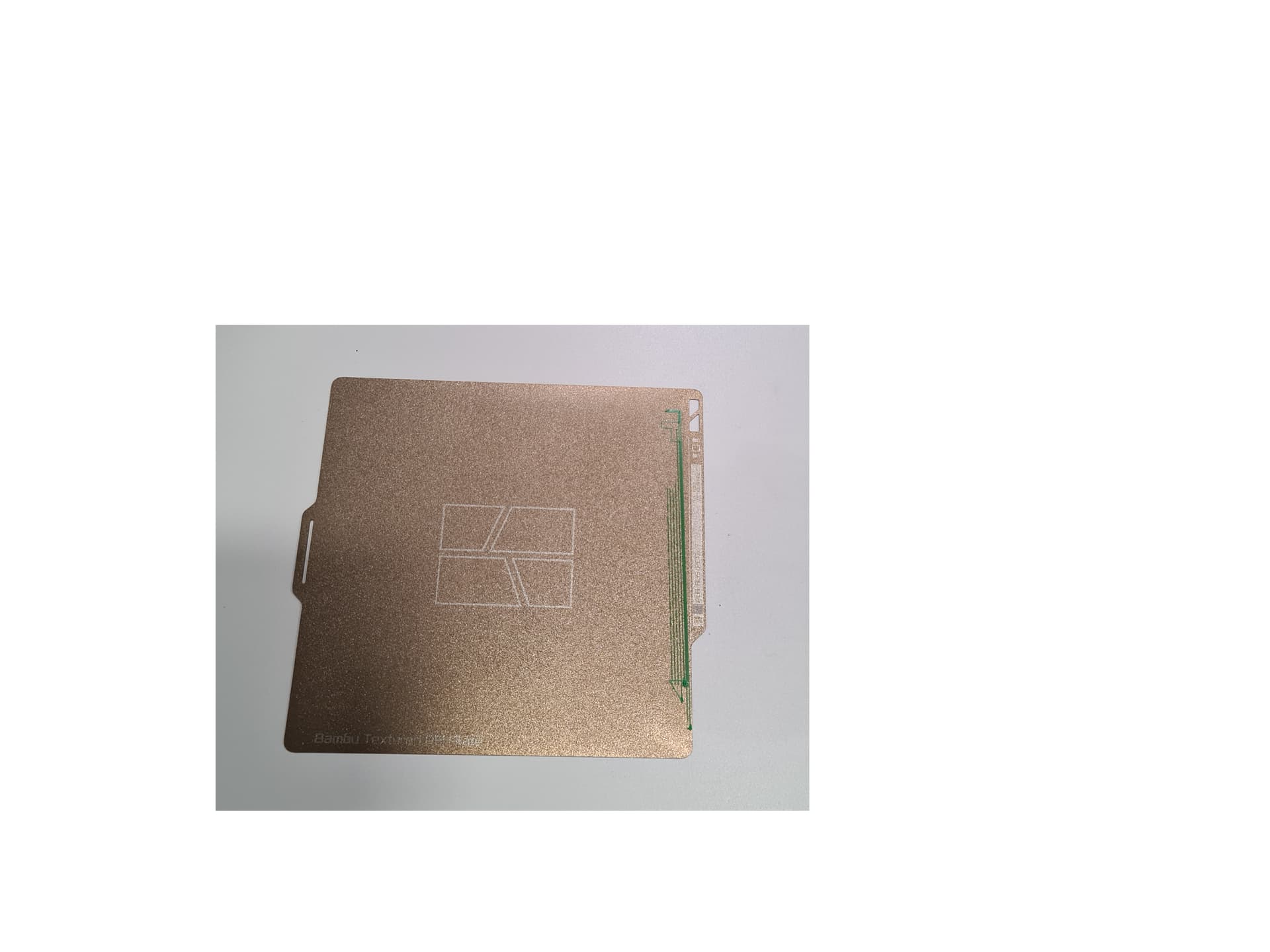

Can you post a picture of the build plate on the printer?

My A1’s are also similar in that they are mildly out of true if you try to run a full 256x256 plate, but only by very small amounts in both rotational angle and absolute position. Some amount is normal - these are mechanical machines. Yours is too skewed to be normal IMO.
What Ikraus stated has the possibility to correct the issue, if your bed has enough room to rotate.
If the bed correction Ikraus highlighted is not able to get it right, you should definitely be choosing to pursue a refund/replacement.
Is there any chance the build plate is machined incorrectly?
No, I think it is corectly machined but for some reason has moved from it’s original position .
