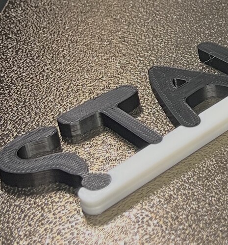

Firmware version 01.01.01 for the P2S was recently released. Since then, I’ve been having problems with filament flow. It only affects BambuLab’s own filaments. Generic filaments seem to be fine. Attached is an example printed with Bambu PETG HF using a 0.4 HF nozzle. The nozzle and filament path are both correct. Before the firmware update, it worked perfectly. Does anyone have any idea what might be going wrong? And yes, i had made a full calibration after the update.

I did open a ticket. Bambu thinks the flow is fine as it is. I should print the Bambu cubes. But they don’t represent reality. The surfaces are so small that the low flow isn’t noticeable. Here’s another truly awful example of a surface:

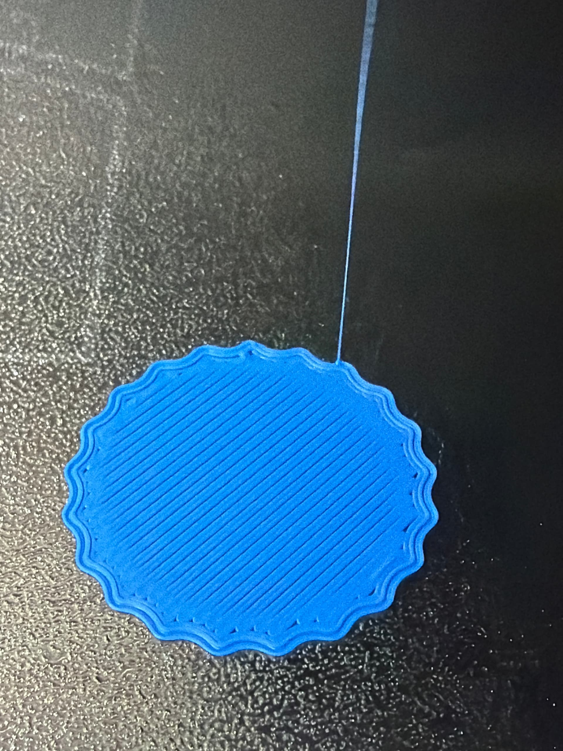

Does anyone have an idea to fix the first-layer issue? I already tried multiple things like line width and slowing down the first layer. Also tried multiple PLA filaments and all had the same issue.
Example (i stopped after the first layer):

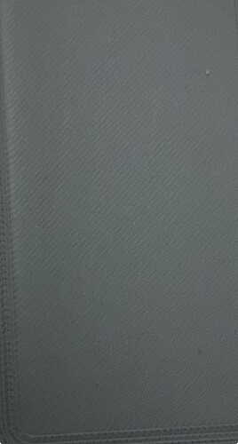

Here before update (Bambu PLa Basic):
Here after update (different Object, Bambu PLA Basic)
Another affected user here, especially in top layers. For the first layer, modifying the G-code with G29.1 Z{0.00} (for the Textured PEI Plate) practically solves the problem (at least for me), but top layers it makes no sense, in specific areas of a piece I find under-extrusion, does not seem to be a flow issue, because you can have some areas that are clearly over-extruded, while other areas still show this problem. So I understand that there must be some underlying issue that Bambu hopefully will address because I can see many people complaning about this here and other comunities as Reddit.
I’ve enabled the developer settings and set Quality > Advanced > Initial layer flow ratio to 1.05, much better first layer for me.
In my case, I have absolutely no problem with the first layer. It’s only with the top layer, and only with BambuLab’s own filaments. All other generic filaments are fine. Yes, I could start experimenting with the system profiles. However, the basic settings from Bambu Studio and the printer should already be correct. I’ve already adjusted the filament system profiles for BambuLab filaments. But that’s not what I want if I’m already using Bambu.

Here old firmware:
Here latest firmware:
