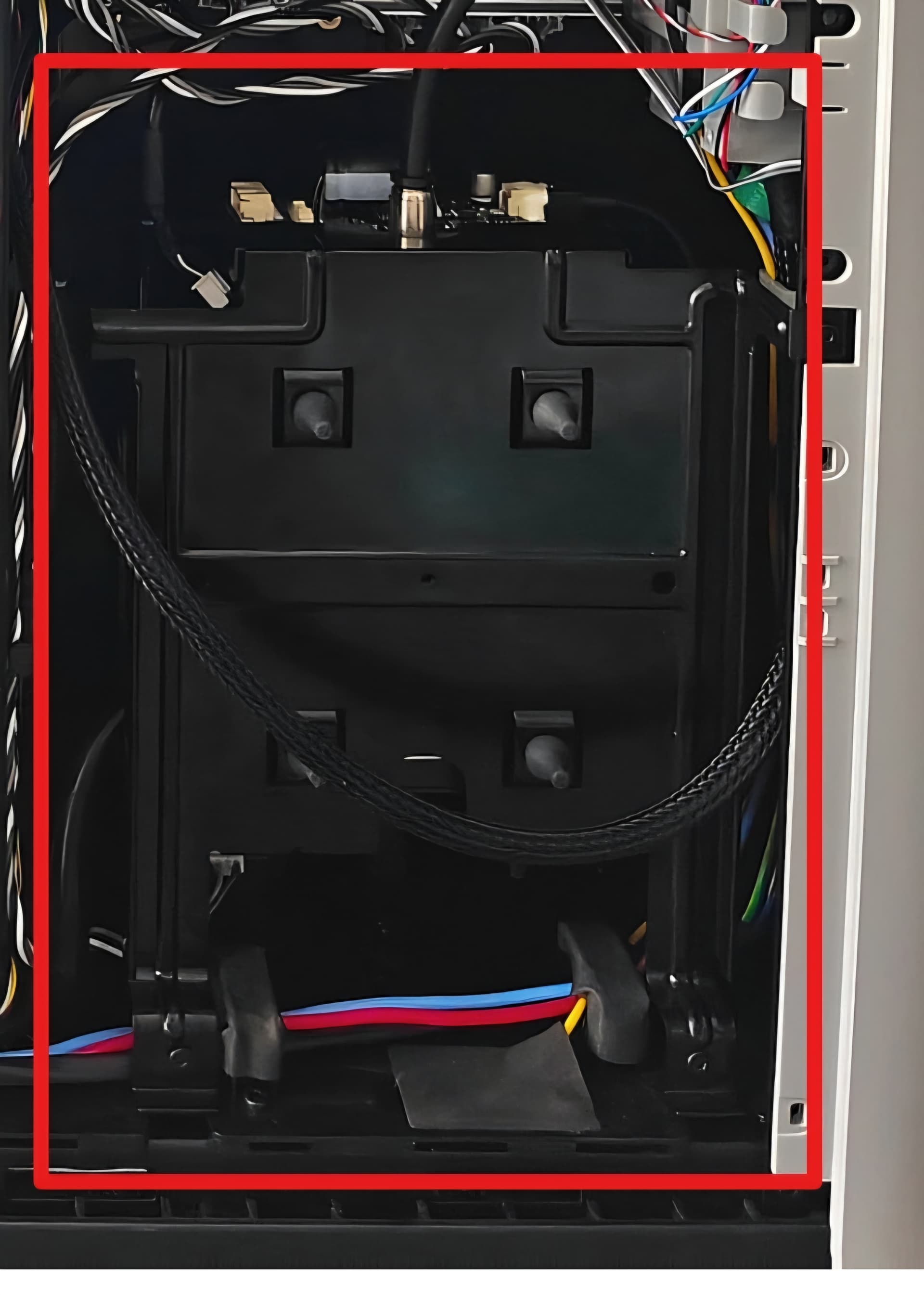

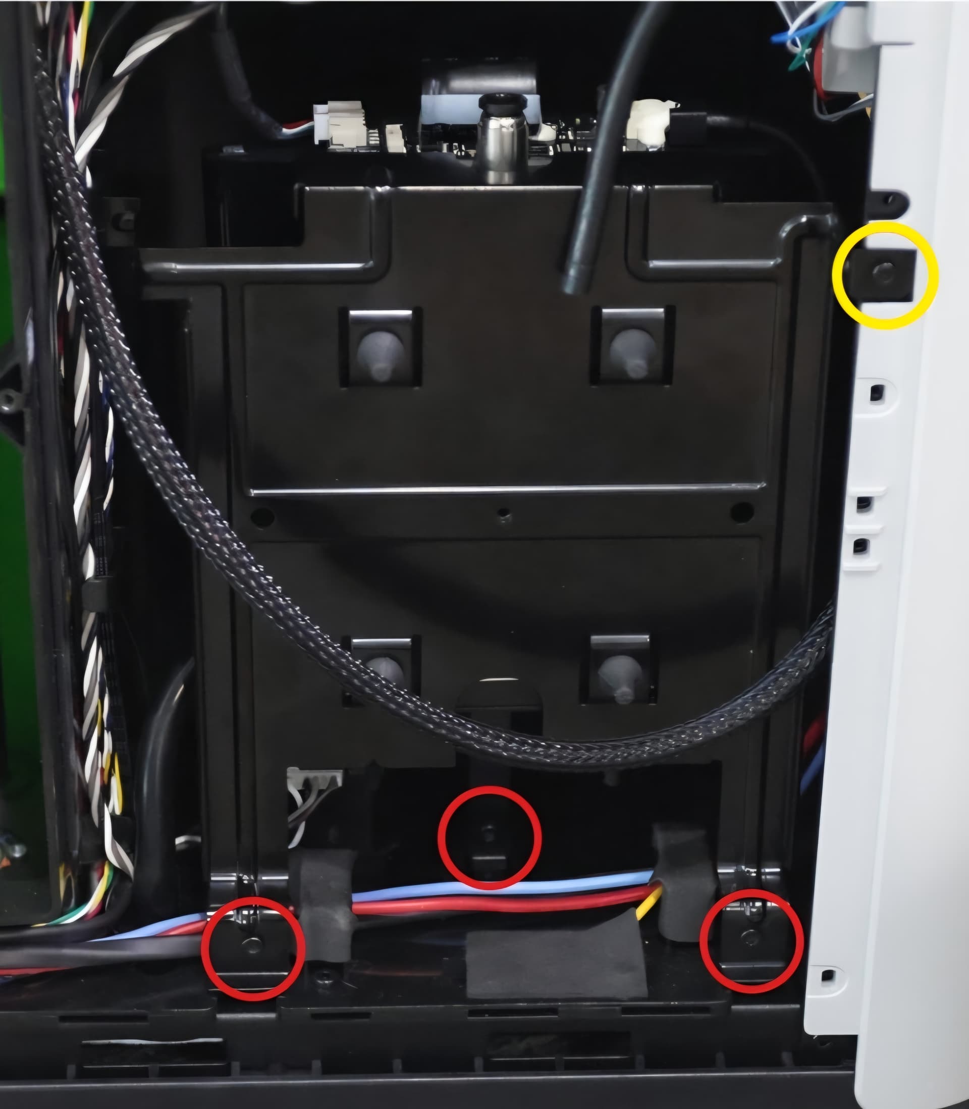

Is there any chance someone has a picture of the bracket holding the internal air pump in the printer? I recently purchased the upgrade kit and have limited space. It’d be fantastic to install it internally.
I know I have to make a cable for it, so that’s not a big deal. What I want is the bracket, as close to stock as possible, to mount it. There is a file on MW but it’s overly complicated. I don’t expect that a whole top and bottom bracket with springs to be necessary. Just want the bracket or mounts that are seen in the replacement wiki page.

From pictures it looks like a metal bracket that just mounts each side to the main frame. Probably $5 in total but I’m betting they won’t let it go without purchasing the whole pump.

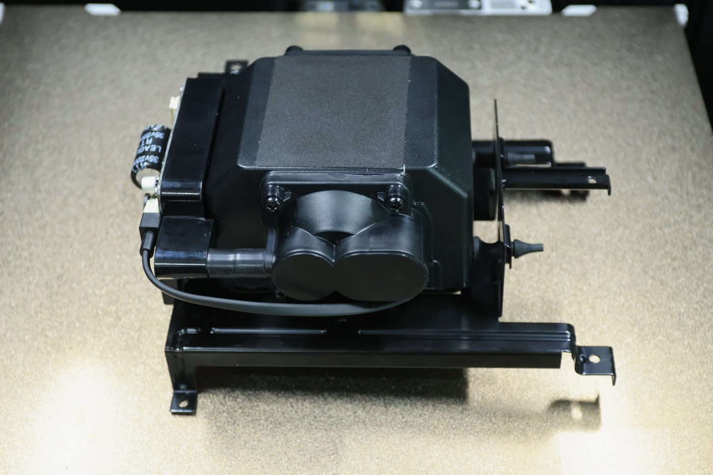

For what it’s worth, I replaced my upgrade kit’s external air pump with an internal one. I ordered one from a third party - if you google Bambu internal air assist pump you should be able to see some of the vendors. The pump came with the additional required items like the tubing to ensure the length is correct as well as the screws. Installing isn’t too bad! The most annoying parts are removing all the rear panel screws as well as fishing the hose to the top where the air hose output is between the buffers. A little trick I did was I used a non brittle piece of filament and was able to fish it through in the same direction. I then heavily taped the hose to it and pulled it back through. All those years of running cabling in the past paid off! Just make sure you’re careful when you remove the part at the top as there are delicate wires fastened to it and you don’t have much wiggle room without taking a bunch of other parts of the printer apart.
Anyways, back to your original question! There are a couple of models on MakerWorld that do what you are asking. I actually printed one, but changed my mind when I saw I could get an official one. It’s definitely doable, and if you google the factory internal one, you should have some good images for reference if you want to make edits or just use it as a guide for installing. I could have sworn I took pictures of before and after. If I find them, I’ll edit my post.

From the wiki, if anybody else needs it
That top pic is the best. Shows one of the brackets clearly. Not much to it. If I have the energy later I may take the pump out and attempt to recreate. I would think ABS or ASA to be strong enough for it.
The only down side is we’d have to remove it to change the filter. I can live with that.
